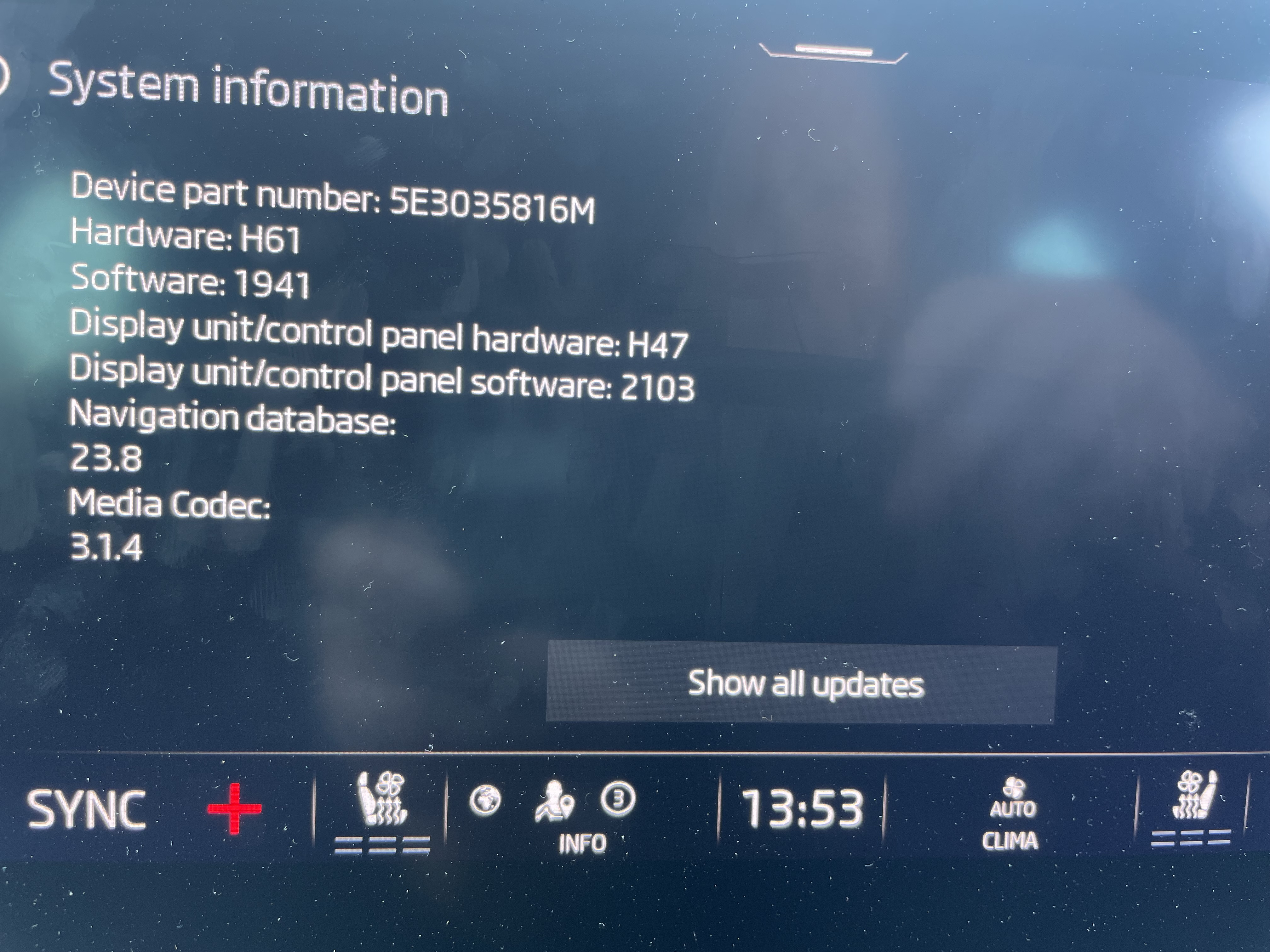

Just got the car back from the shop. Now im on 1941sw. Hope everything will go well now. First drive of 16km went without a problem.
I'm in the same case since yesterday.
Upgraded from 1900 to 1941 by my reseller  at Toulouse in France.
Everything seams good after 30km.

Mine was updated to 1941 from 1900 at my dealer today, took about 40 minutes.
