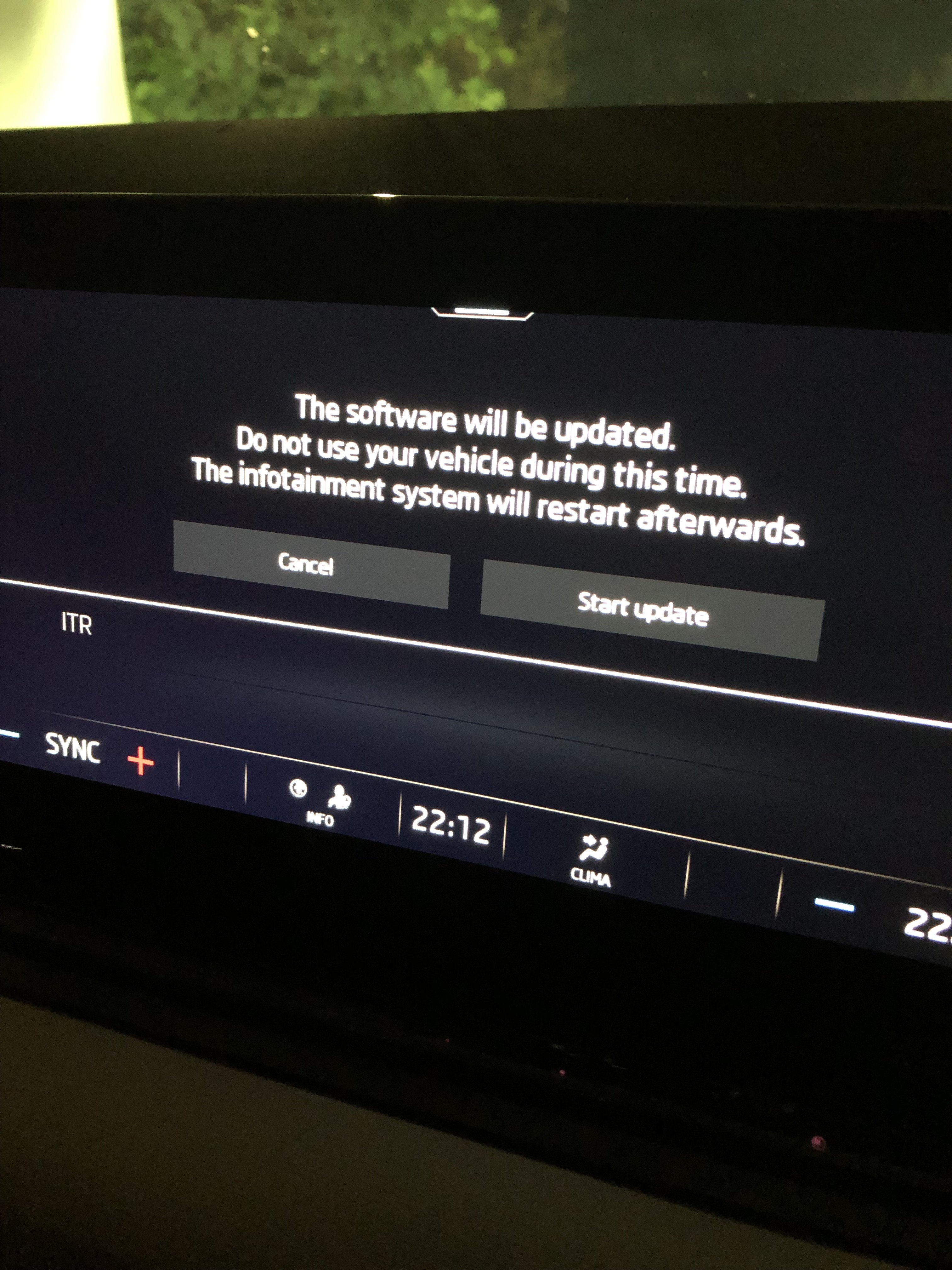

  • I had so many spontaneous reboots this week with even 4 occurring on the same day that the infotainment system was practically unusable. That’s why I decided to go ahead and install 1941 yesterday.

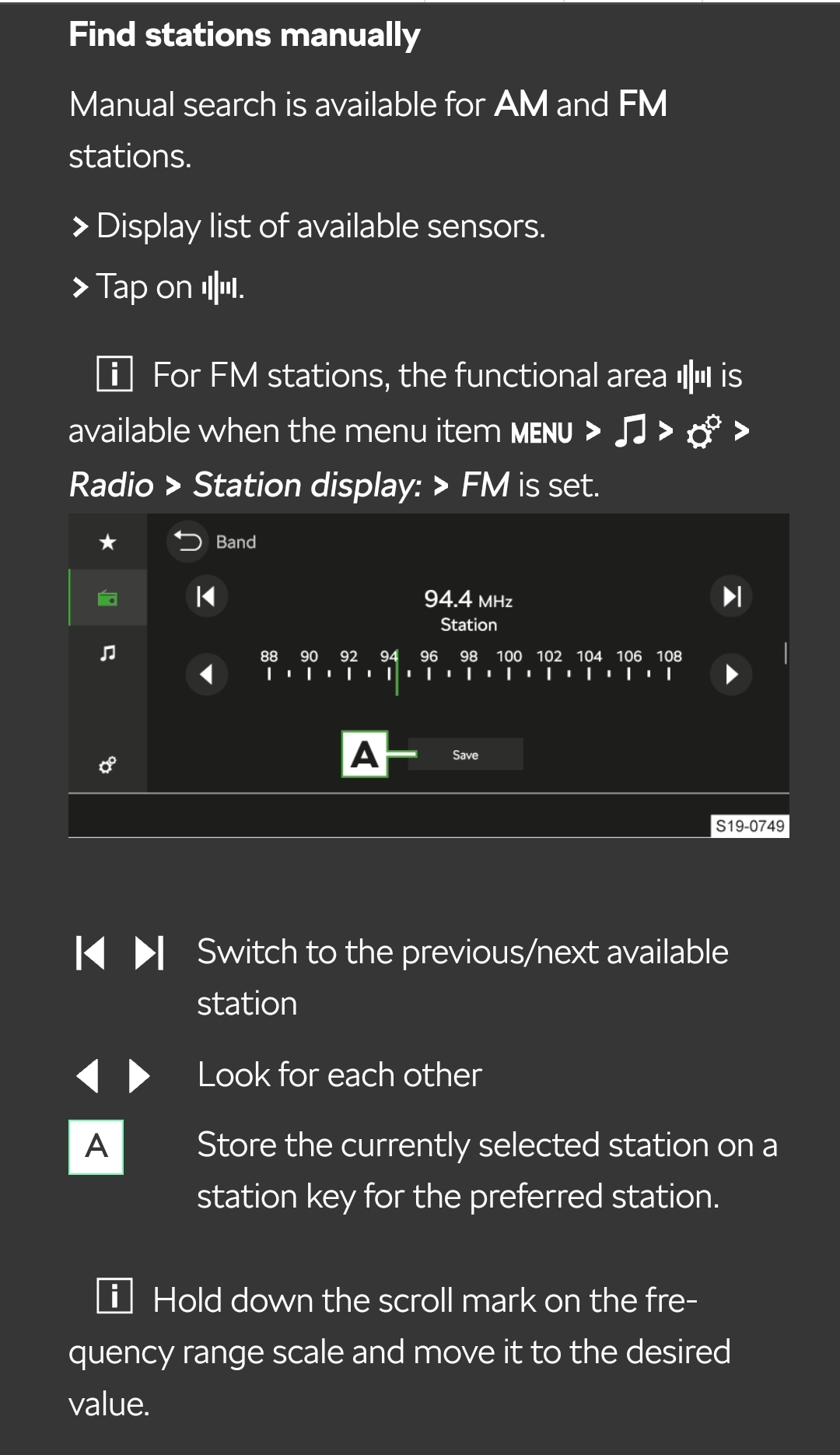

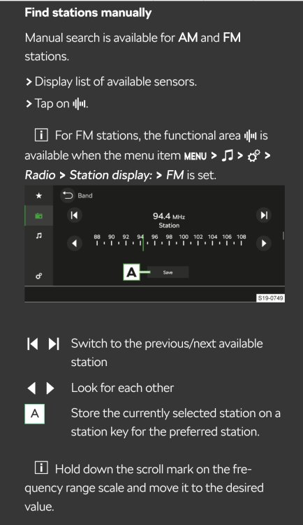

Is there a way to tune a radio station manually? It's very annoying that I can't find specific stations...
Question belongs in a different topic, but here you go:
Screenshot_2023-08-23-17-18-25-871_com.android.chrome-edit.thumb.jpg.598c380619bf9f643eef82888213430a.jpg

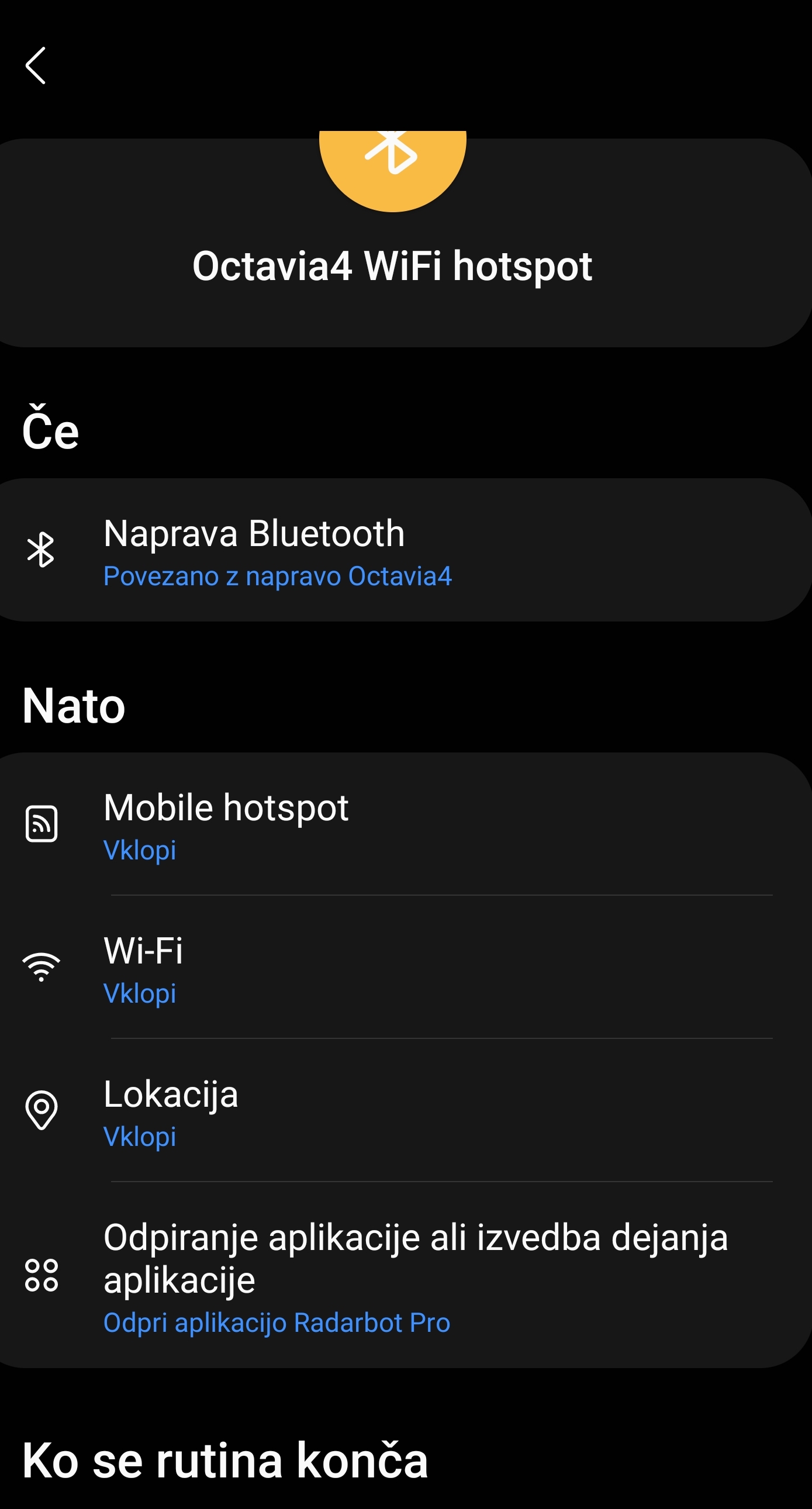

Regarding poor mobile signal.. using Samsung routine and when phone connects to car bluetooth phone make hotspot for car which then auto connect to it and have internet.. so updates can be downloaded only when I'm in car and driving..
PS. This way you do not need to pay for mobile data for car..

Just got the car back from the shop. Now im on 1941sw. Hope everything will go well now. First drive of 16km went without a problem.
Am on SW 1941 and had the infotainment reboot the other day first one since I done it 2 months ago

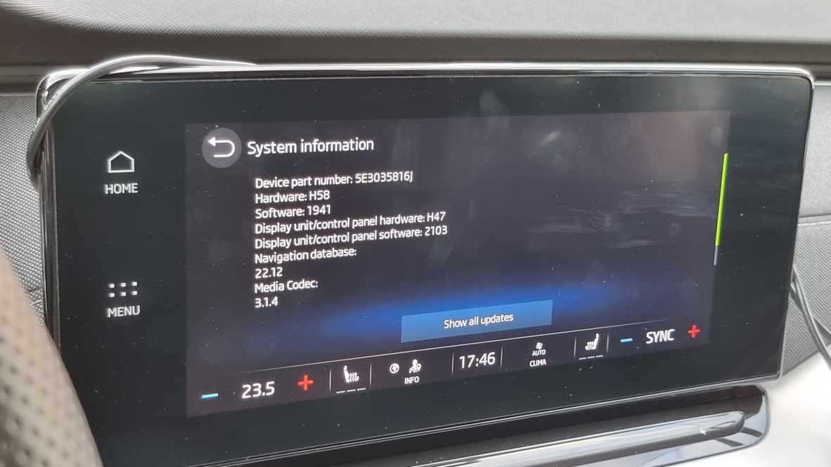

If you want to see what is already installed on your car you have to go to:
Menu => Settings => System Information
It's there you can see the SW version, display SW version and the Navigation Database (how old your maps are...) - see picture
