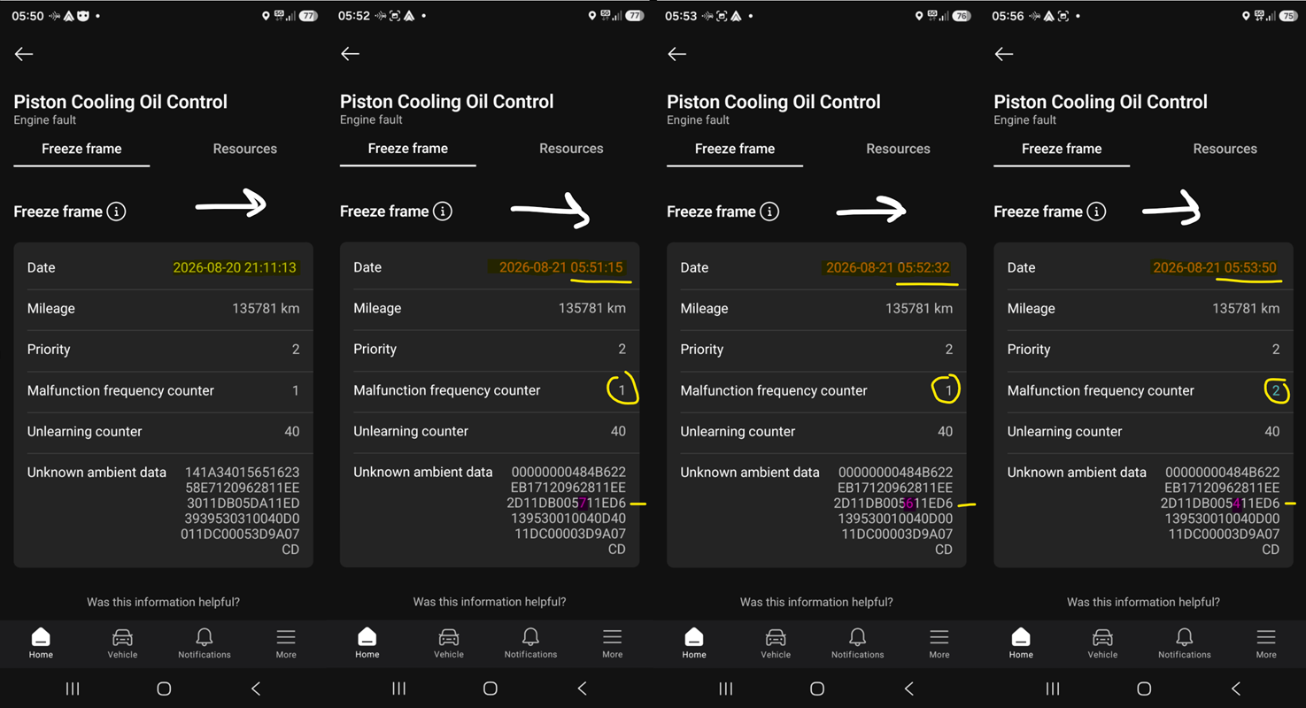

P25AB00 Piston Cooling Oil Control Circuit High - Superb
@Breezy_Pete thank you for your effort! This morning, I ran a scan on a cold engine and got the usual cold-start behavior, and refused to clear: Immediate rescan: I cleared the code (P25AB00) on cold ignition. OBDeleven automatically rescanned the ECU a second later and caught the code again immediately. Checking the Freeze Frame data, I noticed a new timestamp and slightly changed parameters. I retried clearing it twice, and after each clear, a new timestamp and slightly changed parameters appeared. The 60-second delay: After failing twice, I turned the ignition OFF, waited a full 60 seconds, and turned the ignition back ON. Upon scanning, the frequency counter had increased to 2. I cleared the code, and this time it stayed gone! I then drove to work with no faults at all, and the Start-Stop system worked perfectly the entire way. A fresh scan upon arrival at work showed zero faults. I also checked the fuse box in the engine bay ā I pulled out and reseated all fuses and relays to ensure good contact. All pins and terminals look completely spotless with zero visible signs of corrosion or oxidation.
