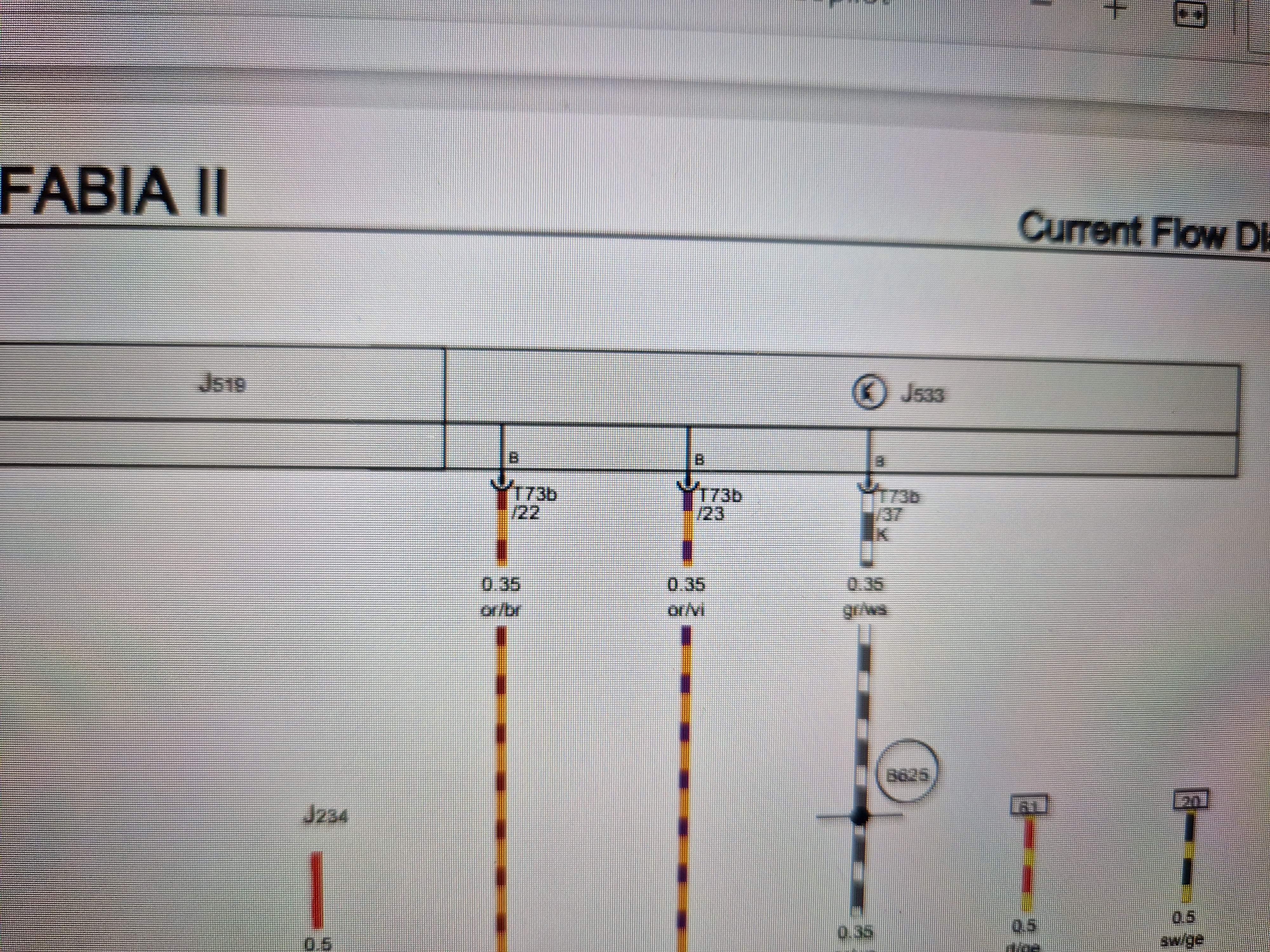

  7. Might be the actual front left (nearside) sensor, or possibly a broken wire or corroded connection in the loom plug, Worth checking wiring near connector, and visual impression of connector contacts before spending on a replacement sensor, if poss. The ABS code I would be suspicious of relating to the blade fuse that the thinner red/green wire is going to (25Amp one?) or damage to that wire between there and ABS module. Unplugging connector from ABS module, and measuring voltage at the relevant connection would be ideal. Will give pin number later.

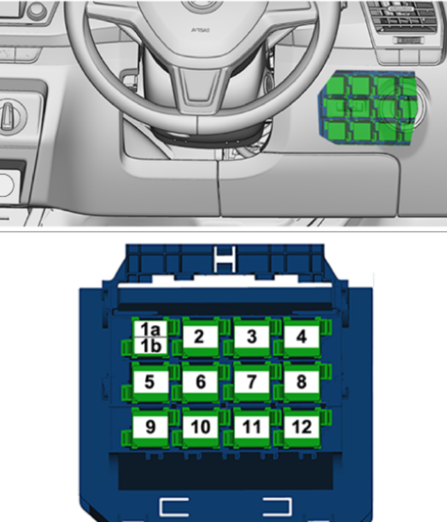

  14. I can't promise to fix everything, but I bet we could understand what needs doing pretty quickly. Might be as simple as a bad connection between alternator and battery. Or the engine earth connection being a bit corroded. Do you have a multimeter? Or know someone that could lend you one? Could maybe do some measurements that would tell a story.
  15. Bring it over to me in Oxfordshire some time.
  16. Yes, that second one is 110A, which covers the while interior and its fusebox. Power steering one next to it in position 3 should be 50A, then the last ones with the dodgy fuses should both be 40A. I would leave the one for the fans (thinner red/black wire) as-is, but change the right-most one with the red/green wire for a 'legit' 40A one. That's the ABS pump fuse. Clean contact surfaces before fitting new fuses, ideally.
  17. Yes, the fusebox on the end of the dashboard. Good, the battery light should come on and then go off as the engine starts. There's a common wiring fault, especially on the diesels where there's more vibration, that results in charging problems due to the alternator excitation wire breaking. If the battery light comes on, it's fine.
  18. Fuse 25 in the cabin fuseholder is the other one. Fingers crossed that it's all just down to the battery. Is it a diesel or petrol engine? Does the battery symbol light up when you switch ignition on, before starting to turn the engine over?
