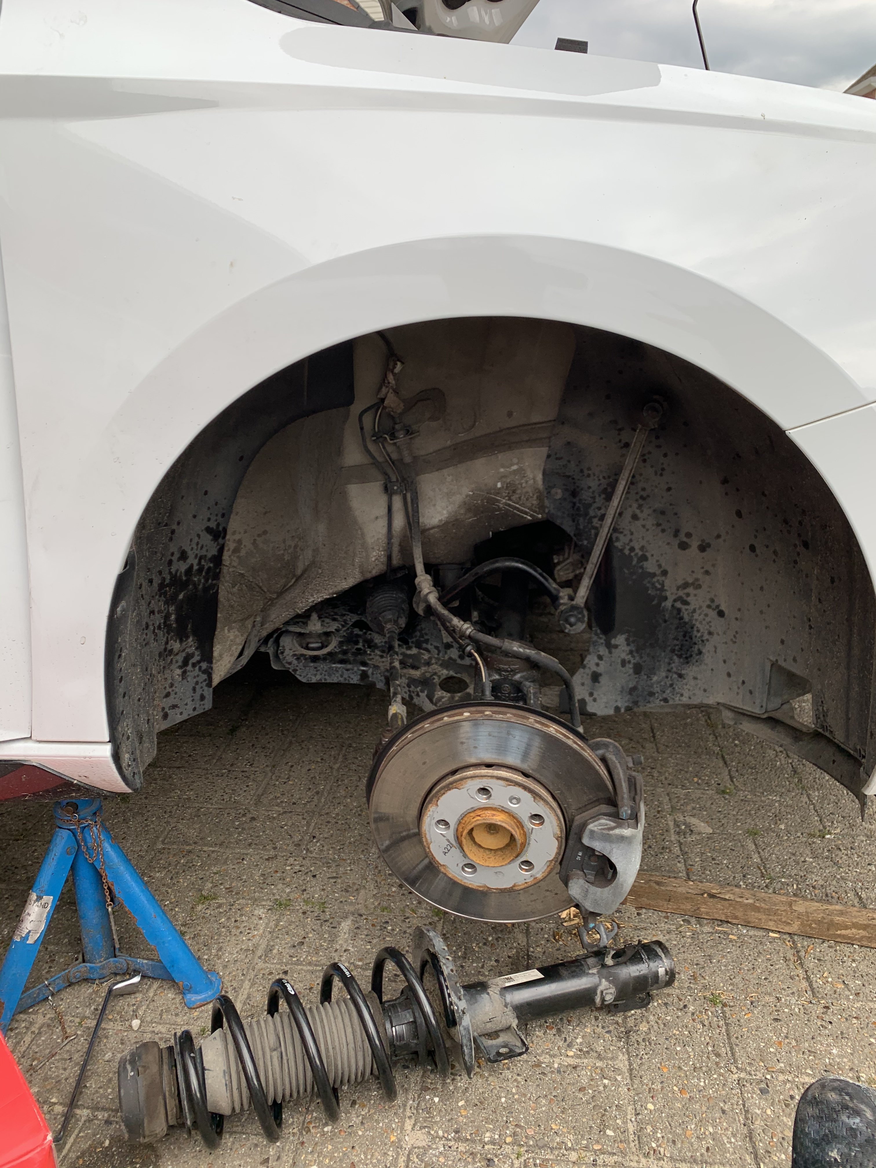

59 minutes ago, Jeremy_Peeters said:
I need urgent help4B724E7D-2610-4D52-B71E-1571ABD5B0DF.thumb.jpeg.5bd92ba474a9c8ff6f9a5ec569dd1cf2.jpegi can’t get the right side strut out of the knuckle, I’ve been trying for that past 2 hours and it just won’t come out. Any help is greatly appreciated
Gently tap a big flat blade screwdriver or pry-bar between the two halves of the clamp (where the big bolt came out from).
Then tap down on the knuckle (probably from behind), or up on the shock from underneath if you can reach that way.
Edit: Some penetrating oil (wd-40 or gt-85) in the knuckle will get you a long way too.
Then down on the knuckle (probably from behind), or up on the shock from underneath if you can reach that way.
Well I got it out DA18A6AE-68A3-4103-B3F9-BC1352697283.thumb.jpeg.c0fed4429cb5cad802217fe8c956379d.jpegnow I can’t get it back in, the shock is like 2-3 cm too long
Can't get it back in with the Eibach spring?
Well it came out the same length, so it's gonna go back in, somehow.
Try using the spring compressors to take a little length off it. You might have to rearrange the spring a bit once it's in the knuckle though to ensure its properly seated
I used a piece of wood to support the shock so I could shorten it while knocking the knuckle but I didn’t think about how to get it back in 😬

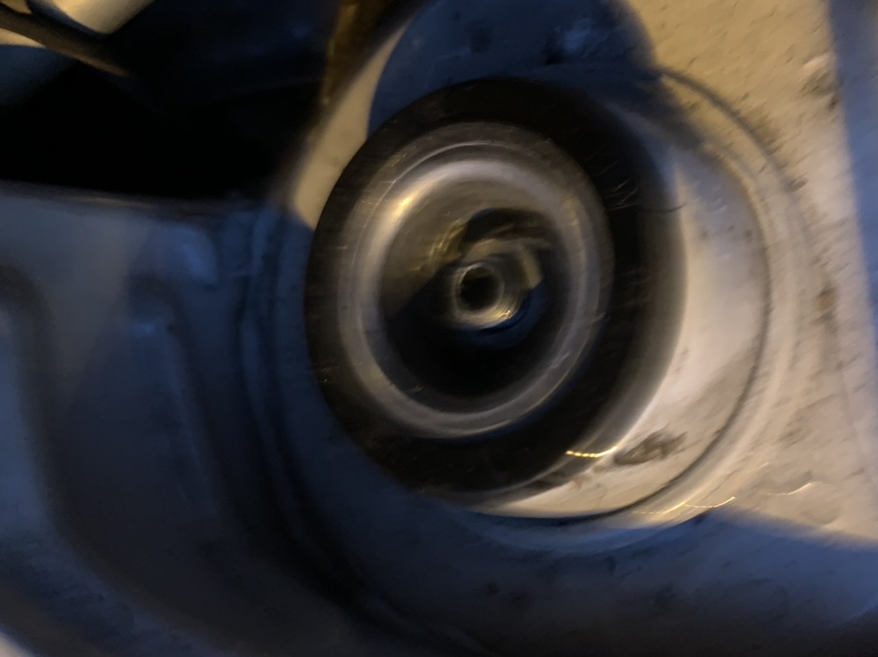

Alright sooooo I’m done with it B7A3B878-32C4-40F9-B00D-95BCCF6B03E9.thumb.jpeg.d80286fdd7ffbeecf60b8bf116f96ffb.jpegLooks good and I really like the slightly harder ride But I have one more question (this is my first time doing anything like this so I’m really paranoid of something going wrong)
is it normal that the strut mount sticks out more on the left side that on the right? Both are tightened to 60nm as said in the repair manual, and I triple checked everything so I have no idea if it’s normal. Seems strange but maybe that’s just my paranoia
left side:A769F005-F950-477F-A12F-FE44DDAB539F.thumb.jpeg.59566c8f4cc08919921bf1cc85b5e23b.jpeg
right side (was already covered up, sorry) :79D0B011-2968-4EDB-A534-C7D848F85798.thumb.jpeg.05b898923e79b2fd87ff35cd156aa8f4.jpeg

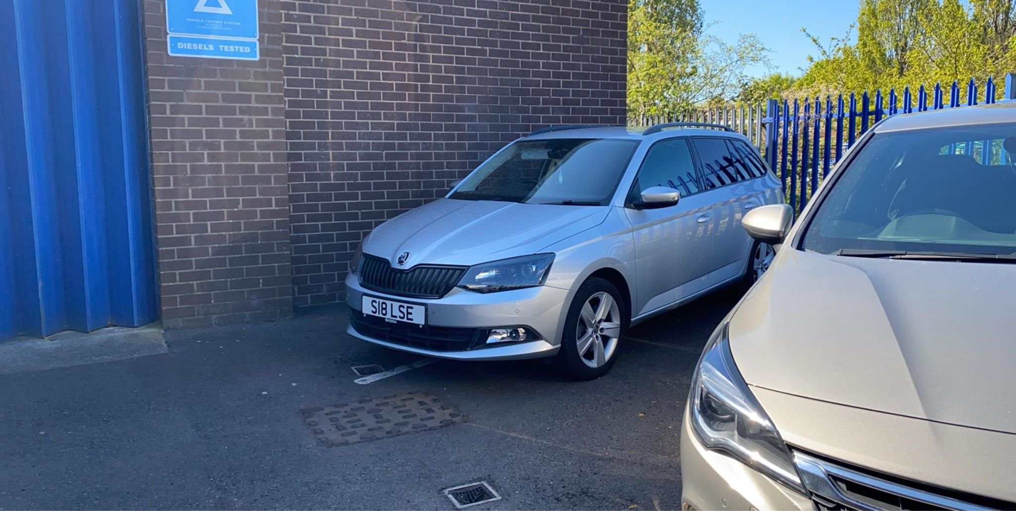

Hey guys, new here but browsed for around a year since I had my first estate. On my second one now which is a 1.2TSI 110bhp, wondering if anyone has an idea on if 1.4TSI coil packs are any improvement paired with better sparks? I dont know much of the similarities between the 1.2 and 1.4 apart from some of the turbo units in the 1.4, which I'm looking at doing at some point.
Thanks in advance
PFA: my SE L
Thanks in advance
PFA: my SE L

Thanks for the info! Im looking to get around 180-190bhp out of it. Ill be going for 1.4tsi turbo sent off to make it hybrid, custom exhaust, ive already got the forge intake and then see what else i can get from there. Ive also heard the HPFP and injectors from the newer 1.5tsi fit too, can you confirm? Thanks again

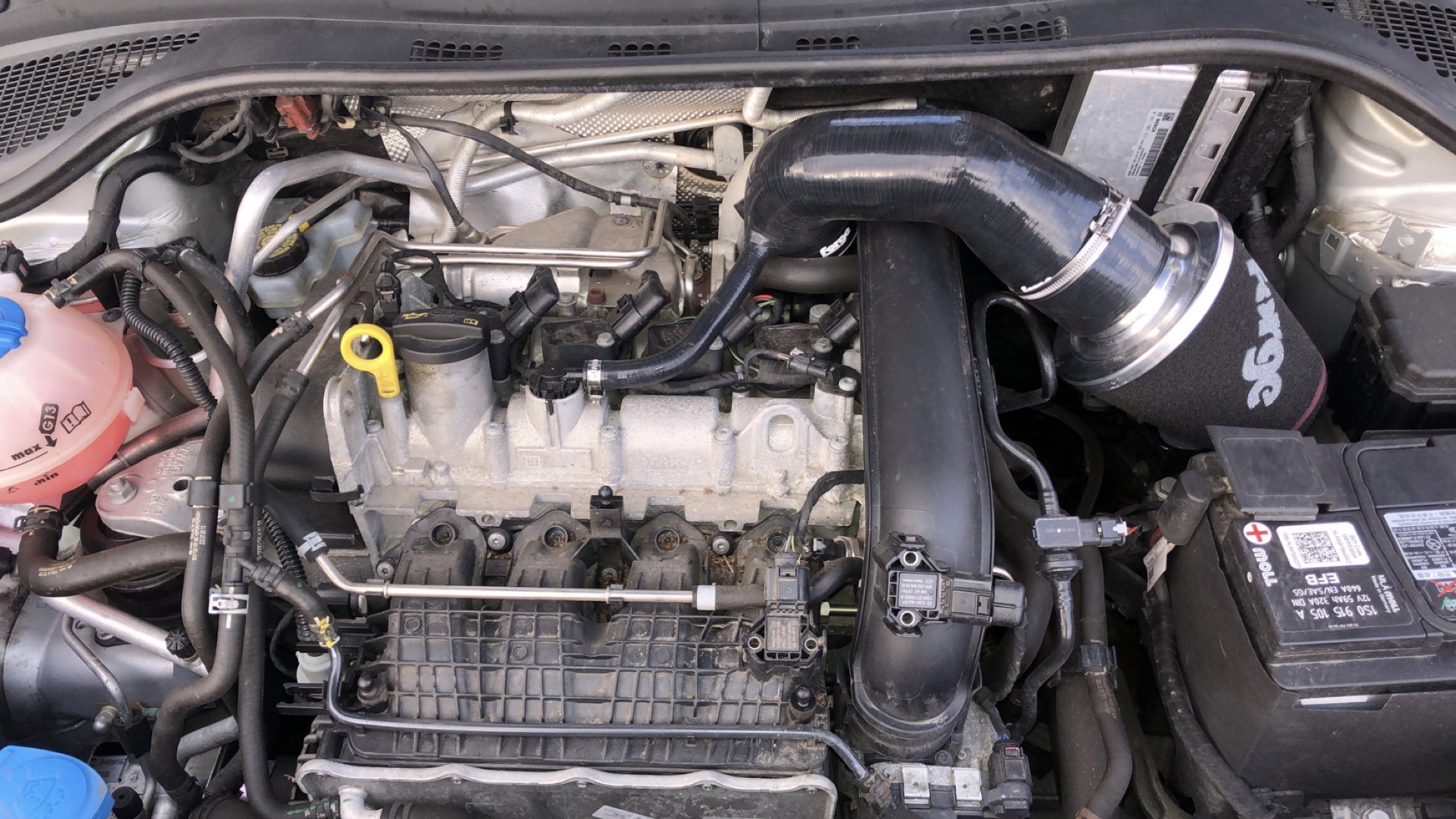

I have the new turbo on but after about 1 min of driving the EPC light came on. Almost feels like a boost leak but I've checked all the pipes.

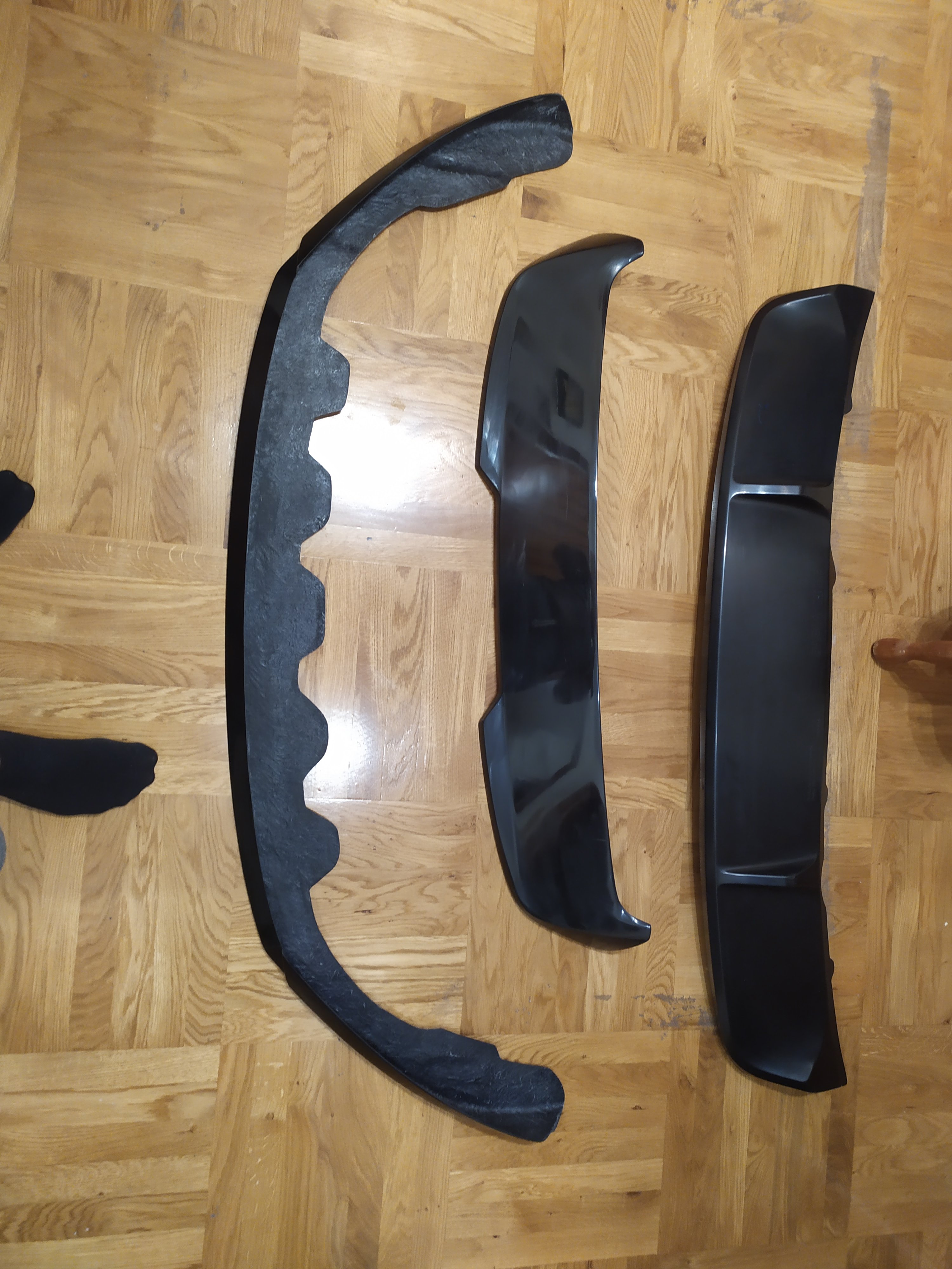

Hi guys,
can someone who retrofitted MC front lip or rear diffuser share close up images of the fitment. I just got delivered some MC parts, but i think that front lip will stick out in the middle if it sits right on the sides and vice versa.. Some images would help a lot!!
THANKS!
something a miss there, the left side looks correct you have an issue with the right side though

Hi,
Can you post pictures of the intake please?

Filmed this just now. havent touched the car since last night. defiantly no boost leak. it flew through 1st, then epc and engine light came on and no boost
https://drive.google.com/file/d/1LVWi61b2OmvzIpJvK2QRpXN0tJwhCDV3/view?usp=sharing
That is boosting hard! I'm about to go out for my bi-weekly shop and drive, i'll disconnect the wastegate connection and see if it behaves similarly (i suspect then it'd probably limp mode the moment i start it though). I'll film it too.
It sounds like it's overboosting (that surge of hiss as the rpms suddenly pick up real fast) considerably as it pulls to higher revs, possibly wastegate not opening, or the ECU wondering why tf the turbo is flowing so much more all of a sudden.
What happens if you drive gently until you get into 2nd and boot it while at ~2k rpm? If it's overboosting it'll pull really hard for a moment and then probably kick to limp mode.
Out of curiosity, did you replace all the gaskets and stuff? And are you sure the wastegate connection is properly connected?
