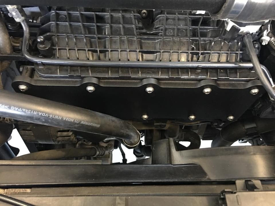

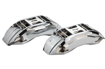

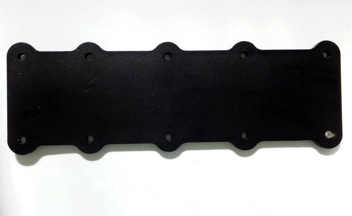

So i had a few talks and heres the deal, New intercooler and new hoses, they are going to block the manifold watercooler with a plate, all legit and proven that is safe (i have a photo for that, it's not mine to own it).
New turbo from the 1.4 and they are going to make it hybrid with a few bits and pieces (solid work and the engine 1.2L can make up to 270bhp if you are crazy, im looking around 200bhp for the track)
New downpipe and we can talk about resonate, i use it as a daily some times (track car life) new brakes from PB brakes and the color is amazing (i have a photo for that, it's not mine to own it) also i have todays video testing alghout it's raining and we tested the old suspension just to have a feel for it (blu power coilover very cheap 250 something like that but they are not great they are chinese).

I see, the water-cooled intercooler is a core which fits into that manifold from the front, so long as it's getting cooled from something (front mount i'd assume) then there shouldn't be any issue. The watercooled one is fine for up to 200 though, even more than that if were to seperate its coolant from the rest of the system.
I know a few guys with big-block LS chevies which have watercooled intercoolers between the turbo/supercharger and intake manifold. They generally make for cleaner installs as they often put the radiator for that somewhere under the rear bumper with coolant lines running behind heatshielding in the centre tunnel. Those things with big enough turbos kick out 1500bhp.
Front mount intercooler adds more space that the turbo has to fill before it builds boost, increasing lag.
Going beyond the hybrid turbo and beyond the 200 mark generally needs a bigger turbo still, that sacrifices much of the low-end torque in return for high-end power, and the lag increases somewhat too, combined with a front mount intercooler, you'll probably be nearing the rev limiter before boost decides to arrive.

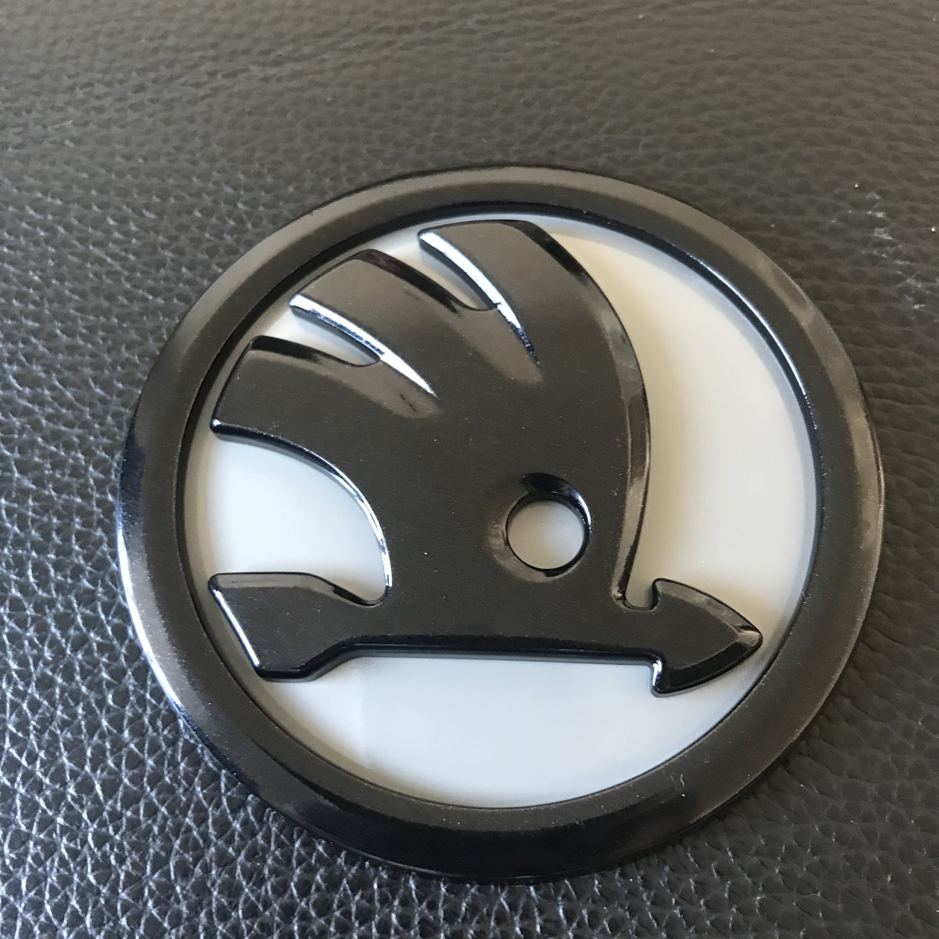

Finished my first attempt at creating a 2 colour badge. I ordered a used front badge off eBay which had no adhesive pad on the back. Carefully I unclipped the chrome parts from the backing, which is difficult because the clips are brittle.
Once dismantled all parts were sanded with 800 grit paper. The chrome is tough and only just managed to dull it sanding.
The chrome parts were then acid etch primed, painted with 3 coats of black magic and 3 coats of lacquer.
The centre was plastic primed and painted with 3 coats of meteor grey and 3 coats of lacquer. Once dry the badge was re assembled. Just need to add trim tape to back of badge. I have now ordered a used rear badge from eBay.

Wow, that looks pretty damn sweet! Nice job on that

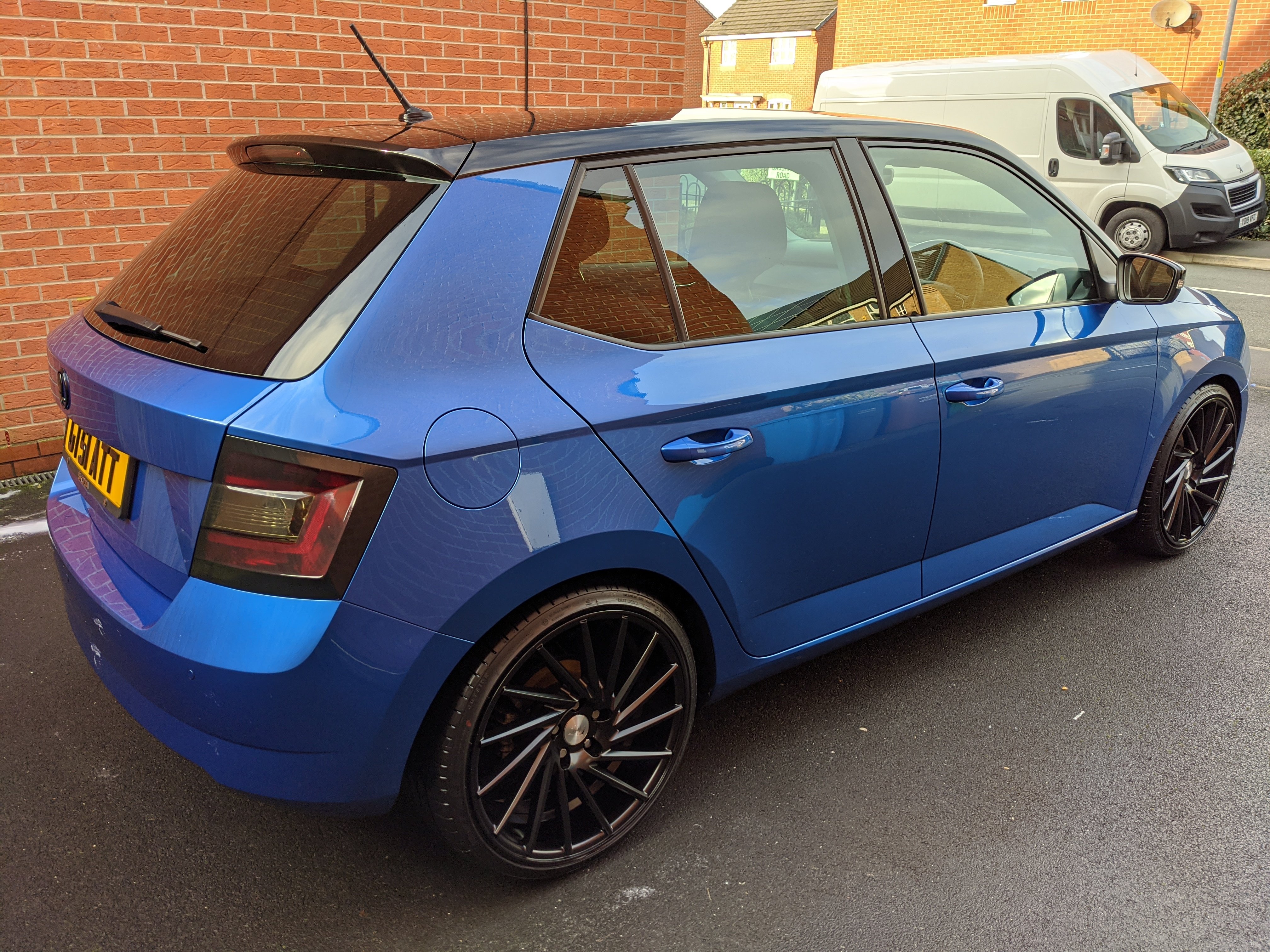

Has anyone tried tinting the rear light clusters?  I tried a few months ago and gave up after a few hours of frustration.  In the end I only tinted the center section of the lights, however the tint has started to come away in the corners.  I have purchased a darker tint to try, but I'm just wondering if anyone else has had a go?

I've had mine done, didn't attempt it myself though.

Really like the tint👍

How much did this cost to have it done by a professional?  Ive spent the day struggling to do a single light.

I think it was around £50
