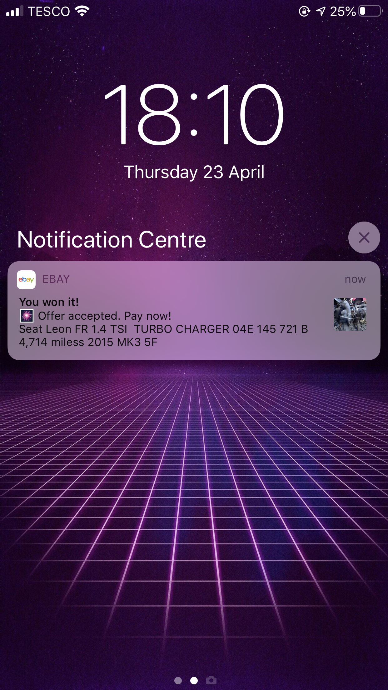

Just sent that seller an offer for the 1.4 turbo, fingers crossed! Not holding my breath though as i offered a little less than what @cm9876 did!

Another £105 spent 🙃

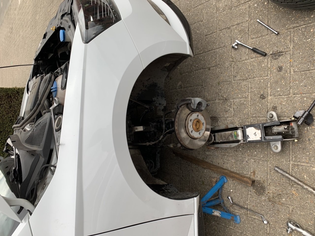

I need urgent help4B724E7D-2610-4D52-B71E-1571ABD5B0DF.thumb.jpeg.5bd92ba474a9c8ff6f9a5ec569dd1cf2.jpegi can’t get the right side strut out of the knuckle, I’ve been trying for that past 2 hours and it just won’t come out. Any help is greatly appreciated
