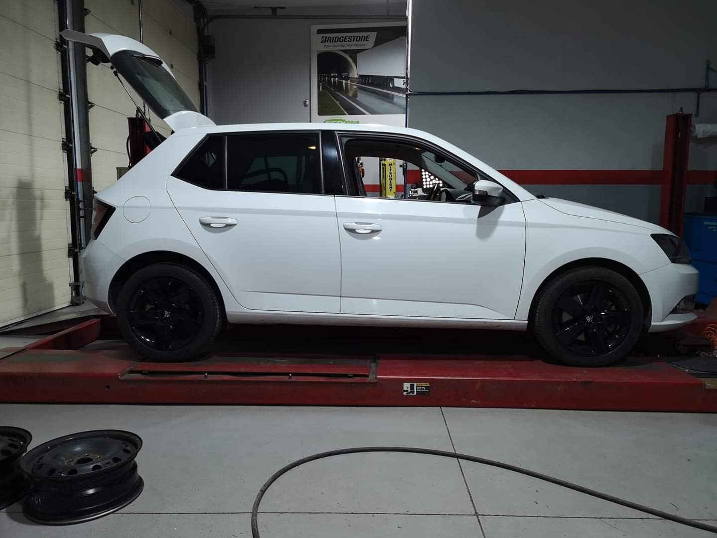

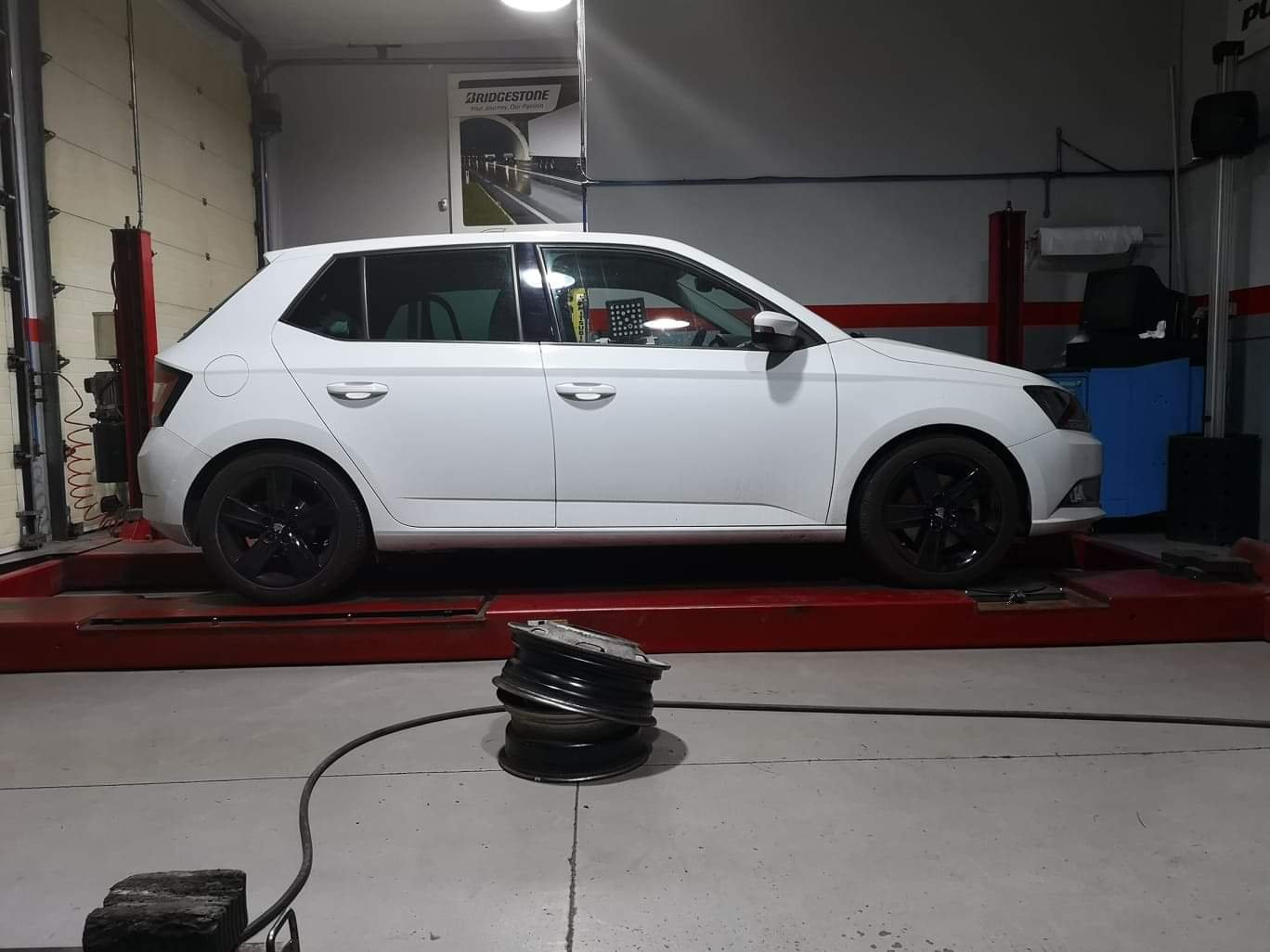

That still looks quite high tbh thought it would be lower?
@Jeremy_Peeters its on 16 inch wheels, with the 17 inch its just 5* ;)
its seems a quite high because i just raised the car to balance the tyres
Heres two photos, before and after
Before:
After:
Before:
After:
Oh my bad haha that does look really good though
