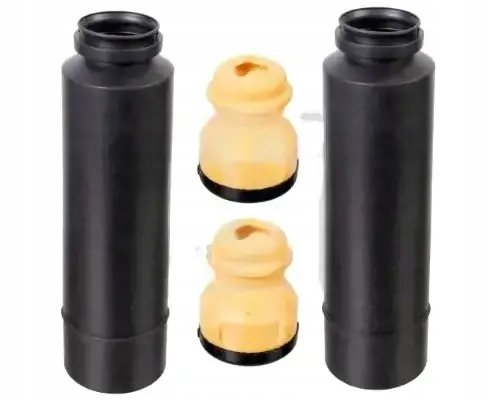

When replacing the rear springs and shocks, should I use the factory bump stops? Won't they be too long for a lowered suspension? Are there any shortened versions of the bump stops for the rear?
From what I've read, the B6 front shocks have built-in internal bump stops. With a thick piston rod, the original bump stops definitely won't fit.
1 hour ago, Woocash82 said:
I have one more question.
You don't need bump stops for the fronts.
You can use bump stops from i believe the Ibiza, they're part number 6Q0512131D, they're what i have on mine and they're perfect.
Thank you.
I found these bump stops using the part number you provided.
The bump stops are from Febi.
I'll order these parts tomorrow morning 🙂

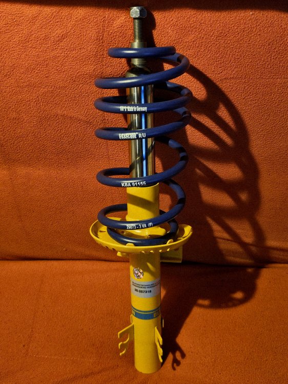

The shock absorbers arrived today.
This is what it looks like with the spring.
I can't wait for everything to be installed.

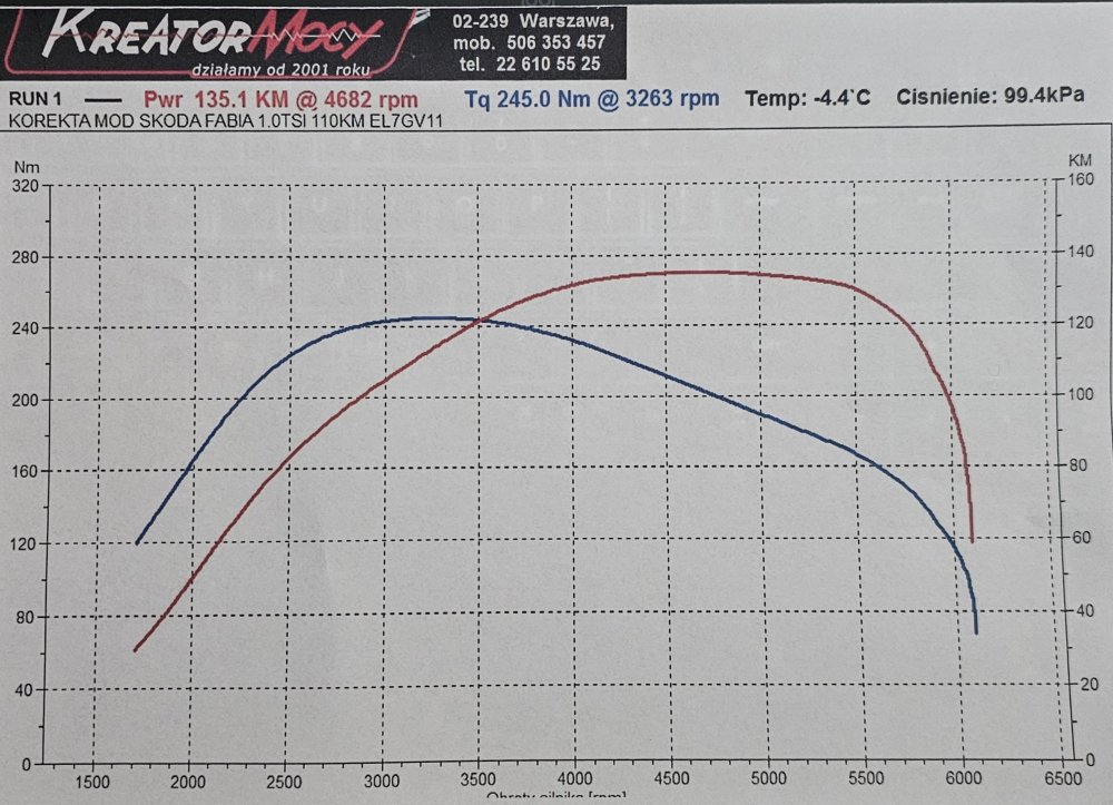

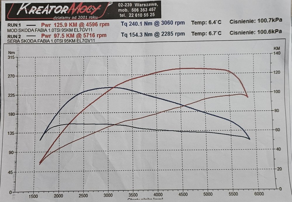

Today I went to the dyno to further improve the engine's performance.
The final result was 135 horsepower and 245 Nm.
Now the Fabia is pleasantly fast.
Below are the dyno graphs.
First attemp
Today's result
