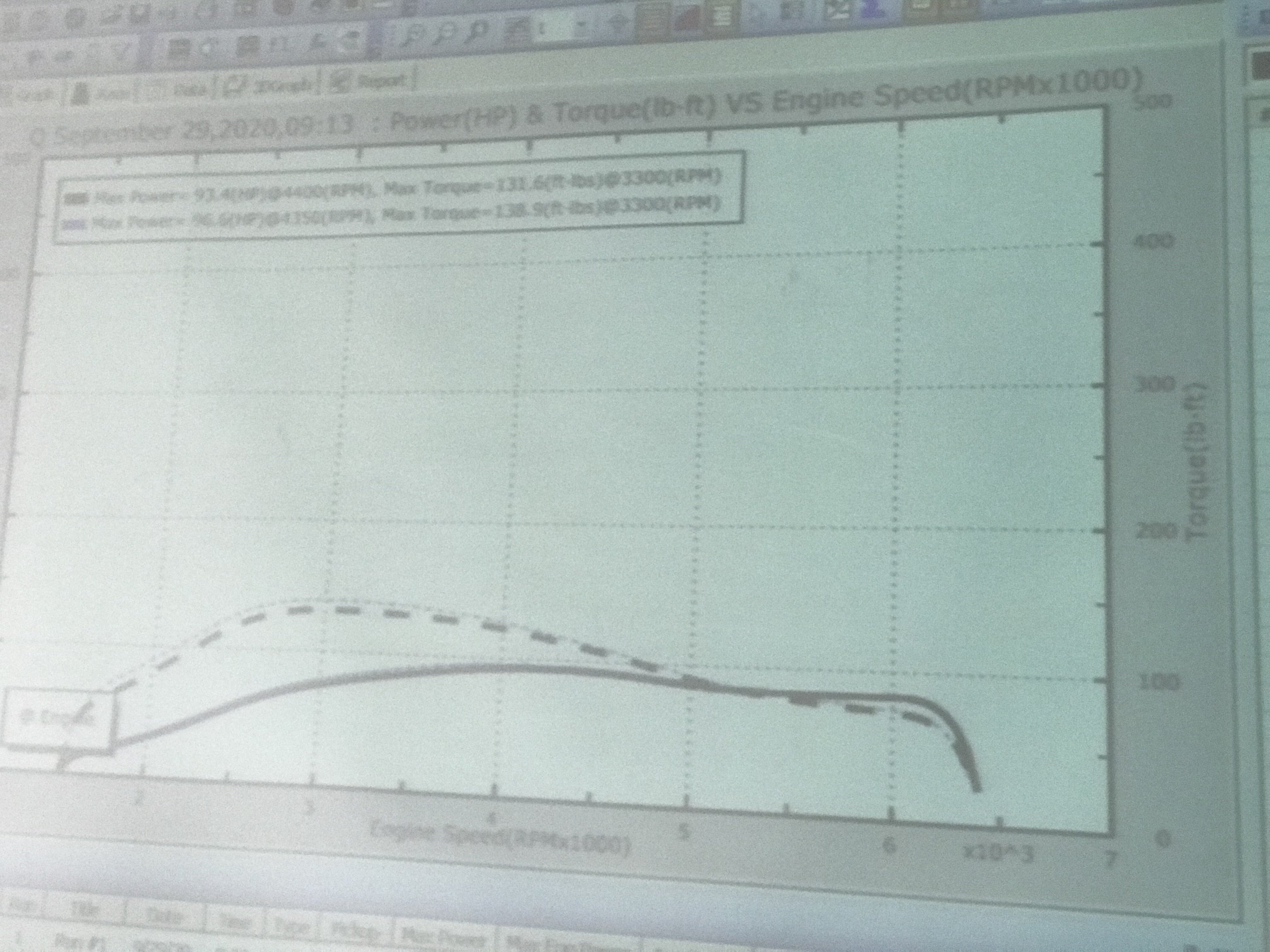

Well, it's none other than turbo tuesday!
Dyno run with stock map getting ~93 bhp and 135 ftlbs (1st pic)

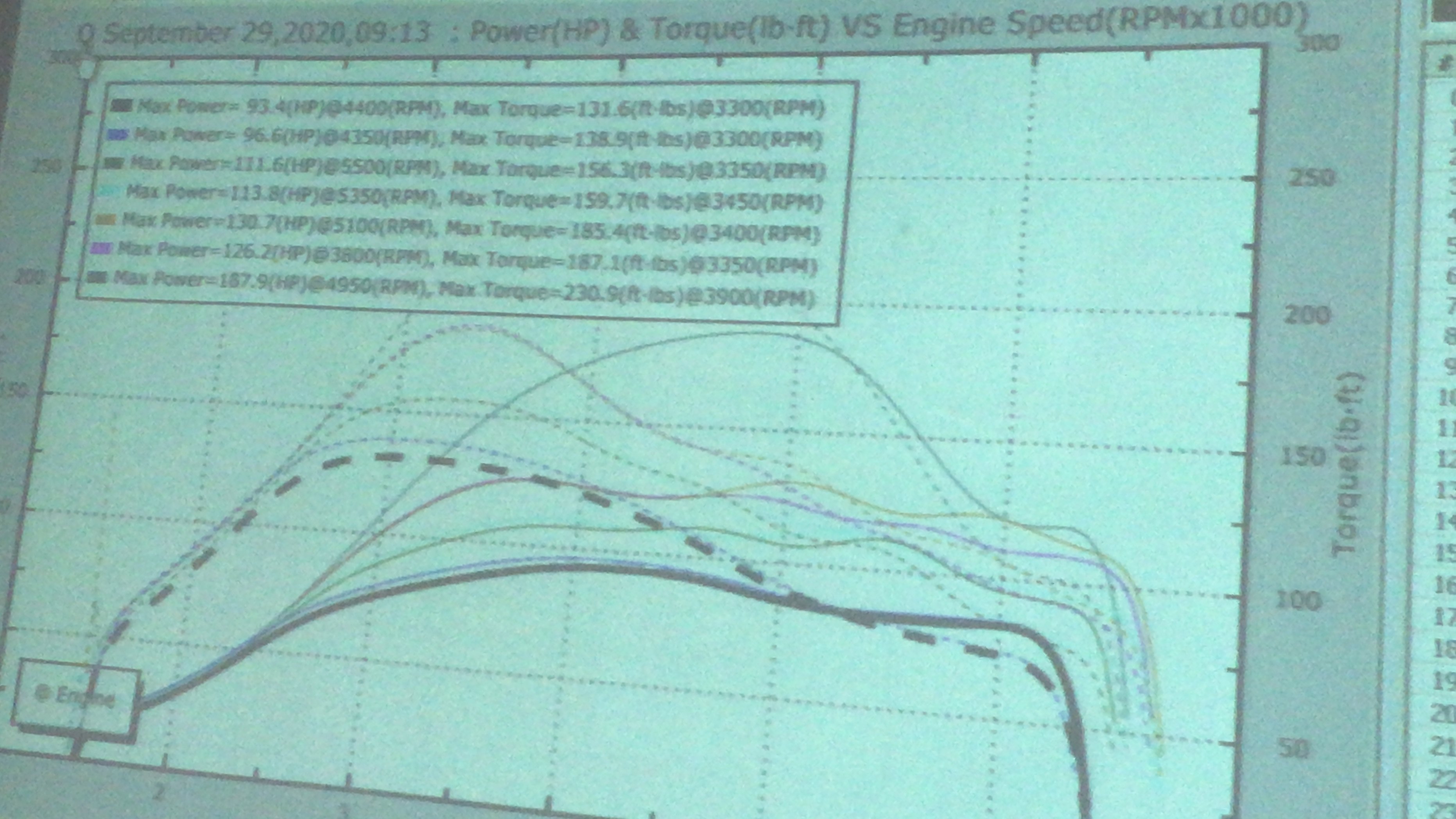

A few runs creeping up then an experimental run with the turbo at 100% racking in 188 bhp and 230 ftlbs (2nd pic) that's 311nm!
Backing off a bit and finishing off the top end i think.. let's see how it goes!
Edit: Just saw 200+ on a unrecorded run! Definitely don't think thats what is ending up with haha
WOW!!! And this is on standard exhaust right? No sports cat or decat right?! Incredible!
Standard exhaust, standard intake, just a turbo swap.
On an unrestricted run it peaked a tad over 1.5bar (its a 2.5bar map sensor) with 240ftlbs and 208bhp, that was a benchmark to see what's possible from the turbo. The engine wouldnt last with it like that 24/7 but its fine for a single pull.
Backing it off a fair bit to around 1.3bar to keep things safe and seeing how it holds there, aiming for around the 175bhp mark.
That is mental, makes me wonder what the 1.2tsi is capable of with uprated internals and the hybrid 1.4 turbo....

Unfortunate conclusion to yesterdays Turbo Tuesday, it's back to stock for the time being, as there's something wierd happening beyond the 4500 rpm mark, where beyond a certain boost level it closes off the throttle, the turbo's still trying to make boost and the ecu is still dumping fuel in as it goes mad rich at that point, it's just closing the throttle for whatever reason.
The other thing being wierd is the wastegate actuator, cycling it with vcds it moves perfectly fine, but in practice there's a gap where it's goes from being open to just shutting off and sending boost to the moon, so that wasn't helping things.
I'm swapping the actuator across from the old turbo, and the tuner is looking into the maps to see if there's something that's missing for whatever reason, perhaps there's a high rpm throttle map thats not showing up or something, who knows!
So it's booked in for 3 weeks time on the 20th, at that time it'll probably be having the secondary cat removed, unless something else happens and i get a custom downpipe but thats on the less likely side of things 😂
