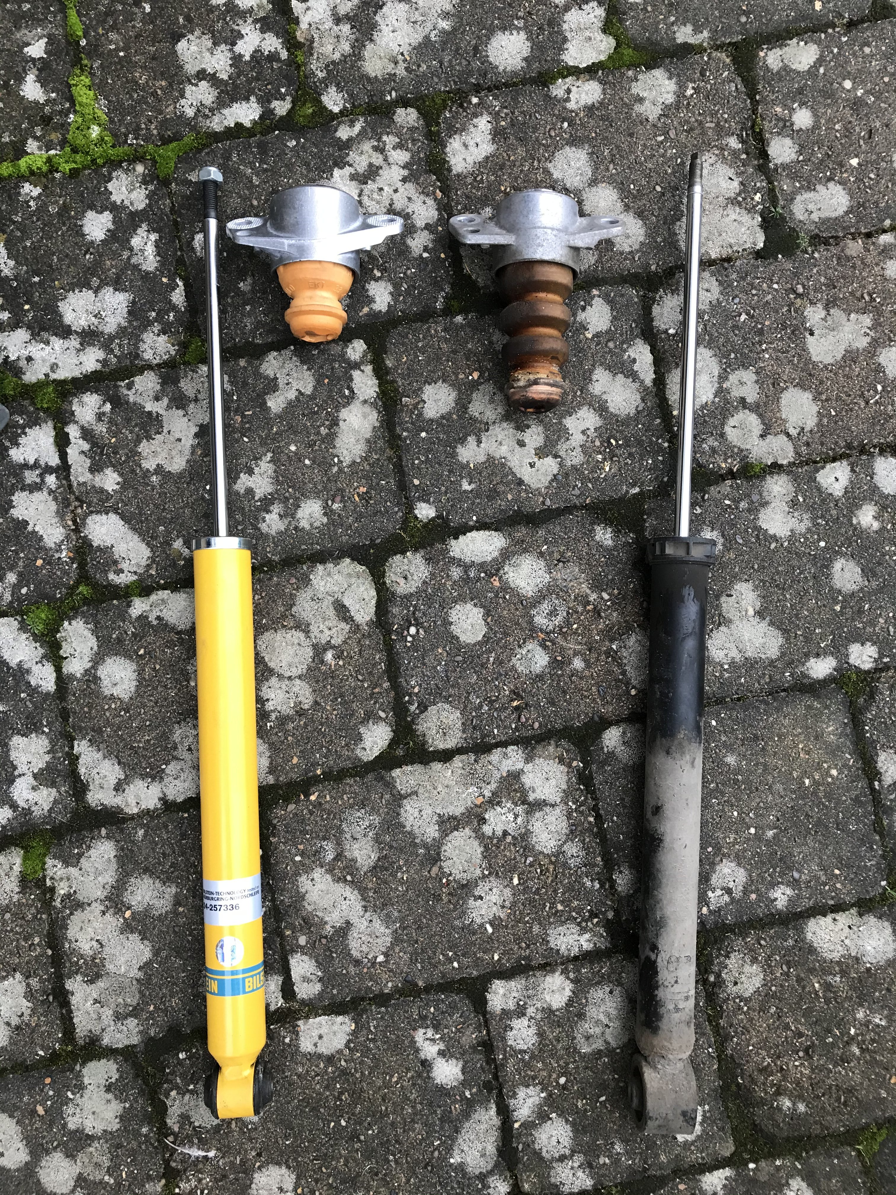

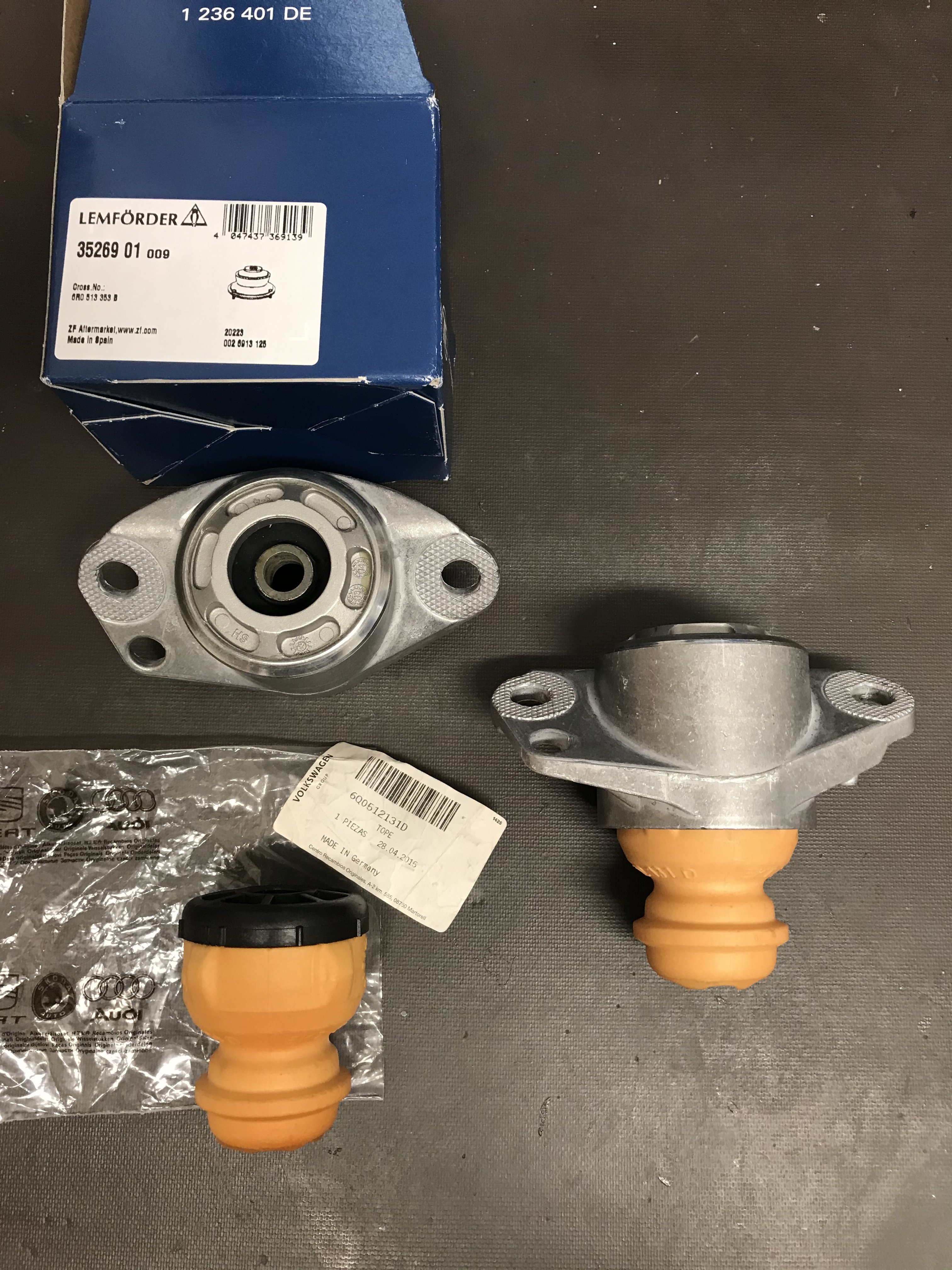

Out with the old, in with the new.
Bilstein B8 Shocks,
New top mounts,
New Ibiza Cupra R bump stops (67mm instead of 123mm).
I already have Eibach lowering springs (45mm drop at the rear) and judging by the condition of the bump stops it's been bashing into them quite often! The stock shocks are now a sloppy mess, barely any damping left in them at all!
The short bump stops mean the dust covers don't fully cover the shaft when it's in the air but when it's on the floor it's well covered.
The rear end is no longer floating around at high speeds, it's certainly firmer, but it's not crashy at all, it's how i'd expect a brand new car to ride, i assume they'll bed in a little after theyve got a few miles on them and soften a tad but even so they're really great.
Now just for the front end..

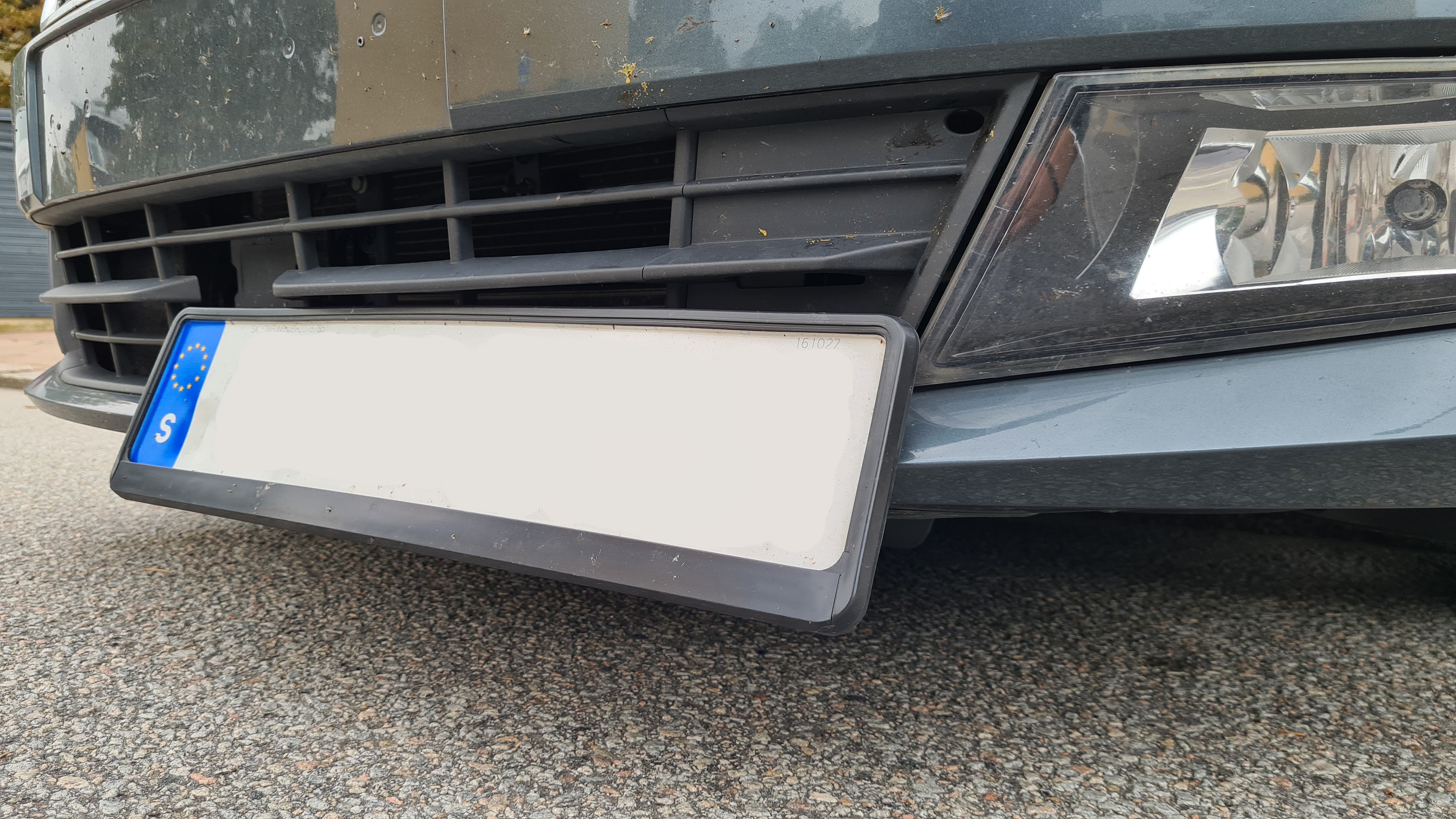

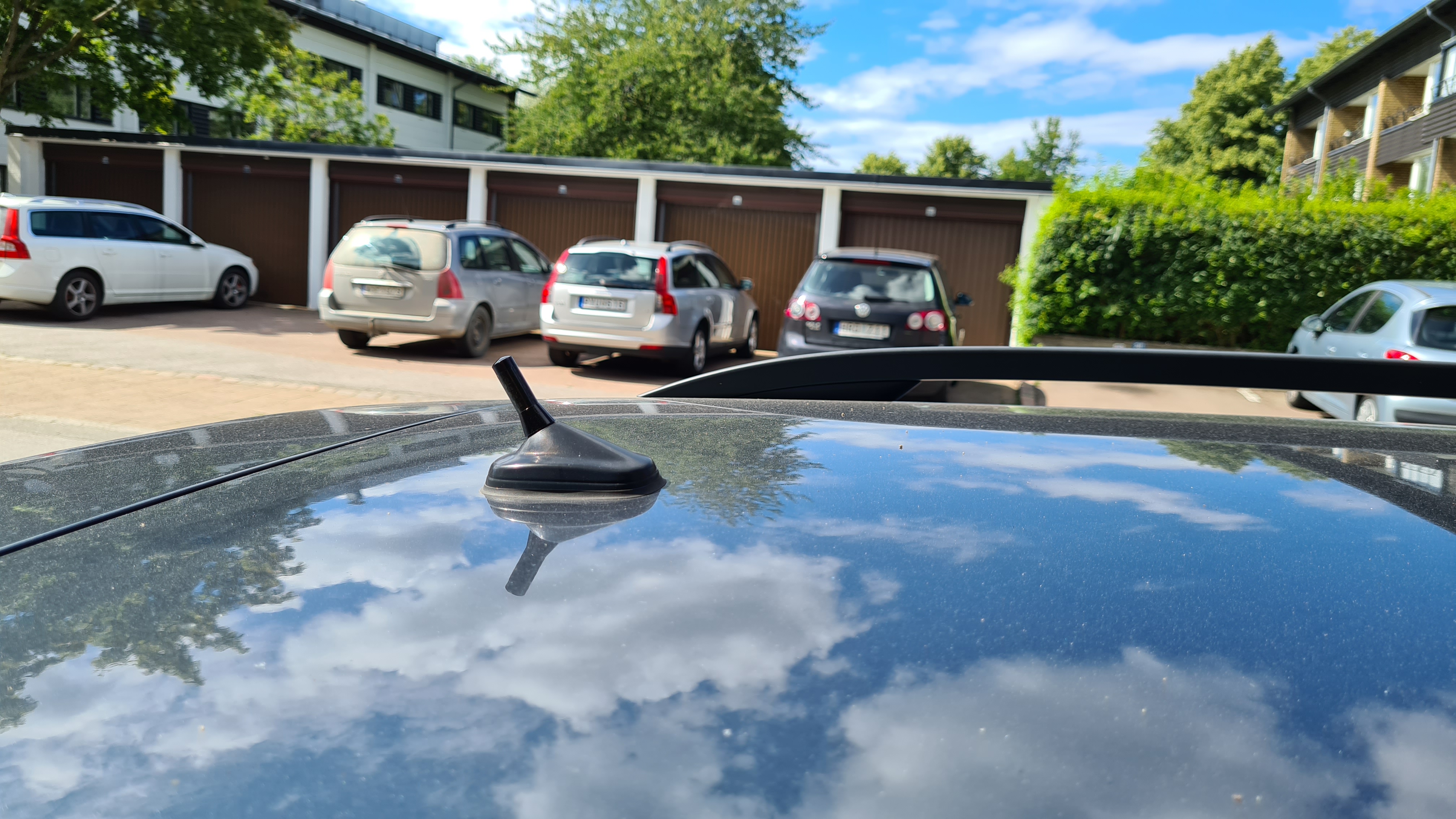

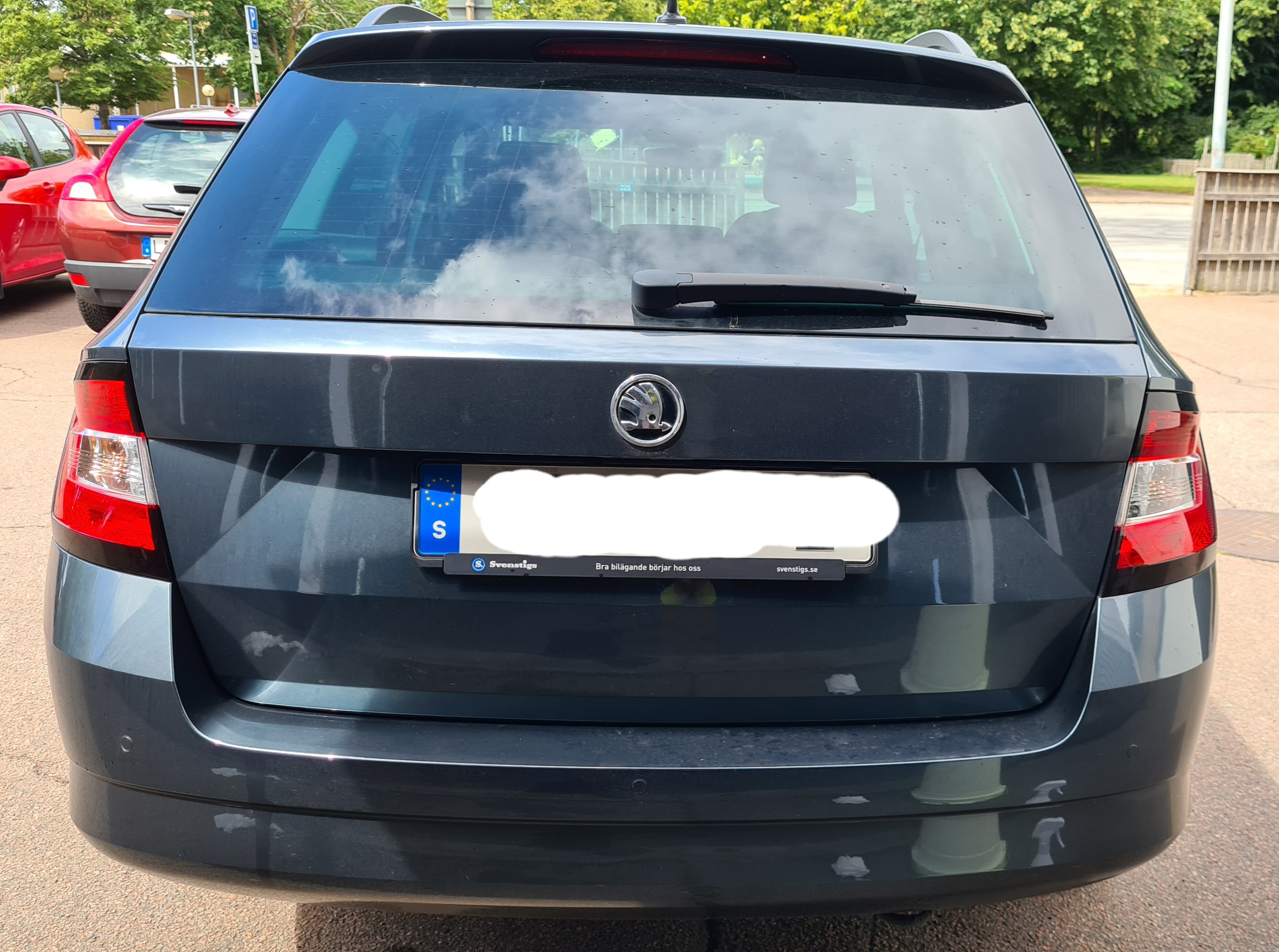

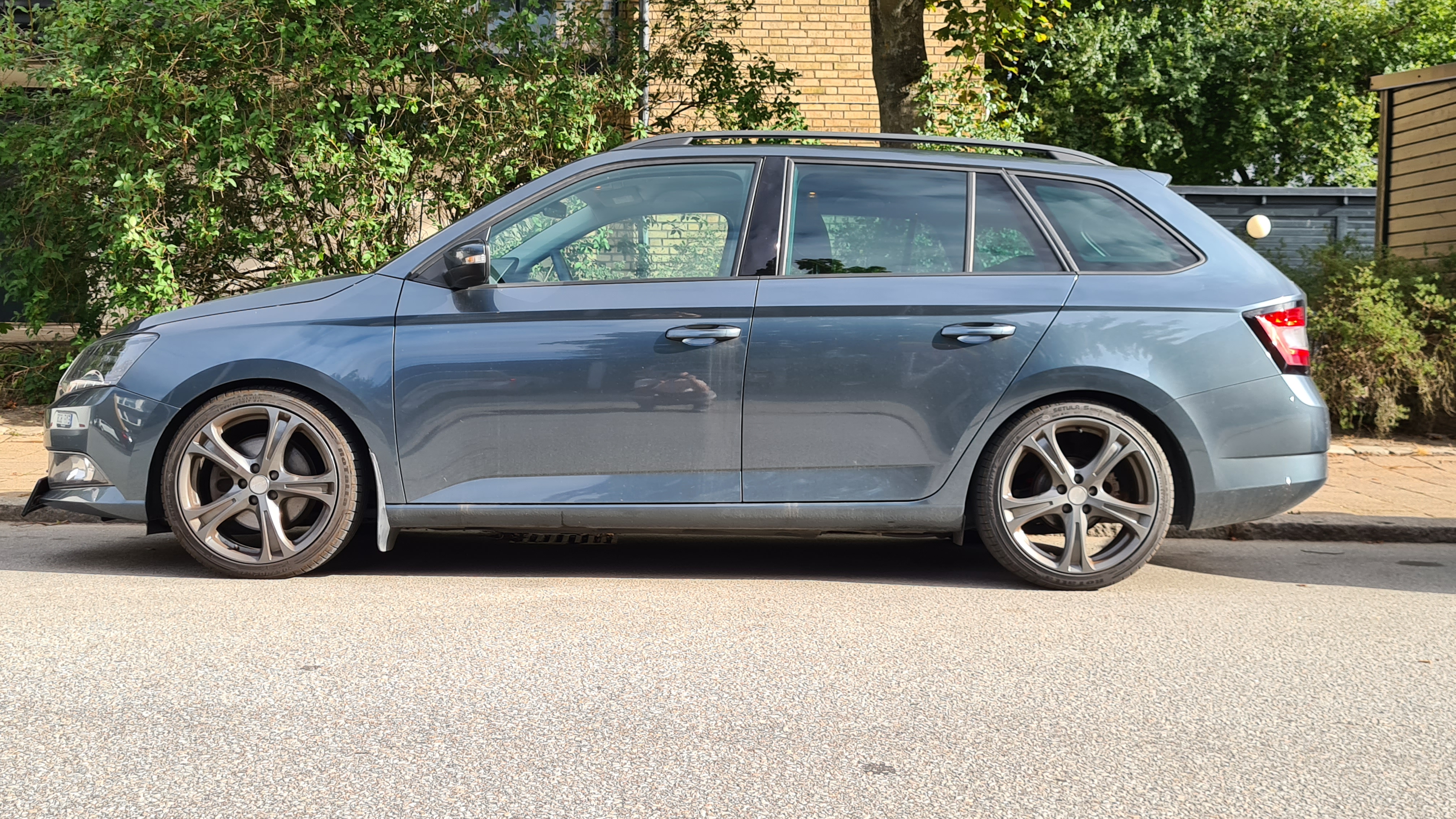

Hi
Im new to this forum  here is my mk3.
I lowered it by 40mm in front and 50mm in the rear.And mounted 7x17 inch wheels with 205/40 tires.
Changed the antenna to a 1 inch length.
Removed the lettering on rear of car.
Relocated the license plate.

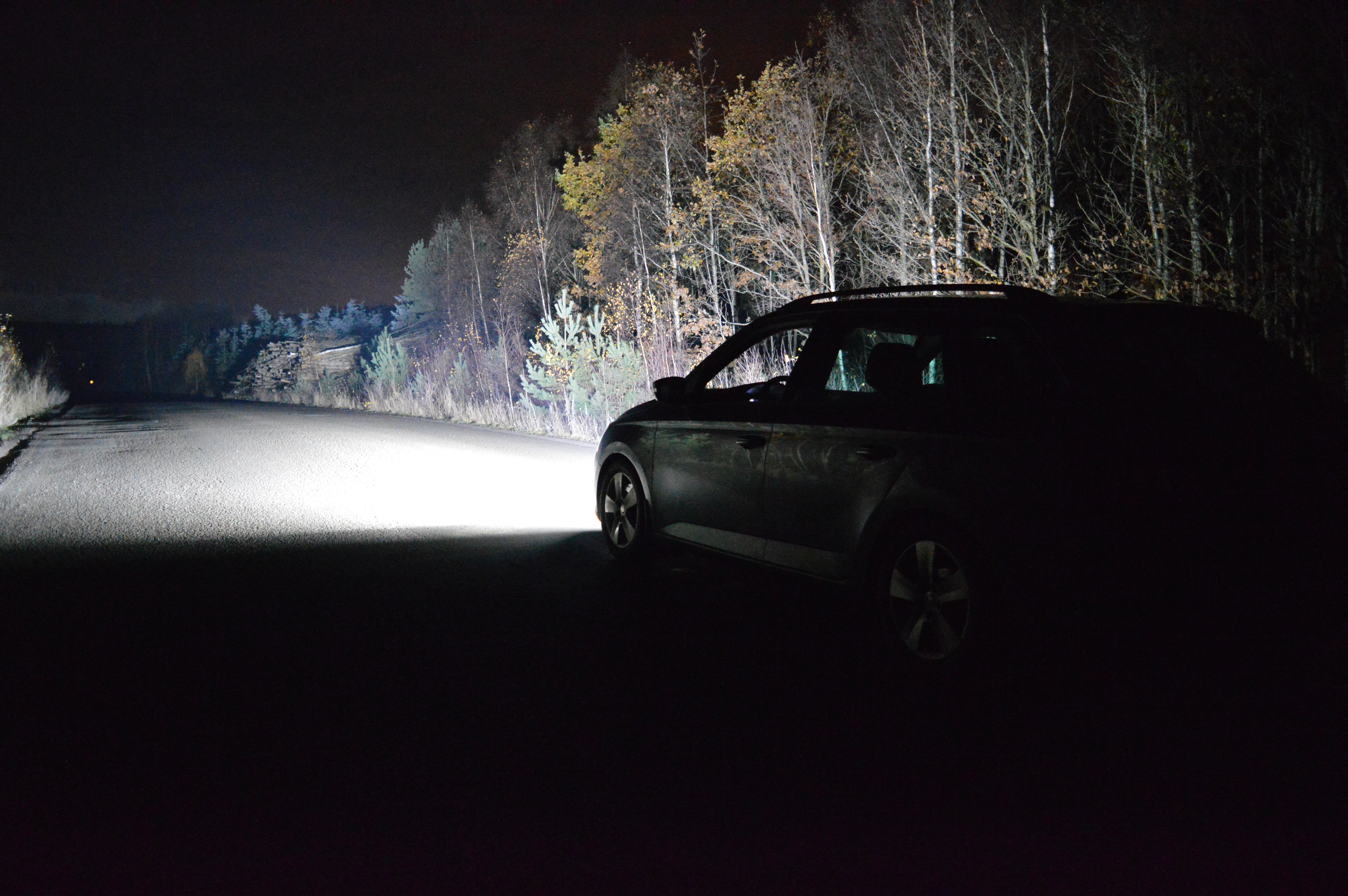

And i mounted a LED light bar

How good is the relocated snow plough? ;)
Does it obscure the lidar sensor at all?
Thanks, AG Falco
Thanks, AG Falco
Haven't gotten any proper snow last 5-6 years :)
It Doesn't obscure at all actually :-)
