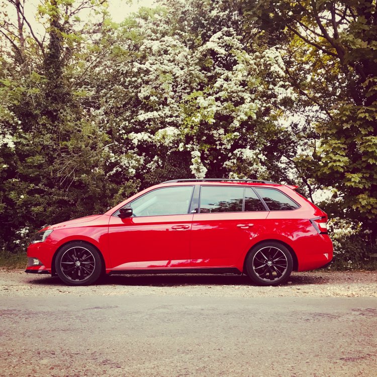

  • Just bought my monte carlo a few weeks ago.    Only done a few mods to it so far.   I've lowered it on eibach springs (30/45mm) and sprayed the badges black.    Also clay

Yeah, this is a Pre-Facelift Monte Carlo Estate (1.2TSI).

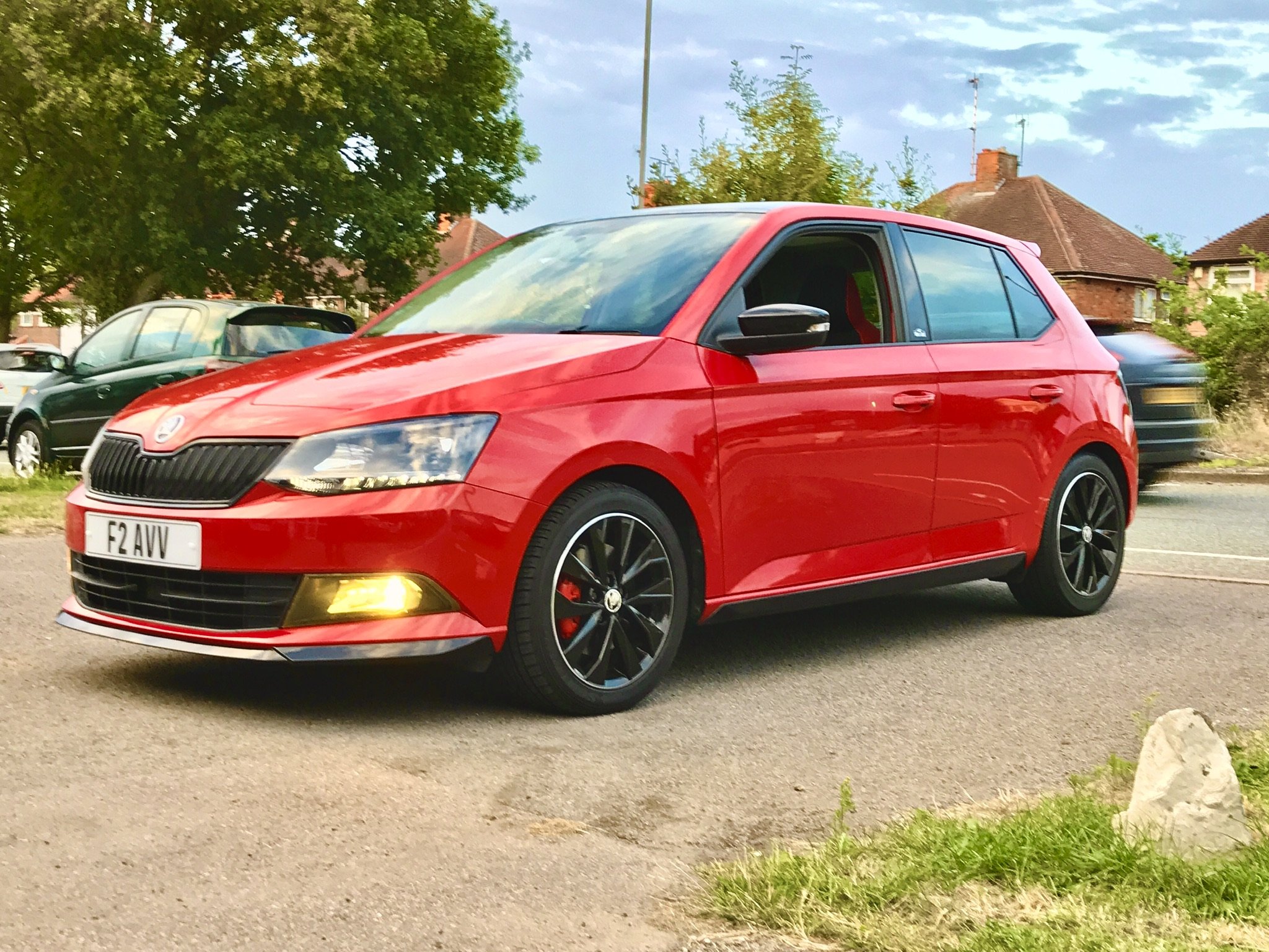

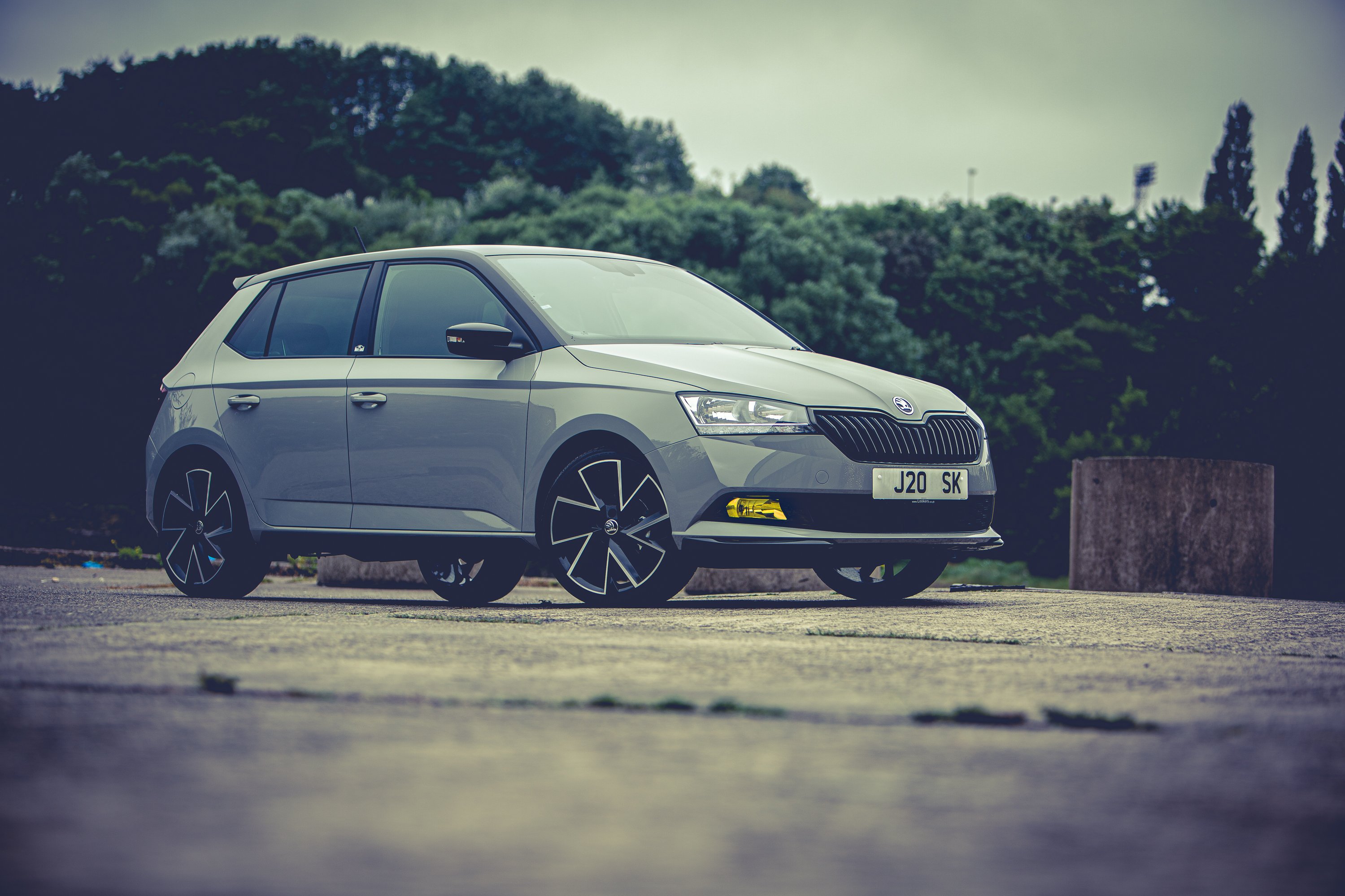

 A very very light modification - Frenchy Foglights!
Ayy, nice to see more people with yellow fogs
Yellow fogs are the best aha

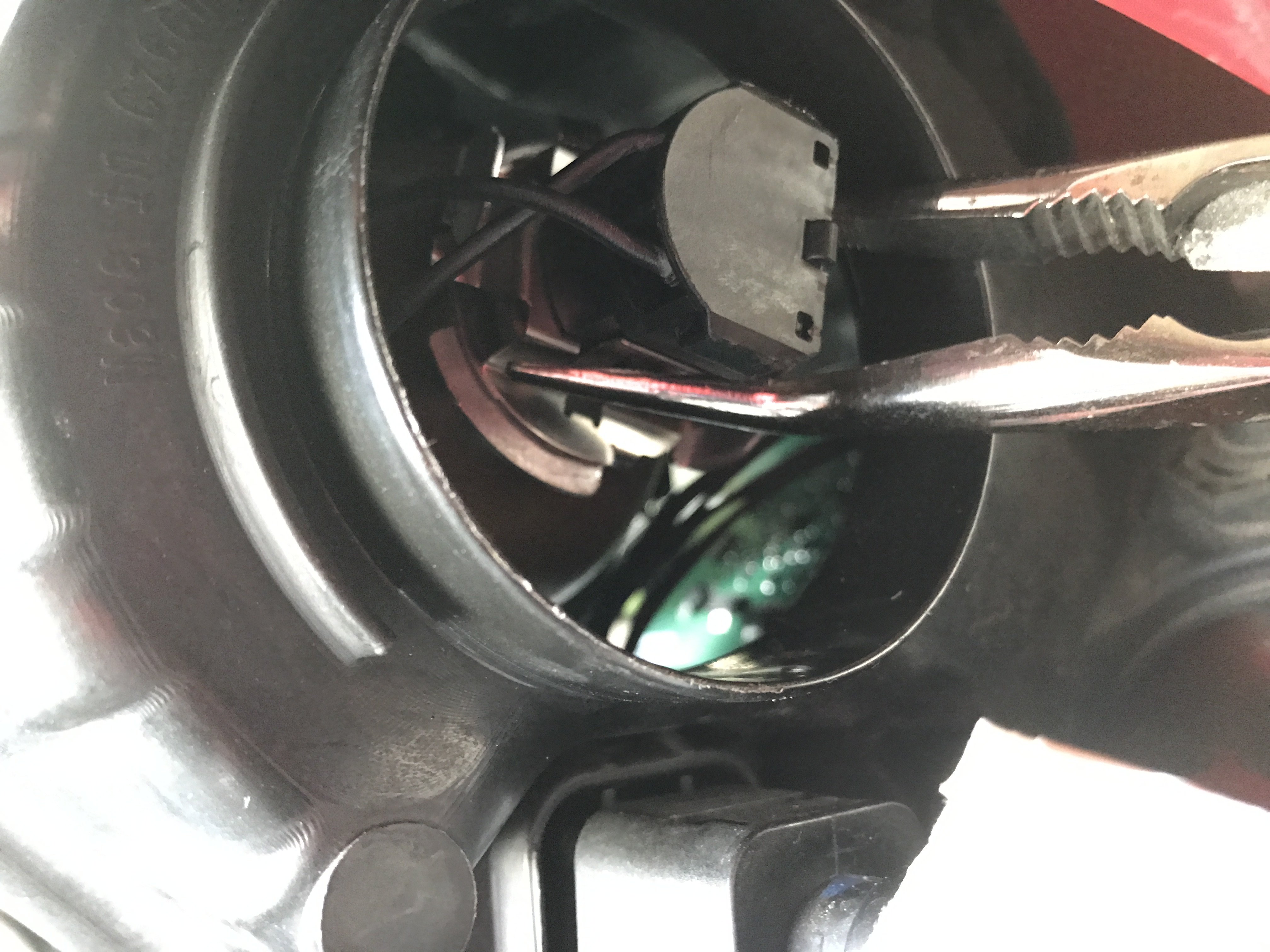

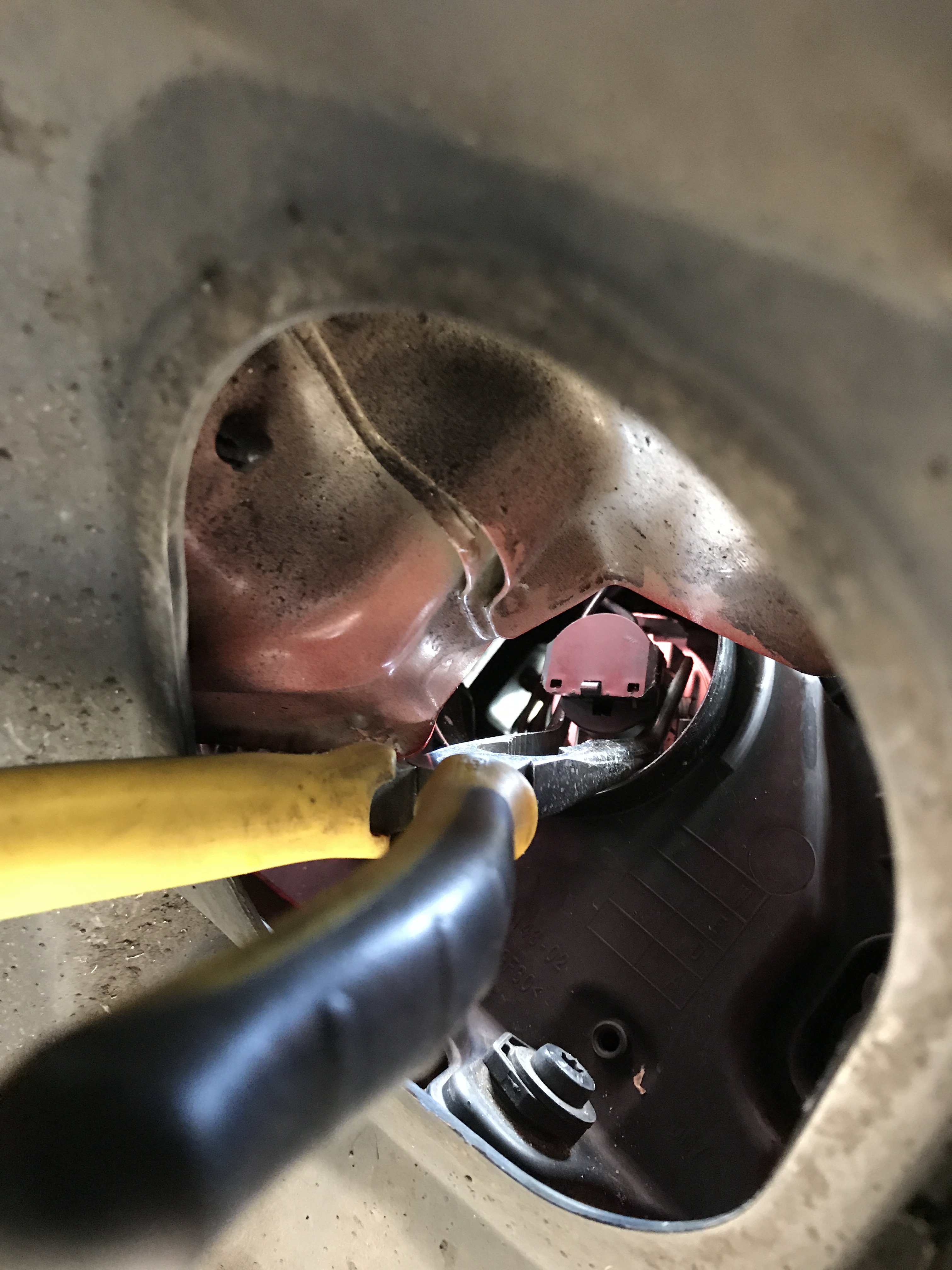

Speaking of lights, has anyone got any ideas on how the headlight bulb comes off? I’ve been at it for ages now and I can’t get the stupid thing off.
I've swapped my front lights to LEDs.  Assuming you have the projector headlight units with H7 bulbs, there are two rubber covers on the back of the unit that just slide off.  The bulbs need turning anticlockwise I think to remove.
If you're just replacing the bulb with a standard one, just take the bulb off the metal clip attached to the plug.  If you're switching to LED, you will need a metal adapter to attach to the led bulb and you can just plug the other end of the led bulb into the h7 plug normally.
For the indicators, there is a rectangular piece of plastic it is attached to with a round hole at the end to pull out the indicator bulb out.
If you need pictures, i may be able to do so in a bit when I get back home.
Edited by TheFozzy
Yea mate I’ve got the projectors, I managed to get it off in the end. For some reason the connector is a lot stronger on the drivers side so I used some angled pliers. Passengers side was easy and I even managed to keep the battery on.
Which bulbs did you get for yours?
