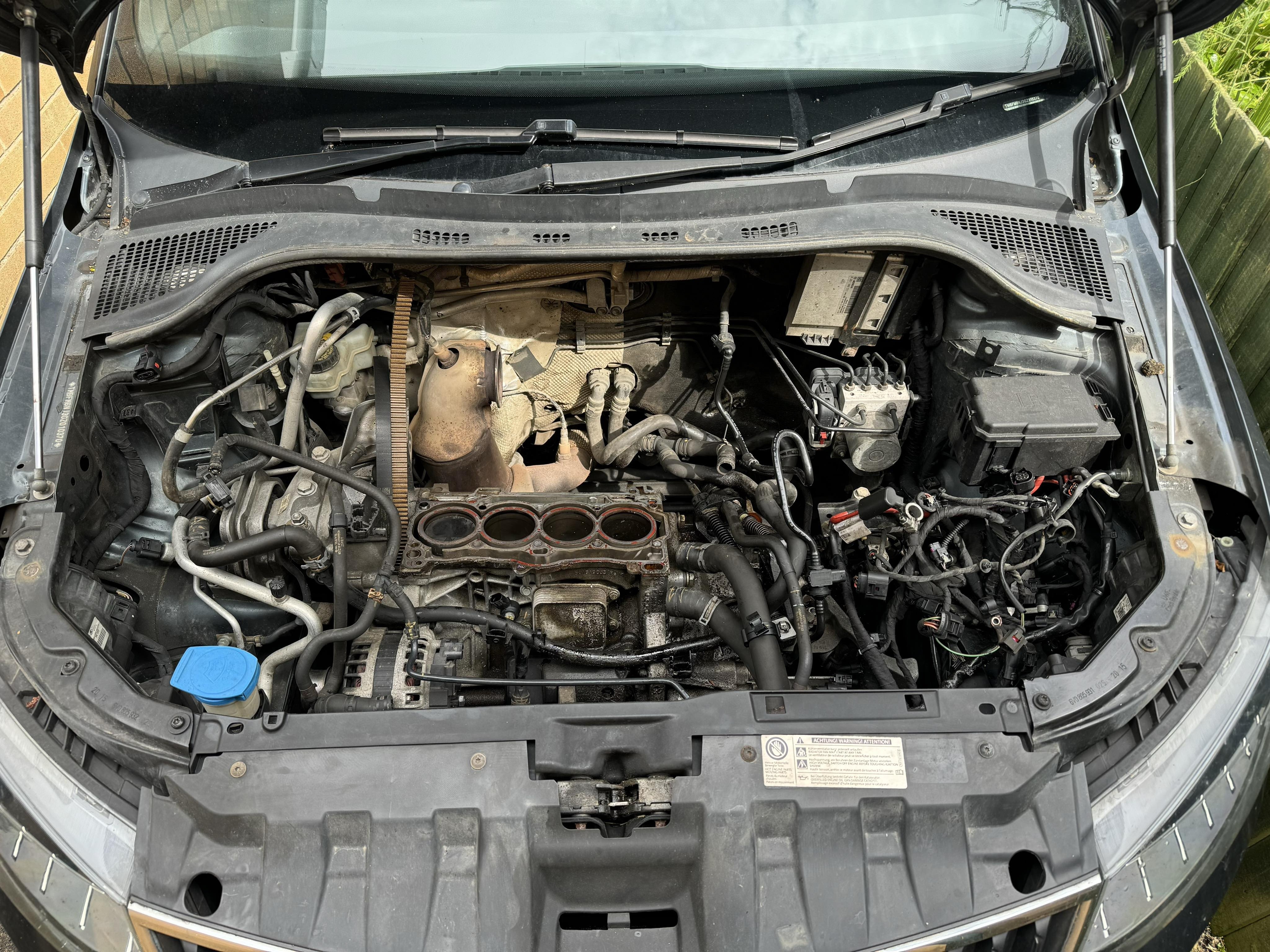

The JBS hybrid turbo gave me a good 110,000 miles (the engine reaching 182,000 miles) of pure joy, no issues engine or turbo wise. My engine unfortunately died a pretty untimely death at 182,000 miles, there was no individual point of failure, rather a few things that contributed to its death.
I'm running a PCV delete, part of the PCV system is a little line that goes from the bottom of the intake manifold back into the engine block. This allows the manifold to pull a vacuum on the crankcase, i had this deleted. The downside to that is that line also acts somewhat as an oil drain to prevent oil building up in the manifold, and without it oil can pool up.
I religiously ran Millers 5w40 CFS NT+. That oil is great, it took some serious abuse. The problem arises when i needed to do a service, my usual go-to stockist was out of stock and everywhere else was twice the price at nearly £85 for a 5L bottle (normally i get it for £45-50), i took a gamble and put EuroCarParts budget 5w40 oil in "Triple QX" or something. Suddenly i went from consuming 1L every 7,000-8,000 miles, to consuming that 1L in barely 1,500 miles. No change in performance, no blue smoke or otherwise though.
A combination of this cheaper oil which seemed thinner by how i was consuming it so fast, the age of the turbo, and the lack of oil drain in the manifold (i did occasionally check for oil pooling in the manifold), resulted in the turbo oil seal letting through a lot more oil, the oil pooling up, and cylinder 4 sucking in a load of oil to the point it hydrolocked it.
Points to take from this, don't run cheap budget oil, and if you are pcv deleted, it'd be a good idea to set up some kind of oil drain setup to make sure the manifold doesn't build up oil. The turbo still spins fine and has no noticeable play in the shaft that would suggest anything is wrong with it, so it wasn't a catastrophic failure.

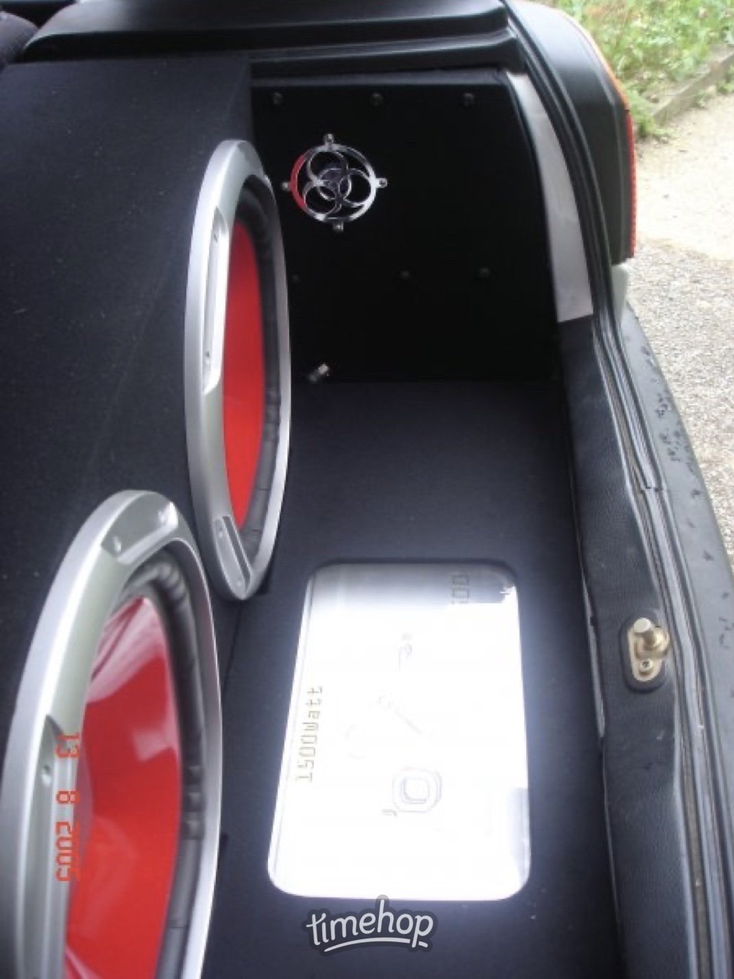

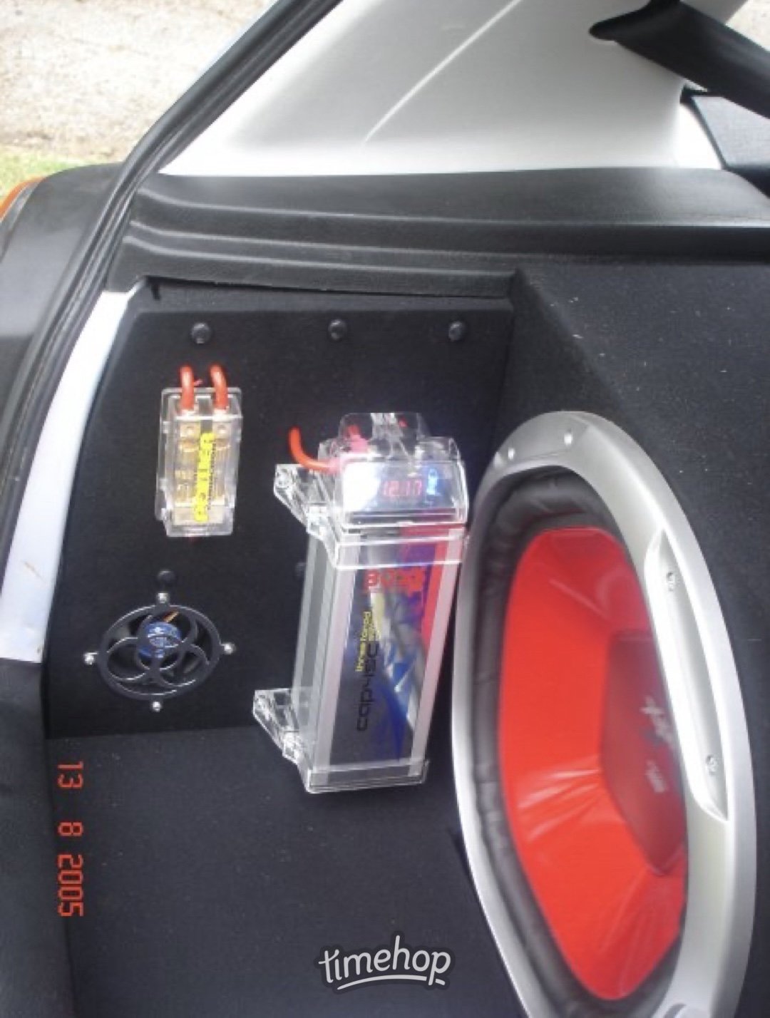

    I've built a small 8" subwoofer for my Fabia It's designed to fit snugly in the "basket" in the trunk and have a quick connection so it's easy to remove if needed.  If someone wants to see

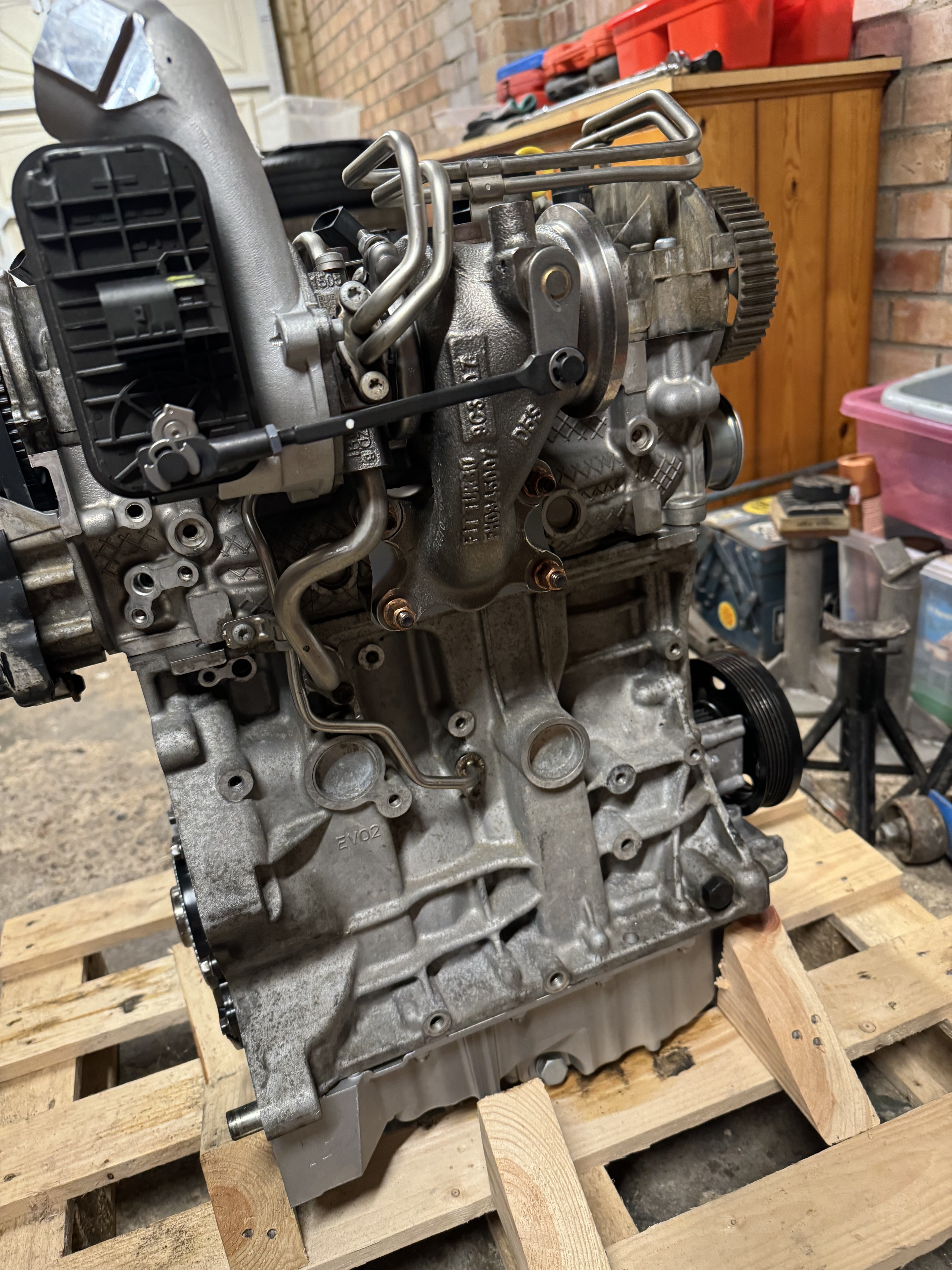

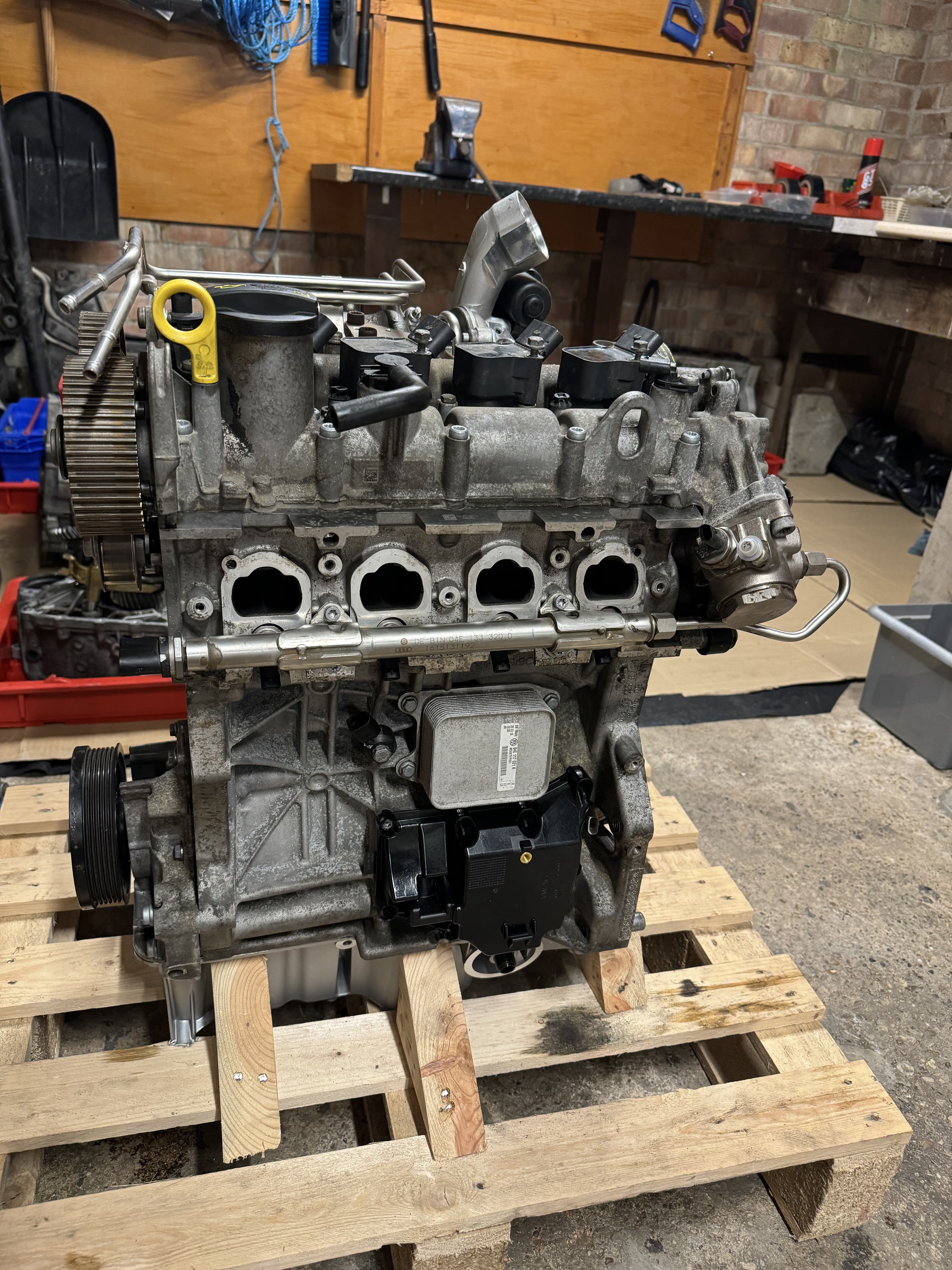

To update to my previous post, this is most definitely not the end of the Fabia!
Instead I have gone all out with something pretty mad by all accounts. Not a 1.8, or 2.0, or even larger, but something entirely unique in it's own rights.
This engine has been in the making for the past few months, with parts from many different engines all combined to build one familiar-but-not build. There have been many holdbacks, delays, problems to solve, hundreds of parts ordered, and too much money spent, but i'm too deep to back out of it now 😂
Full details will be released once it's up and running, which I anticipate to be by the end of this month!
Some details I can share however are that it's getting a much stronger 6 speed gearbox, a Quaife LSD, and finally a custom exhaust system!

No, it's mostly 1.2TSI parts. Some bits from other engines, like 2.0 injectors etc.

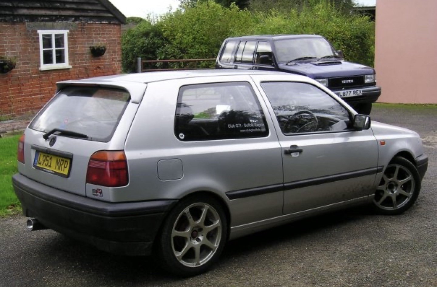

I started my driving career with a fairly mildly modified mk3 golf. Mostly a mad stereo tbh! I Stuck with vag throughout and now ended up with a mk3 facelift fabia. Planning on buying it outright in October and then gradually modifying it. Plan is:

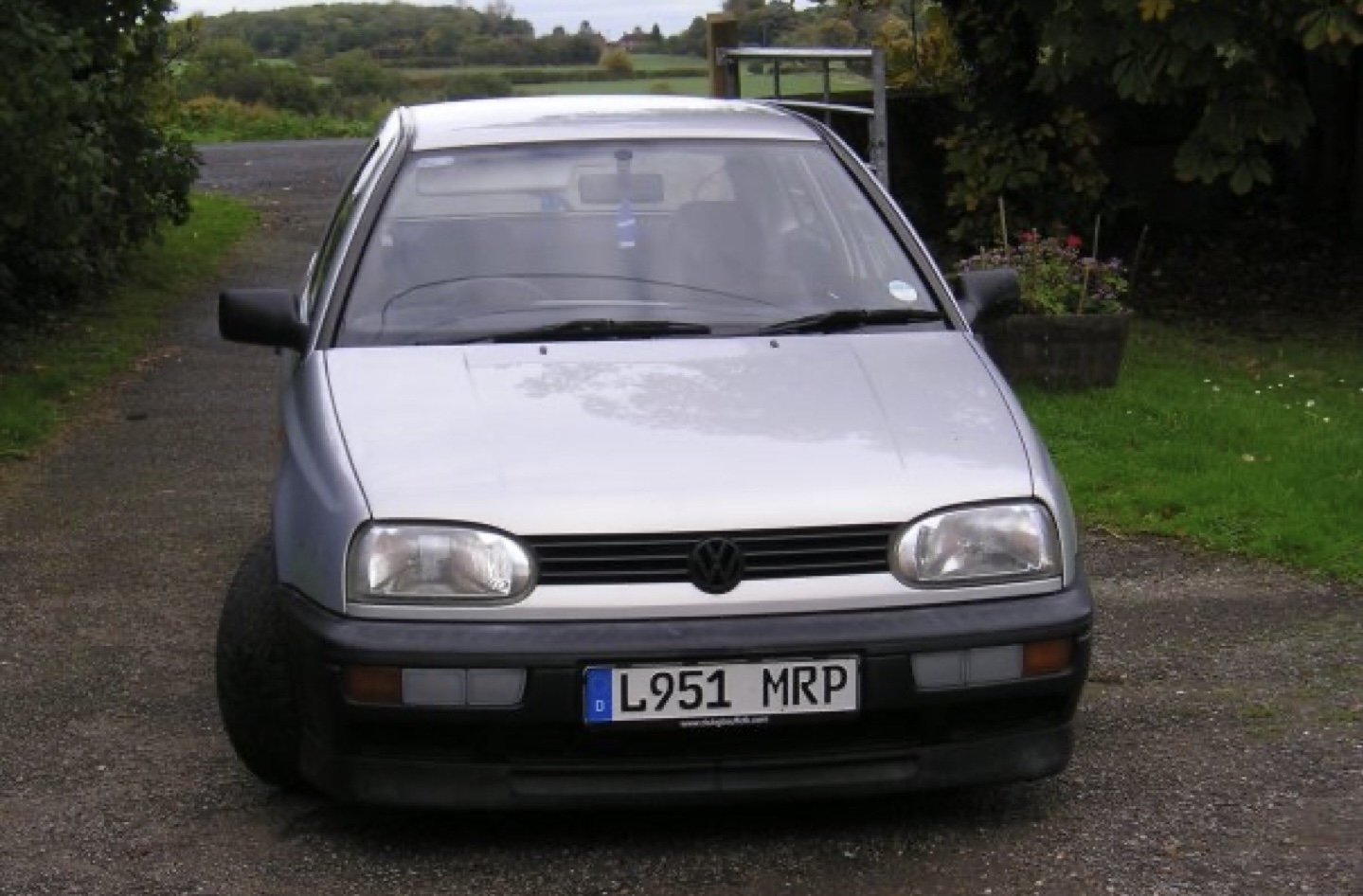

Edit - some pics of the golf if anyone is interested. All the work was done by me learning things the hard way at 17!

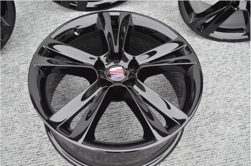

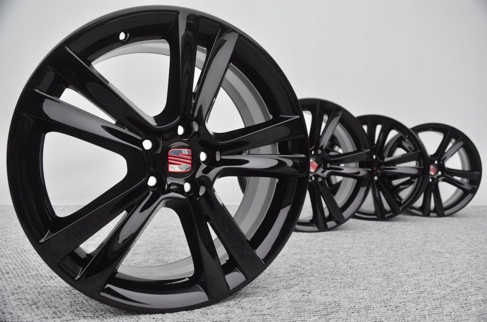

Hello

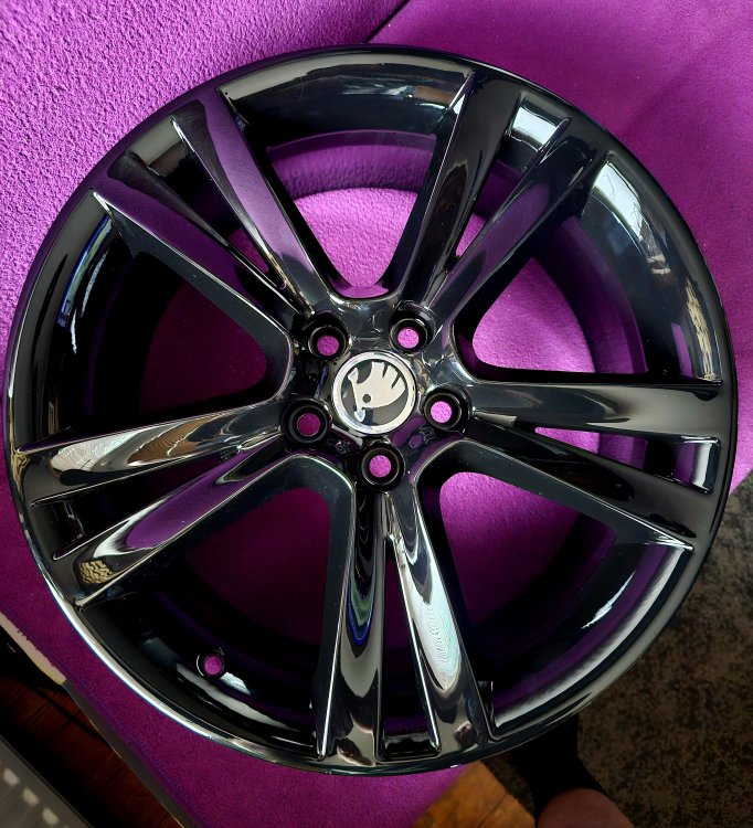

Yesterday I bought summer rims for my Fabia.
The rims are from Seat, but the seller will exchange the center caps for original Skoda ones for the purchase price.
The rims are 7J17 ET 43. The rims will be mounted with Continental PremiumContact 7 tires in size 205/45/17.
I'm very happy with the purchase of these rims.
I got myself a gift from Santa 😄
Edited by Woocash82
The rims have arrived 🤩
Tomorrow I'm going to apply a thick layer of wax
Edited by Woocash82
