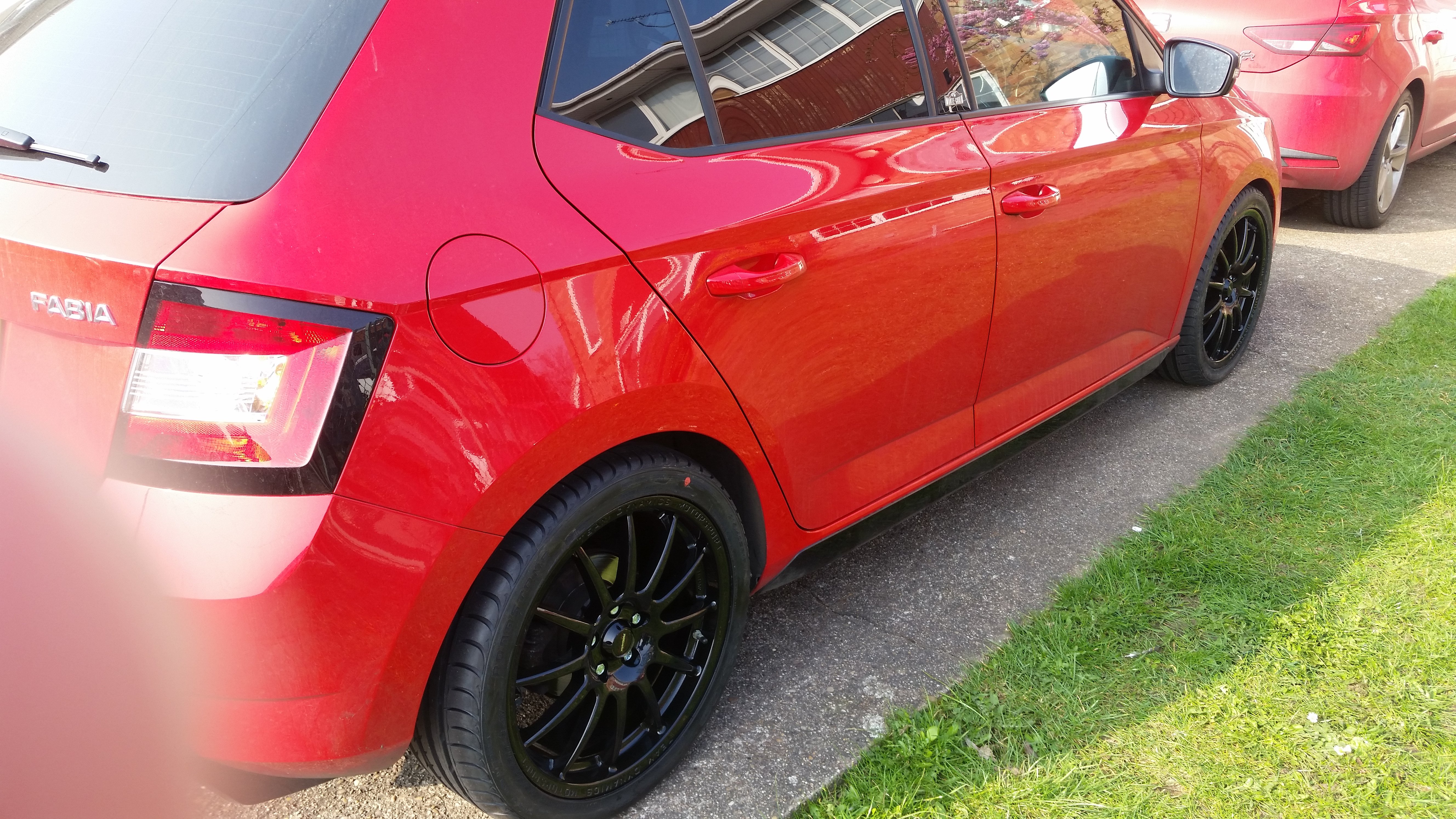

Lowering springs, rear anti roll bar and intake kit have all been fitted.
The sound is miles better than I though and the handling too! It feels like a different car, the handling has been asbolutely transformed. For someone who isnt planning to go to track days, Im glad I went with the springs instead of the coilovers. The rear anti roll bar has made the front end so much grippier, its fantastic!

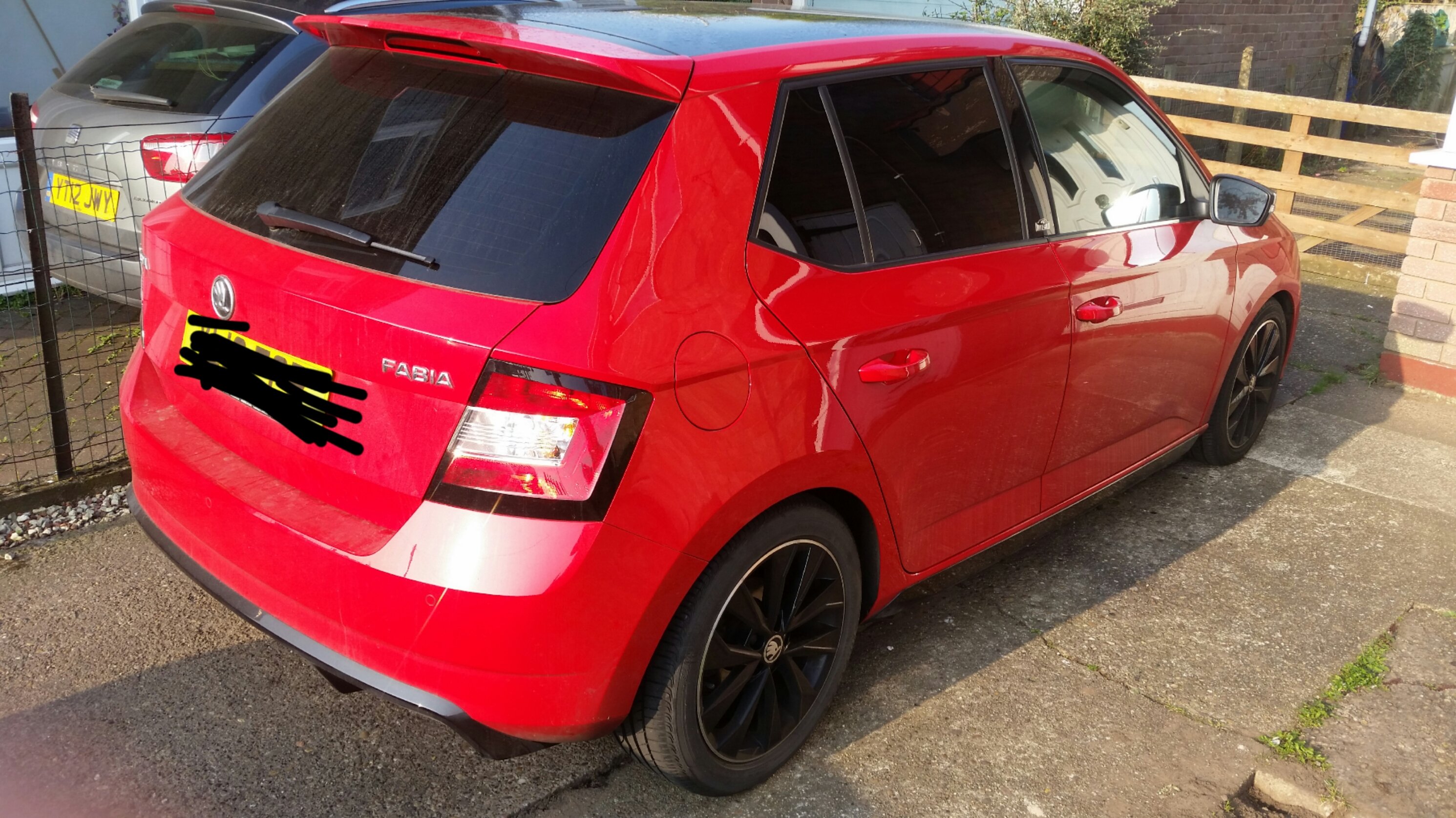

Windows have been tinted and Team Dynamics 1.2 fitted

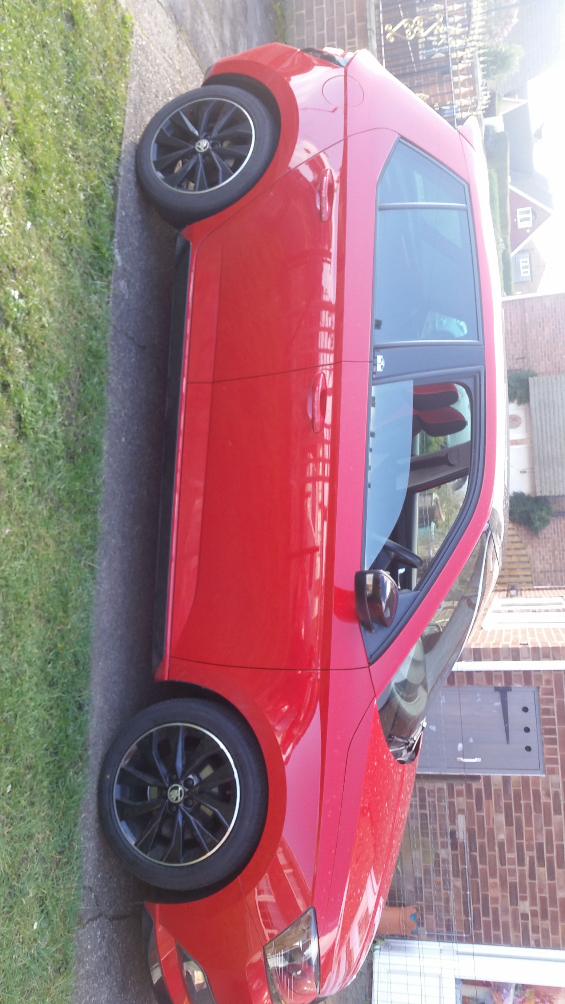

Wow that's a steep drive you have. Hope you have a strong handbrake.:sweat:
