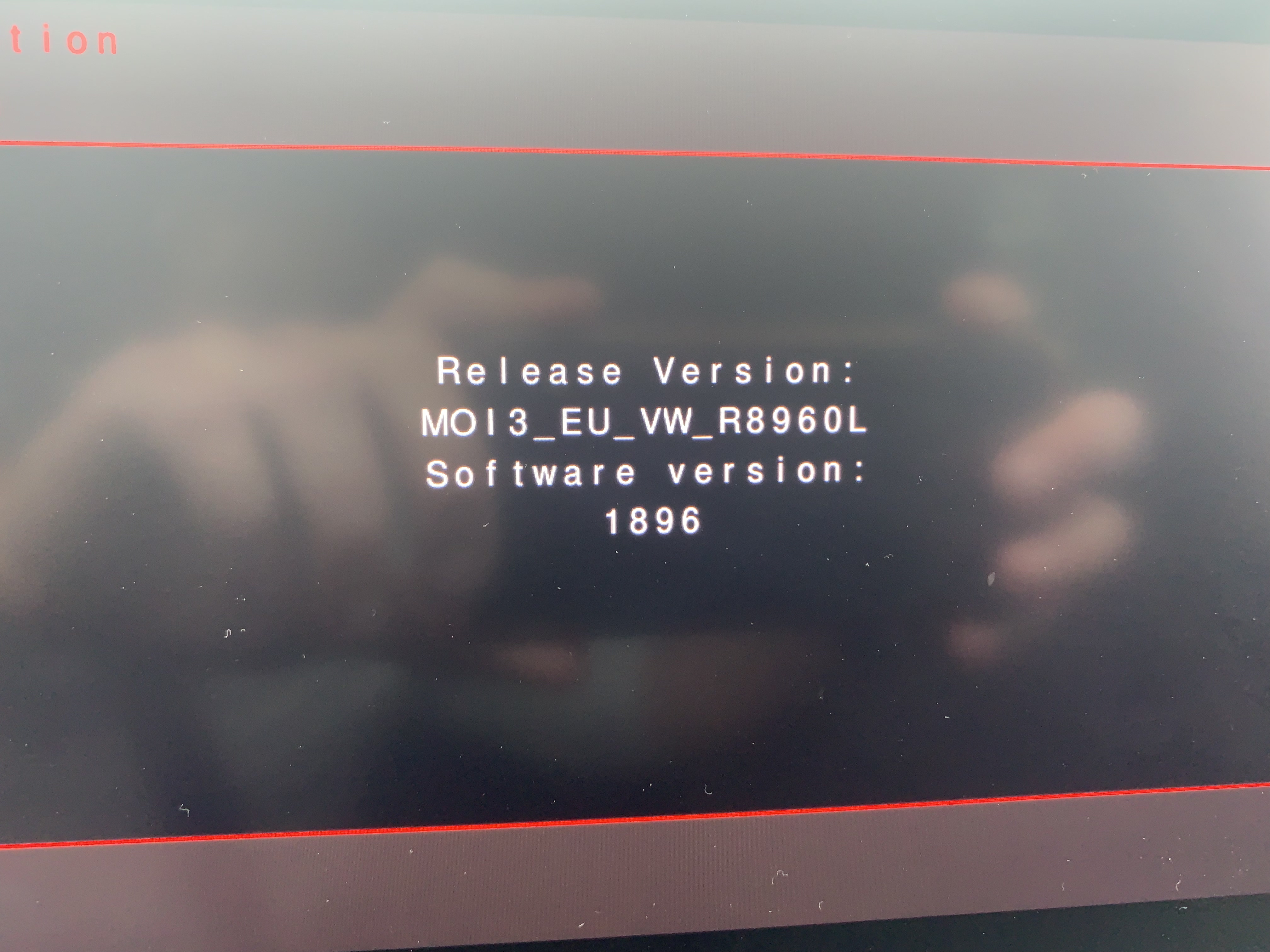

Hi, everyone,
I have a problem with frequent system reboots. Decided to upgrade software from version 1896 to 1941. Started by checking the current software version. It was MOI3_EU_VW_R8960L. As I understand it should be SK version or not?
Now I'm in doubt what firmware file to use for updating, because there are 2 options: 1) MOI3_EU_SK_9410L MU1941 and 2) MOI3_EU_VW_9410L(1941). Also noted that the VW archive file bigger than SK.
Many thanks in advance for any ideas.
