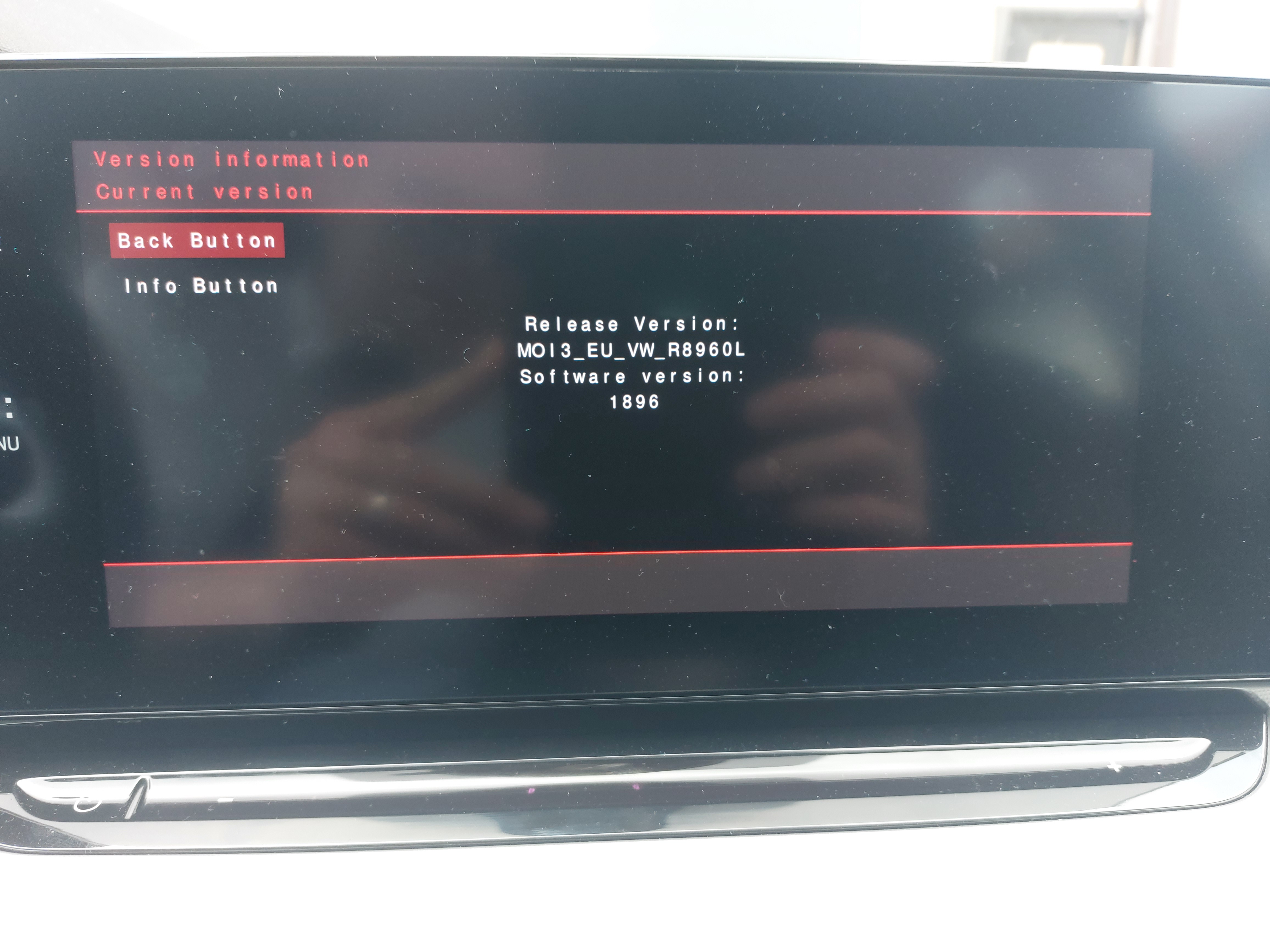

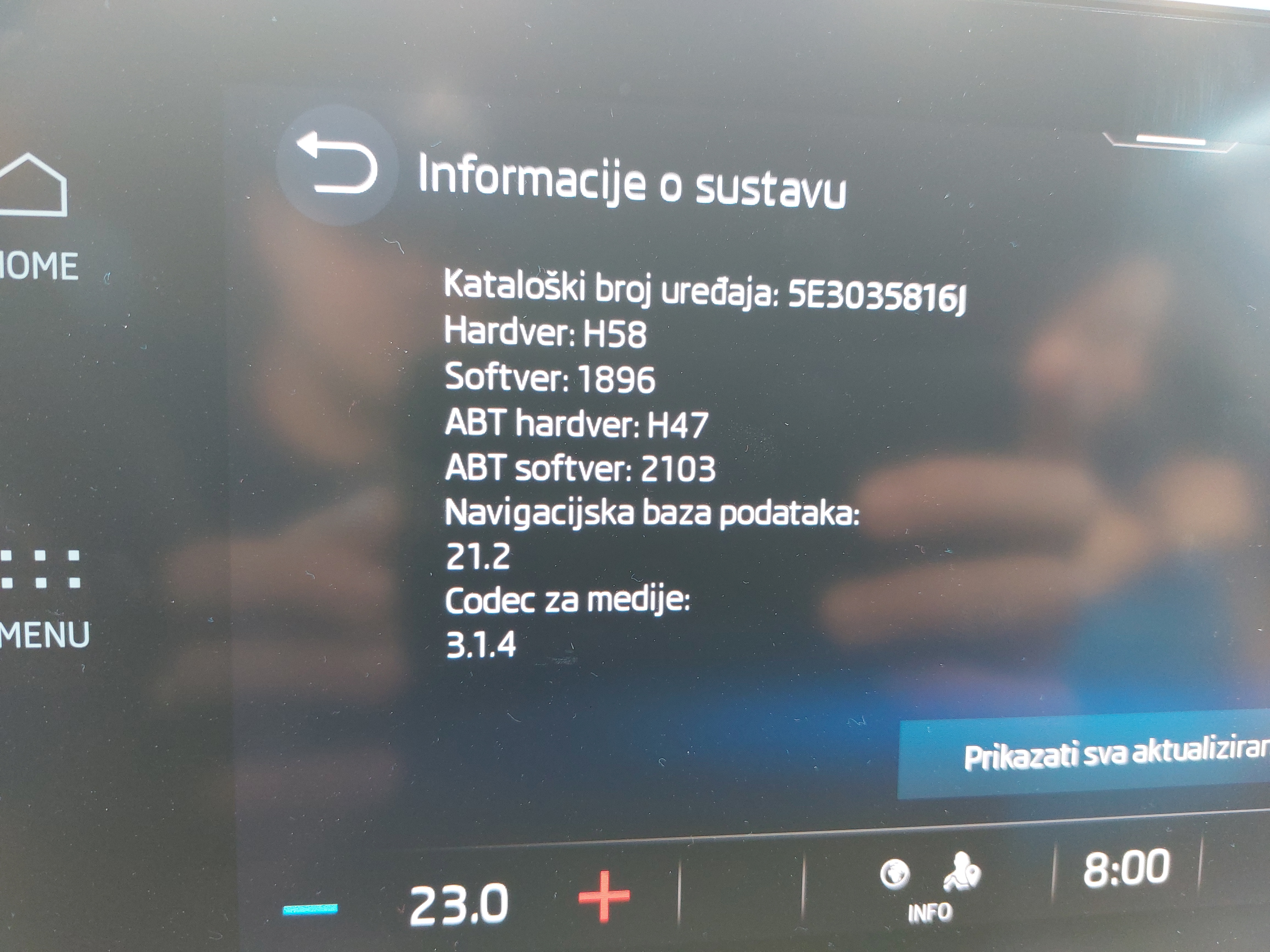

I have a problem with frequent system reboots. Decided to upgrade software from version 1896 to 1941. Started by checking the current software version. It was MOI3_EU_VW_R8960L. As I understand it should be SK version or not?
Now I'm in doubt what firmware file to use for updating, because there are 2 options: 1) MOI3_EU_SK_9410L MU1941 and 2) MOI3_EU_VW_9410L(1941). Also noted that the VW archive file bigger than SK.
Many thanks in advance for any ideas.
You should go ahead and download MOI3_EU_SK_R9410L MU1941_SK20230615S and apply it. My car was also runnig VW software train prior to the update to SK one.

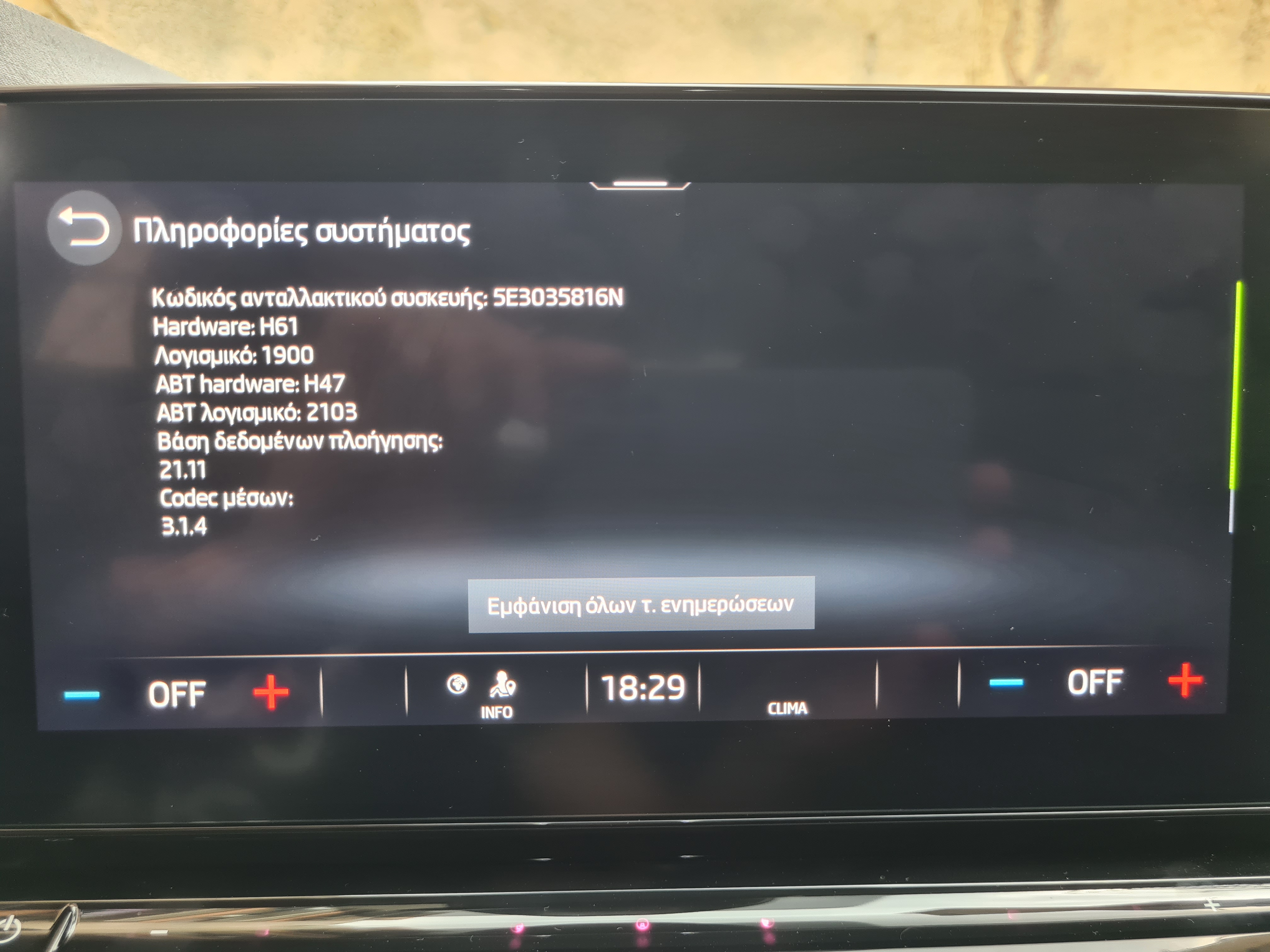

Hi, Octavia MK4 (NX) MY2023
Those are the photos of the infotainment version
Is this OK to use the "MOI3_EU_SK_R9410L MU1941_SK20230615S"  file for update ?
If it's 1900 firmware then it's good to go for the 1941 upgrade.
