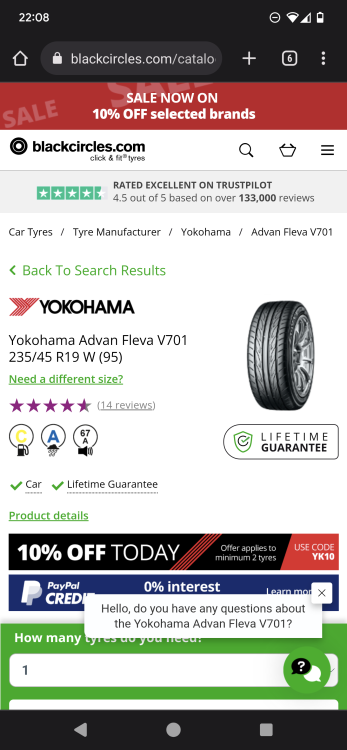

What do we make of these Yokohama's touting 67db?
I was gonna go up to 45profiles to get what comfort I could from the 19's and these came up with 4-5db lower than most?
As you can see in the chart below, 235/45R19 has an outside diameter 4.5% more than the standard 215/60R16 tyre size.
If you want 235/45, it would be better to go for 235/45R18 rather than 235/45R19.
I've added 245/45R18 and 245/40R19 to the chart, as some Superb MK3 owners have changed to those sizes. A 2.0% or 2.1% increase is far more modest than a 4.5% increase, so has the big advantage of running gearing that is a lot closer to how Skoda intended.

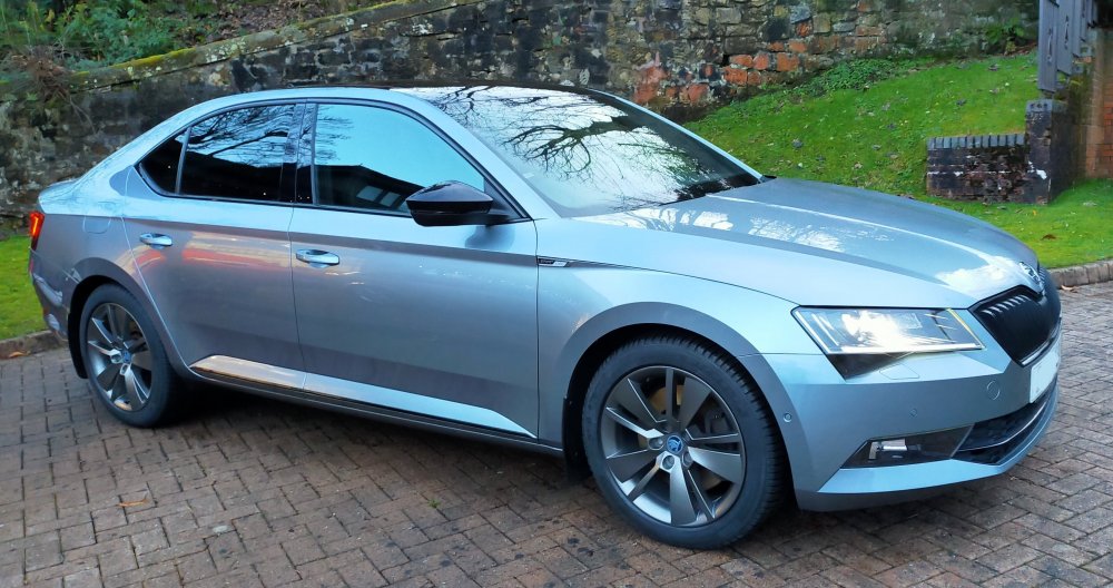

Superb MK3 280HP 4x4 fitted with slightly oversize 245/45R18 tyres

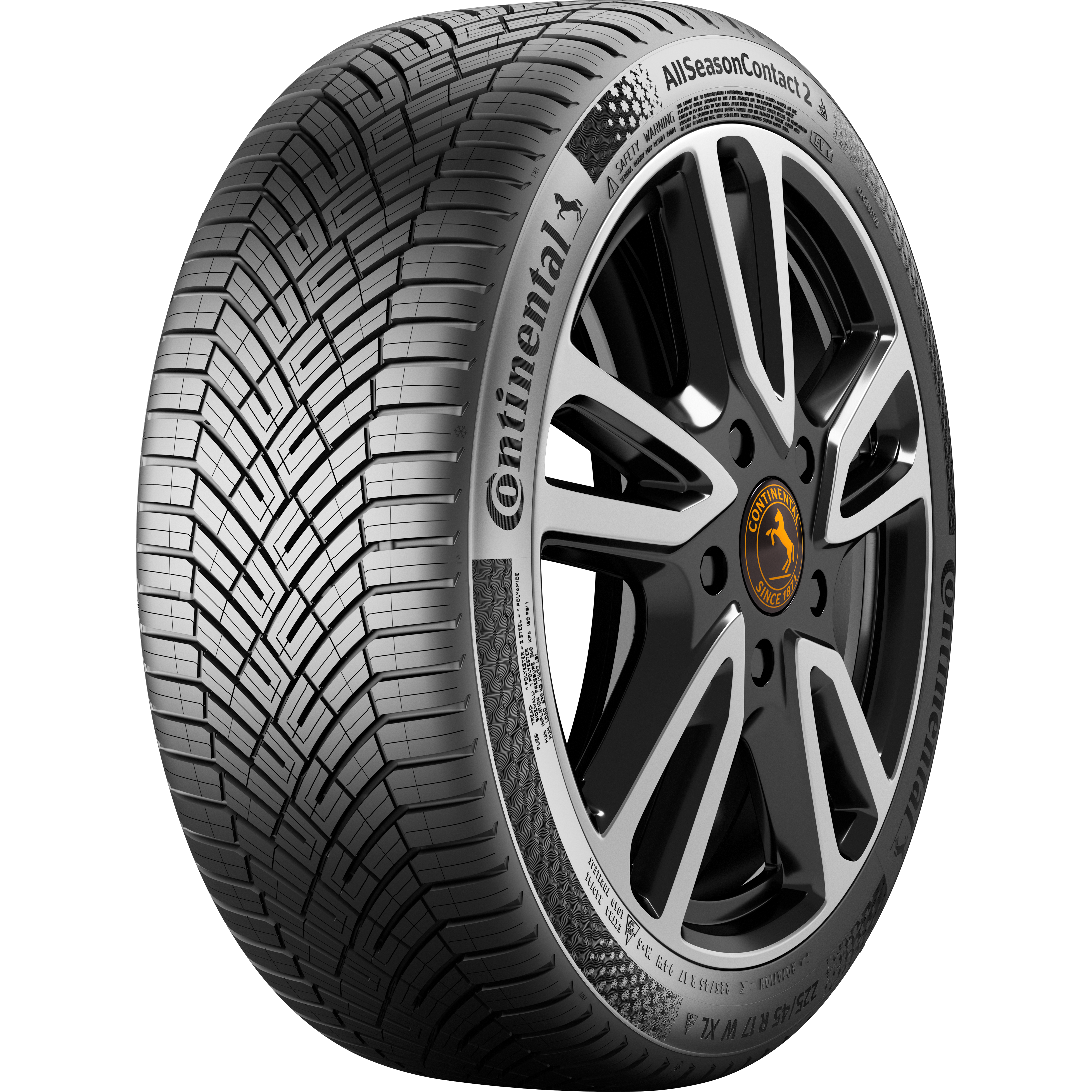

The latest Continental AllSeasonContact 2 is now available from mytyres in the slightly oversize 245/40R19. However, as it has only just come out the price may drop over the next month or two as other online sellers such as camskill also start to receive stock.
I can't see it listed in the standard 19" size yet, ie. 235/40R19.
Even if it's only a small improvement over the previous highly rated AllSeasonContact, it going to be very good.
Compared to the standard 235/40R19 size, the slightly oversize 245/40R19 has an outside diameter 1.2% larger...which is such a small change that you might not even notice the difference. Put another way, when the 245/40R19 has just 4mm of tread wear it will have exactly the same outside diameter as a new 235/40R19.
Outside diameter of tyres
235/40R19 670.6mm
245/40R19 678.6mm (+1.2%)
Continental AllSeasonContact 2 245/40R19 96Y XL (Euro label B B 71dB) (the tyre size shown in the below photo is a slightly smaller 225/45R17)
https://www.mytyres.co.uk/rshop/tyre/Continental/AllSeasonContact-2/245-40-R19-98Y-XL-EVc/D-128031
