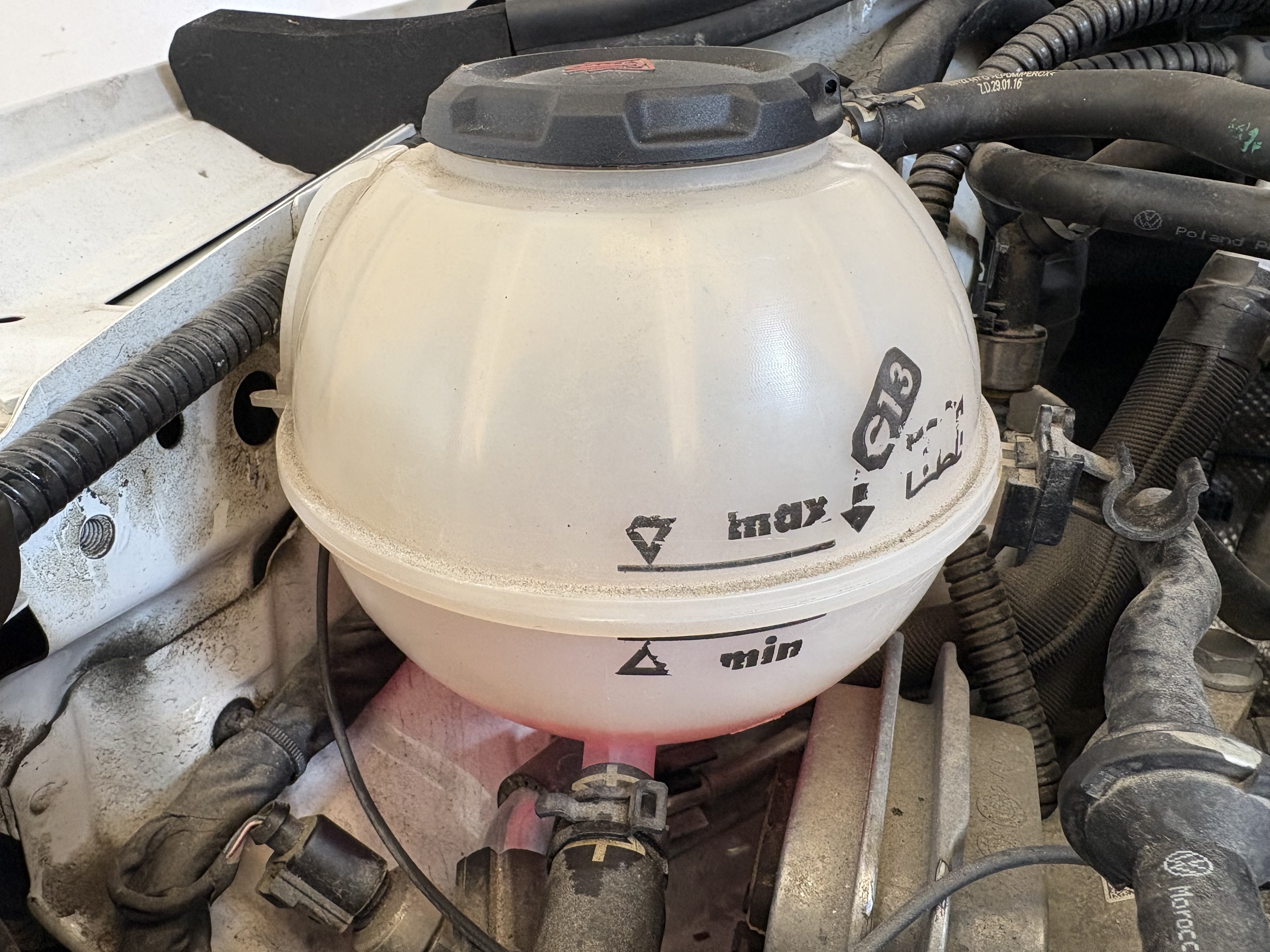

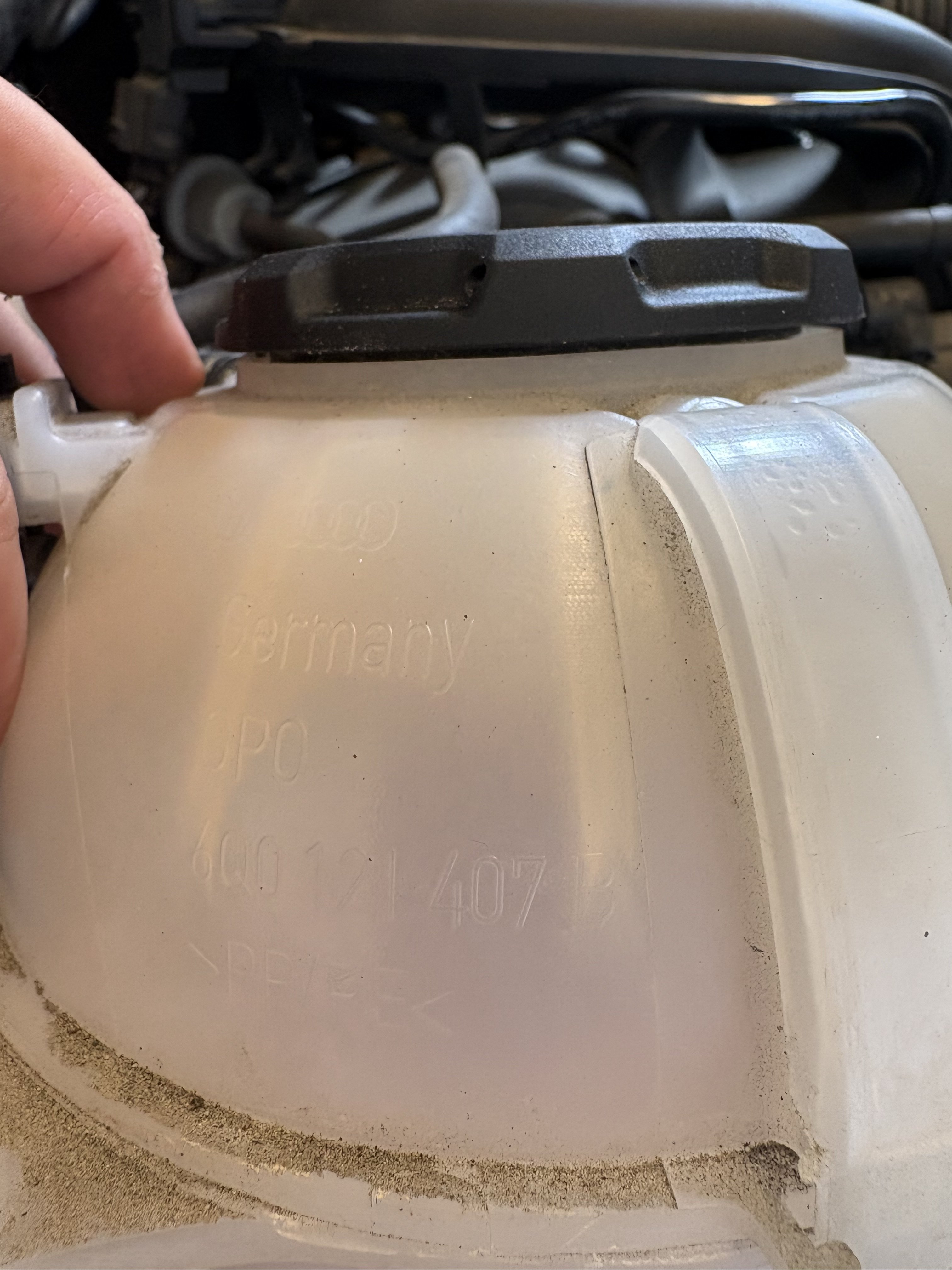

Expansion tank contains silica? Skoda Fabia 2018
Hi, I have just unplugged to check if my Skoda Fabia 2018 1.0 TSI expansion tanks contain silica so as to replace it with silica free and completely change the anticoolant from G13 to G12evo. The OEM number is 6Q0121407B. Attached are the photos. I have asked three AI engines but all say is silica free. I just wanted a second opinion so as to proceed with only anti-coolant change to G12evo. PS. the level of coolant is low because I sucked out a bit in order to be easier to unplug to check the OEM.

Coolant tank replacement - Should I be worried?
One thing that I will add, if you are keeping this car for "a while", if it still has G13 coolant in it, it should get replaced with G12 EVO as it was only G13 that needed the Silicate pouches to add Silicate back into the coolant as it was being depleted in use, especially with certain engines/temperatures. G12 EVO does not need this which is why "Mit Silikat" has disappeared from newer VAG car reservoirs. Some people will say that it's easy to work out which coolant is in the system by checking its colour - I can't say that I'm 100% certain that I can/could, I've replaced the G13 with G12 EVO in both our cars - more due to the car's/coolant's age than anything else.
