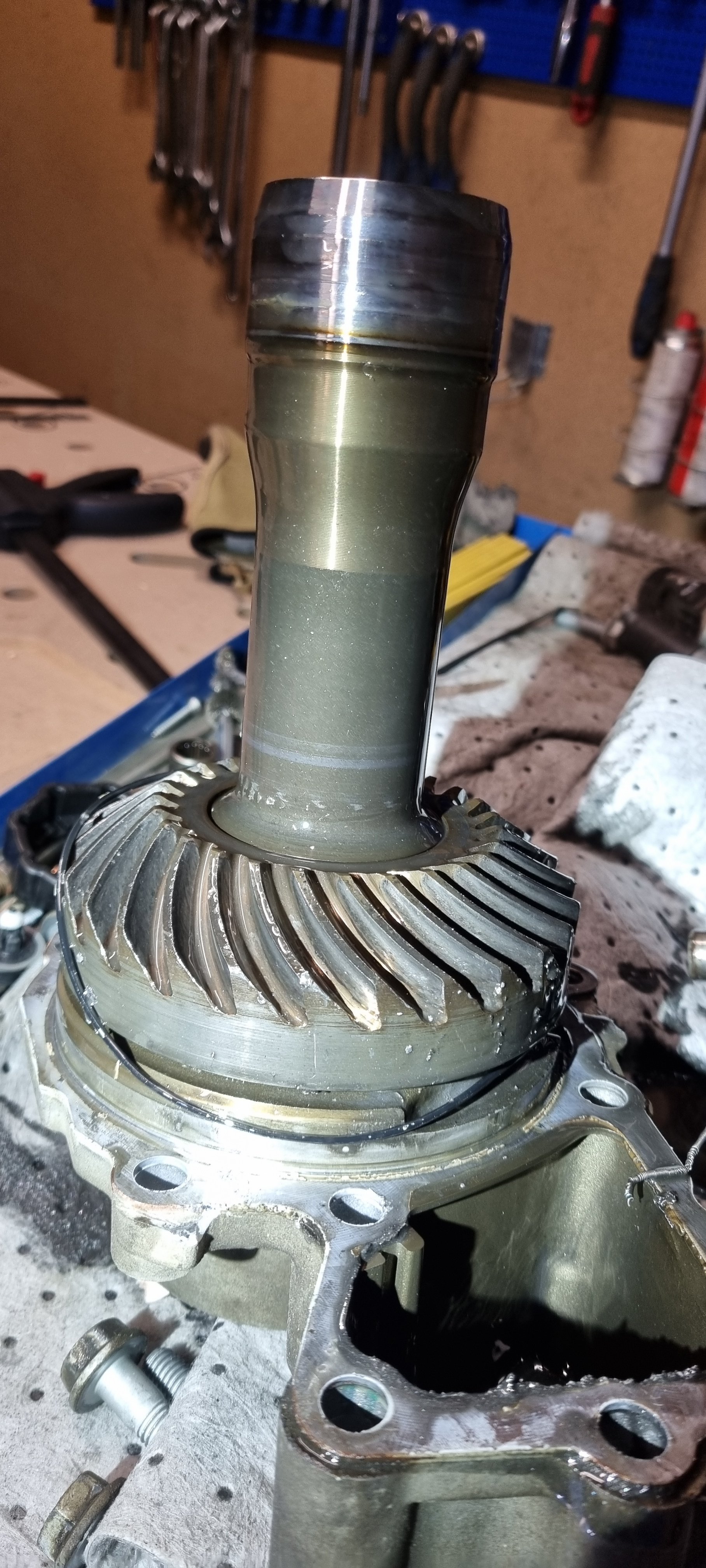

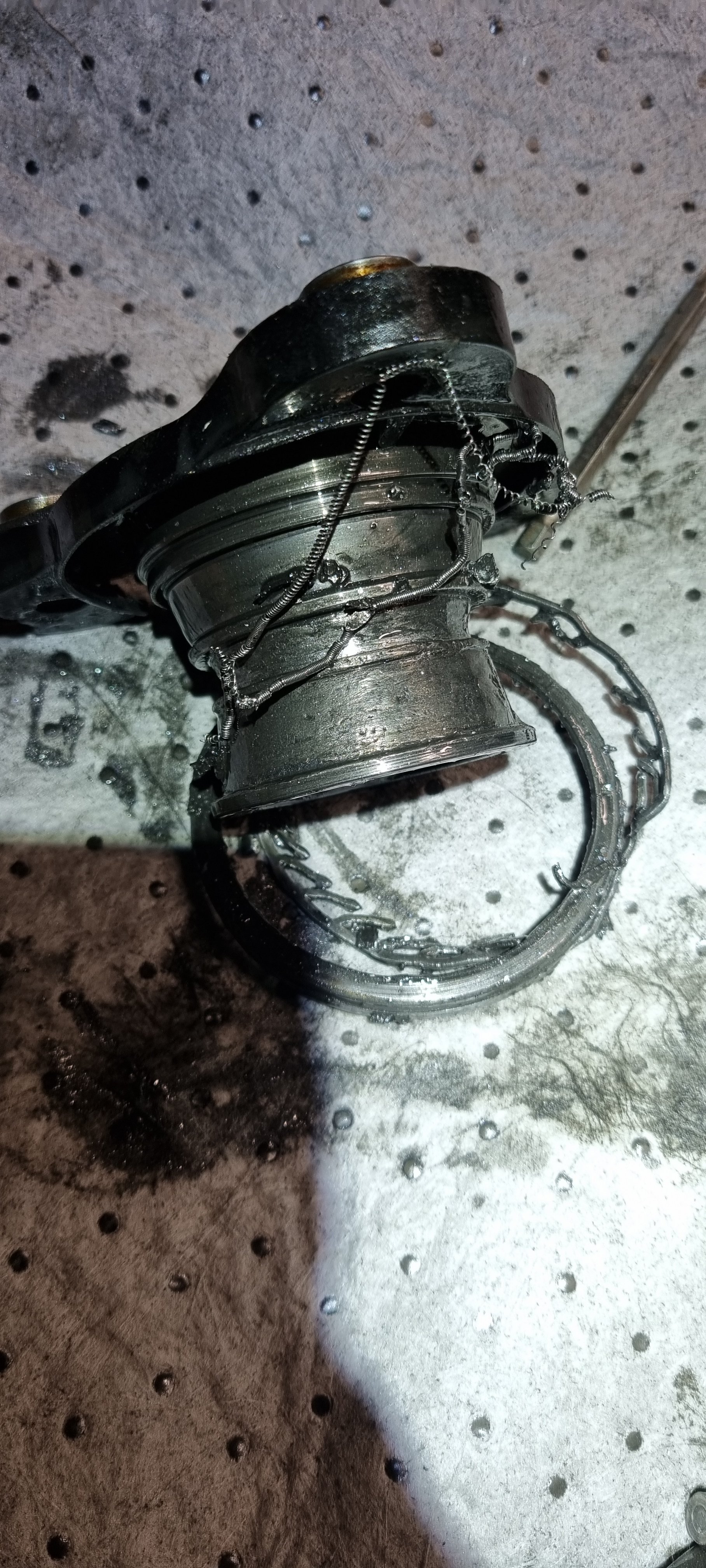

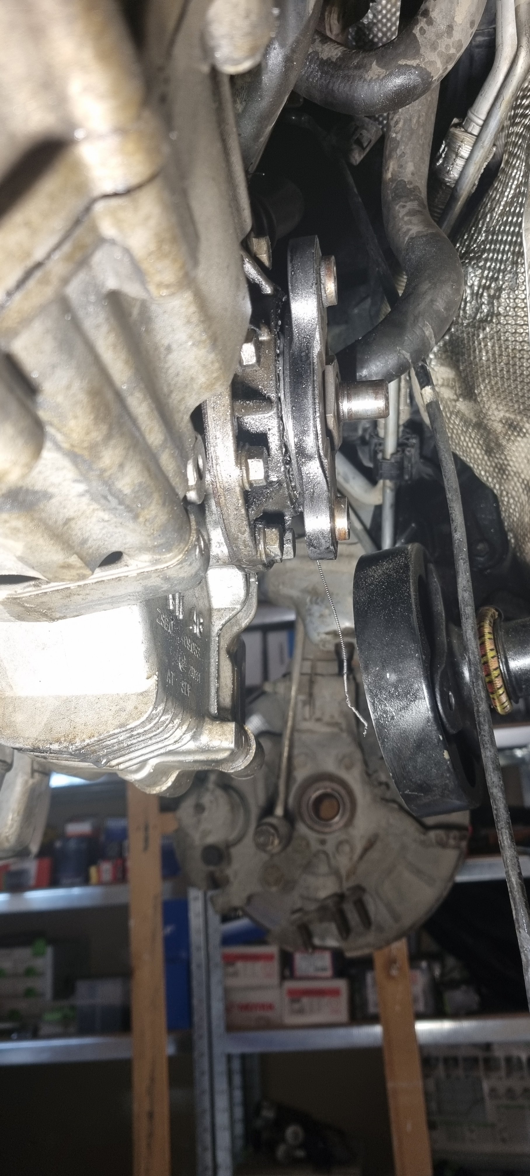

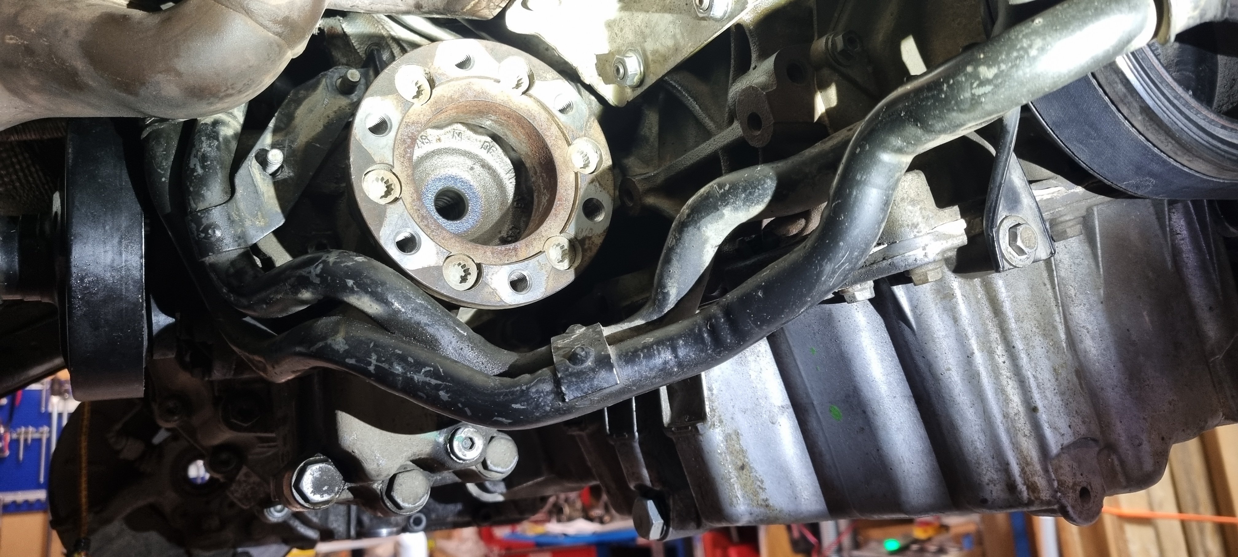

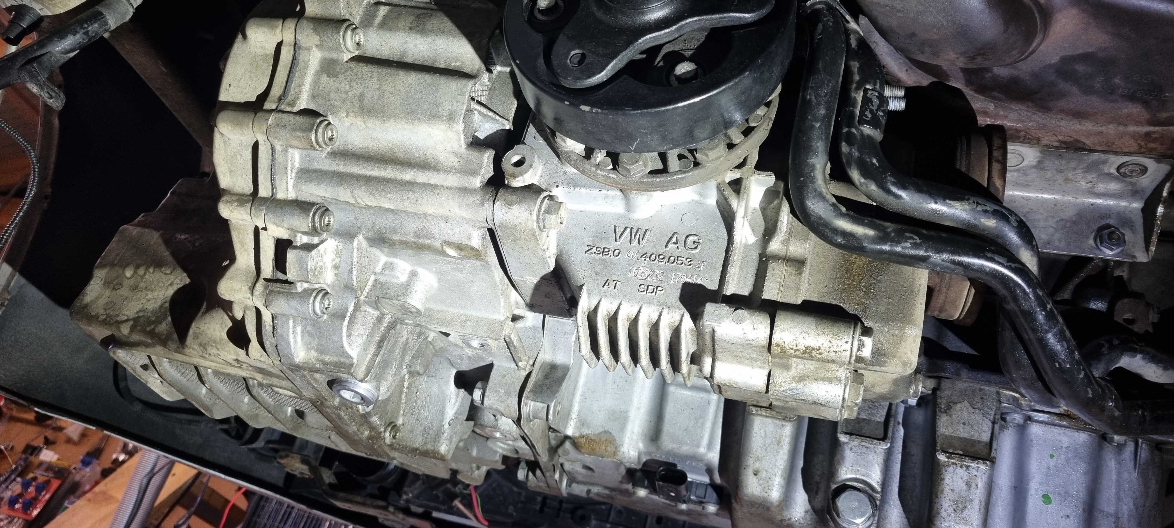

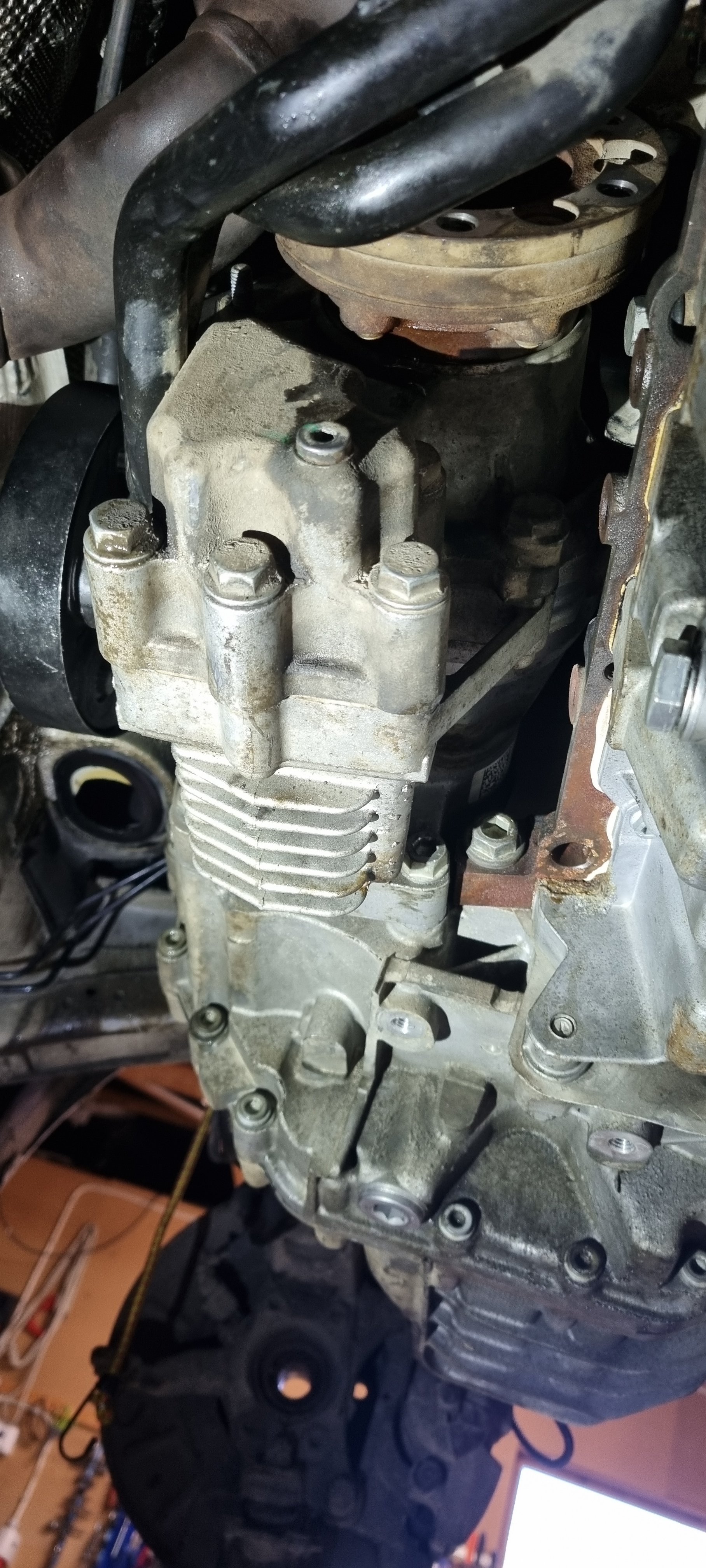

  38. New bevelbox/transmission arrived today. It was bolt on and after test drive, it is smooth!! To sum up, what tip is my best? Well, firstly, when working on transmission on a 4x4 tdi with DSG DQ250 and a webasto aux heater installed, 2 things really makes life easier. Take down the subframe. This gives you a lot of room. Take out DPF. With these 2 ****ers out, the rest is piece of cake. What tools saves money? Get a Sonic Insex 8mm ROUND head 140mm long. Partnumber: 83014008. This little ****er is a life saver!!! Buy locating guiding pins for the subframe. Using these will save you from doing a 4-wheel adjustment when subframe is assembled. Special tool partnumber is VW T10096. These are a no-brainer if you plan to do anything on your car infvolving subframe take-down. A looong 6mm hex bit socket, 355mm long. VW T10107A. This is used to undo the right bevelbox drive flange. On a DSG box, this has to come off in order to get the bracket loose. There is NO other way around it with tdi diesel and DSG DQ250 trans. Buy a Dremel like tool with metal cutter blades. Cut off the above mentioned famous bolt. Replace bolt with a shorter one, M10x1,5 threads. It is impossible to remove that on 2.0tdi with DSG DQ250 if not cut OR if you prefer to take down the whole DSG, be my guest, because that is what VW manual says. Cut it and replace, then remove bevelbox in-situ. Saves at least a couple of hours. Prybar. Use it to take out right bevelbox flange axle (goes all the way through the bevelbox) XZN (spline) 10 bits that has a 100mm long shaft. Makes it easier to take out 6 spline bolts on drive shaft. A lot easier actually. Good luck! So, my old bevelbox 0AV 409 053T is now garbage and the new slightly used (123 000km from 2014) 0AV 409 053AF is now operational. I estimate just replacement in situ to be approximately on my car is 4h of work on a scissor lift/lying on the floor. With 2 post lift a lot faster.

  40. Updated today. New bevelbox/transmission box aquired from used carsale. Approx 300gbp shipping included. OE partn 0AV 409 053 AF. So starting today to take out and down the old bevelbox.
