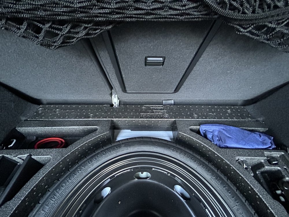

  22. My 2023 4x4 Sportline was supplied from the factory with the 125/70 R18 space saver. See photo below - the 135/80 might be too big to fit in the polystyrene storage that goes around the spare wheel.
