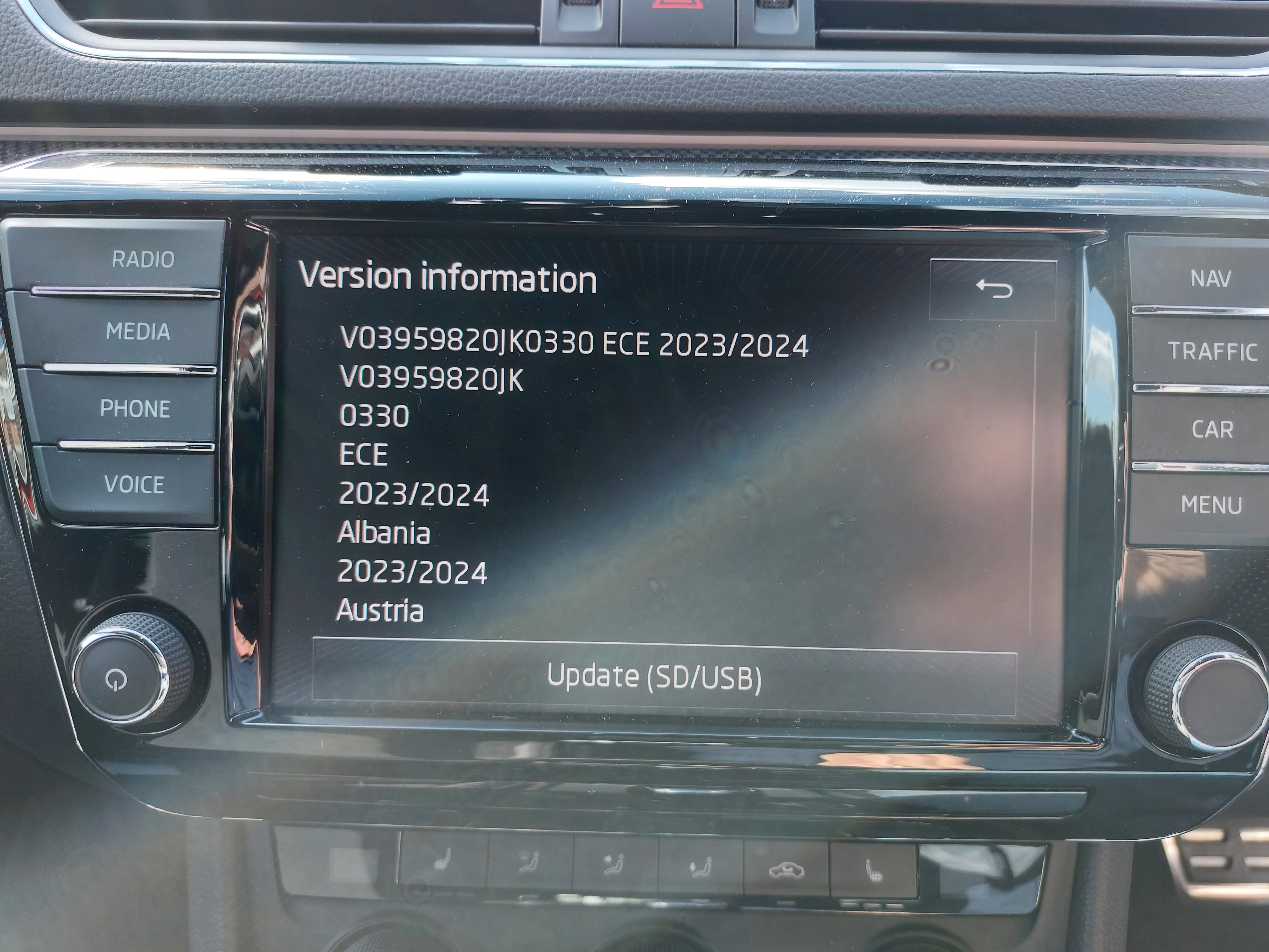

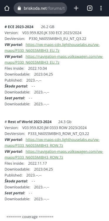

# ECE 2023-2024        26.2 GB
Version:    V03.959.820.JK 330 ECE 2023/2024
DevVersion:    P330_N60S5MIBH3_EU_NT_Q3.22
VW portal:   https://vw-maps-cdn.lighthouselabs.eu/vw-maps/P330_N60S5MIBH3_EU.7z
VW portal:   https://navigation-maps.volkswagen.com/vw-maps/P330_N60S5MIBH3_EU.7z
Files inside:    2022.10.04
Downloadable:    2023.04.25
Published:    2023.--.--
Škoda portal:   https://infotainment-cdn.skoda-auto.com/base/maps/HIGH12_P330_EU_202322.zip
Downloadable:    2023.06.02
Published:    2023.06.0?
Seat portal:    - -
Downloadable:    2023.--.--
# Rest of World 2023-2024       24.3 Gb
Version:    V03.959.820.JM 0333 ROW 2023/2024
DevVersion:   P333_N60S5MIBH3_ROW_NT_Q3.22
VW portal:   https://vw-maps-cdn.lighthouselabs.eu/vw-maps/P333_N60S5MIBH3_ROW.7z
VW portal:   https://navigation-maps.volkswagen.com/vw-maps/P333_N60S5MIBH3_ROW.7z
Files inside:    2022.11.17
Škoda portal:    - -
Seat portal:    - -

======= instruction =======
1. download 7z/zip archive from direct link
2. extract content to SD Card or USB
3. insert memory device into slot of Columbus
4. start of update usually is offered automatically, manually can be found under Navi-> Settings

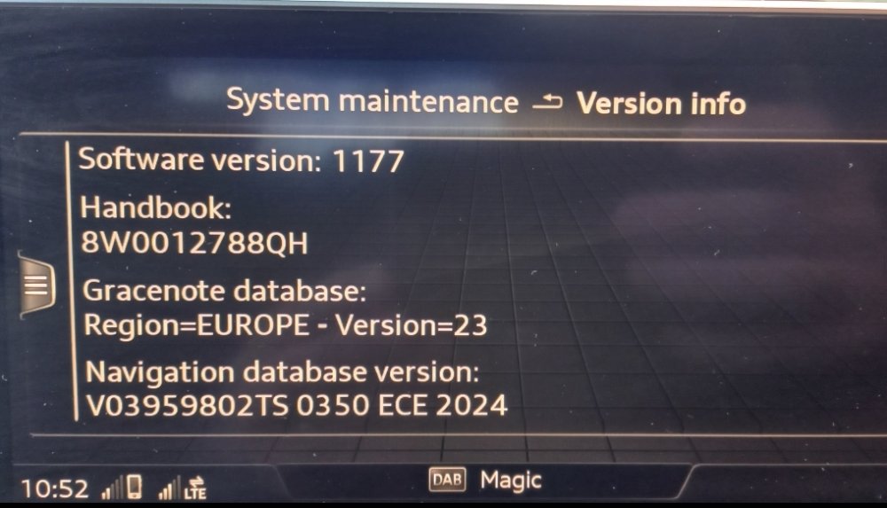

Update to 2024 was successful It took 25mins via USBScreenshot_20231015_105444_Gallery.thumb.jpg.b15a22af3215661a1f38941012bbf504.jpg
Edited by BooBoo124

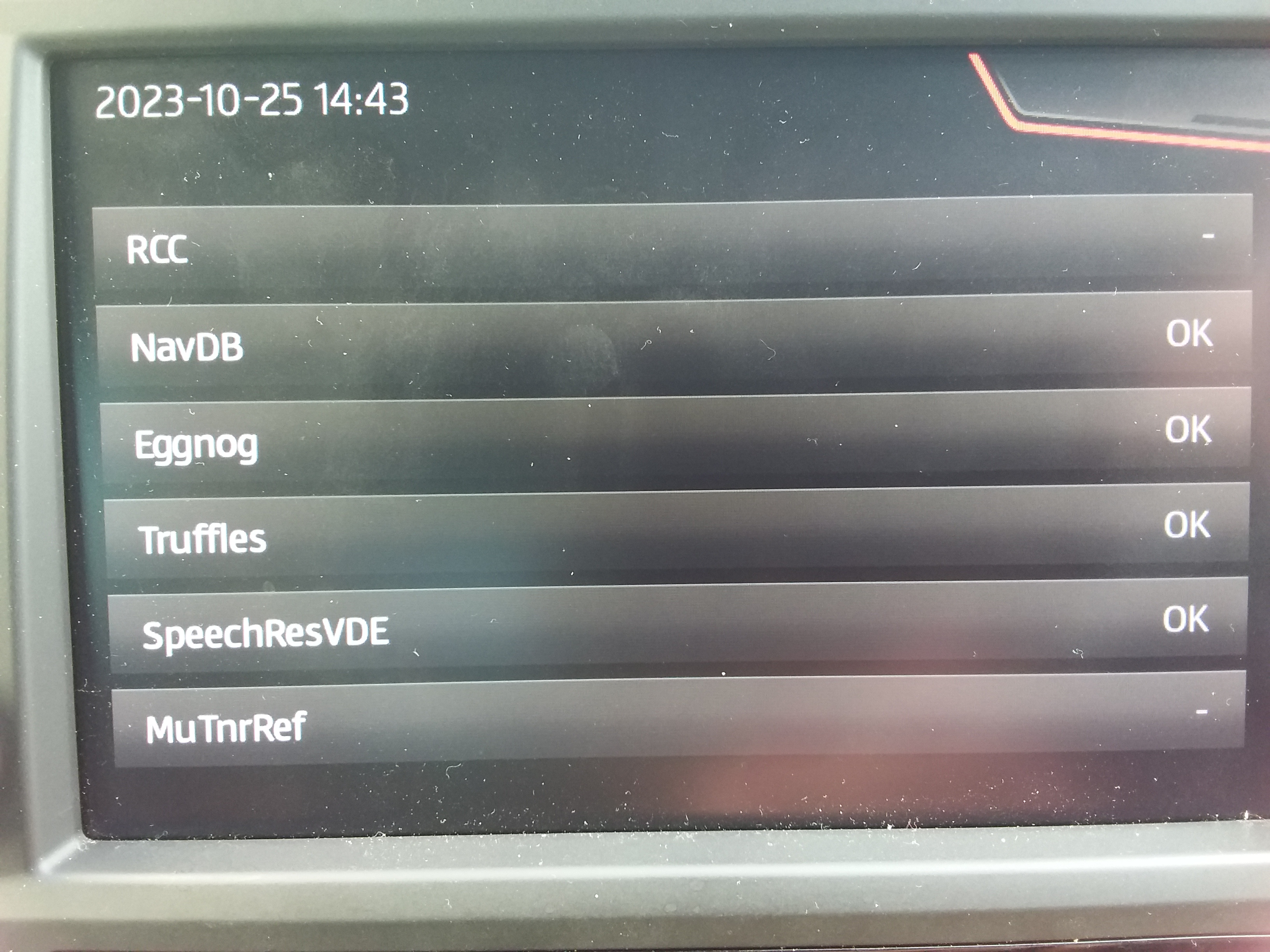

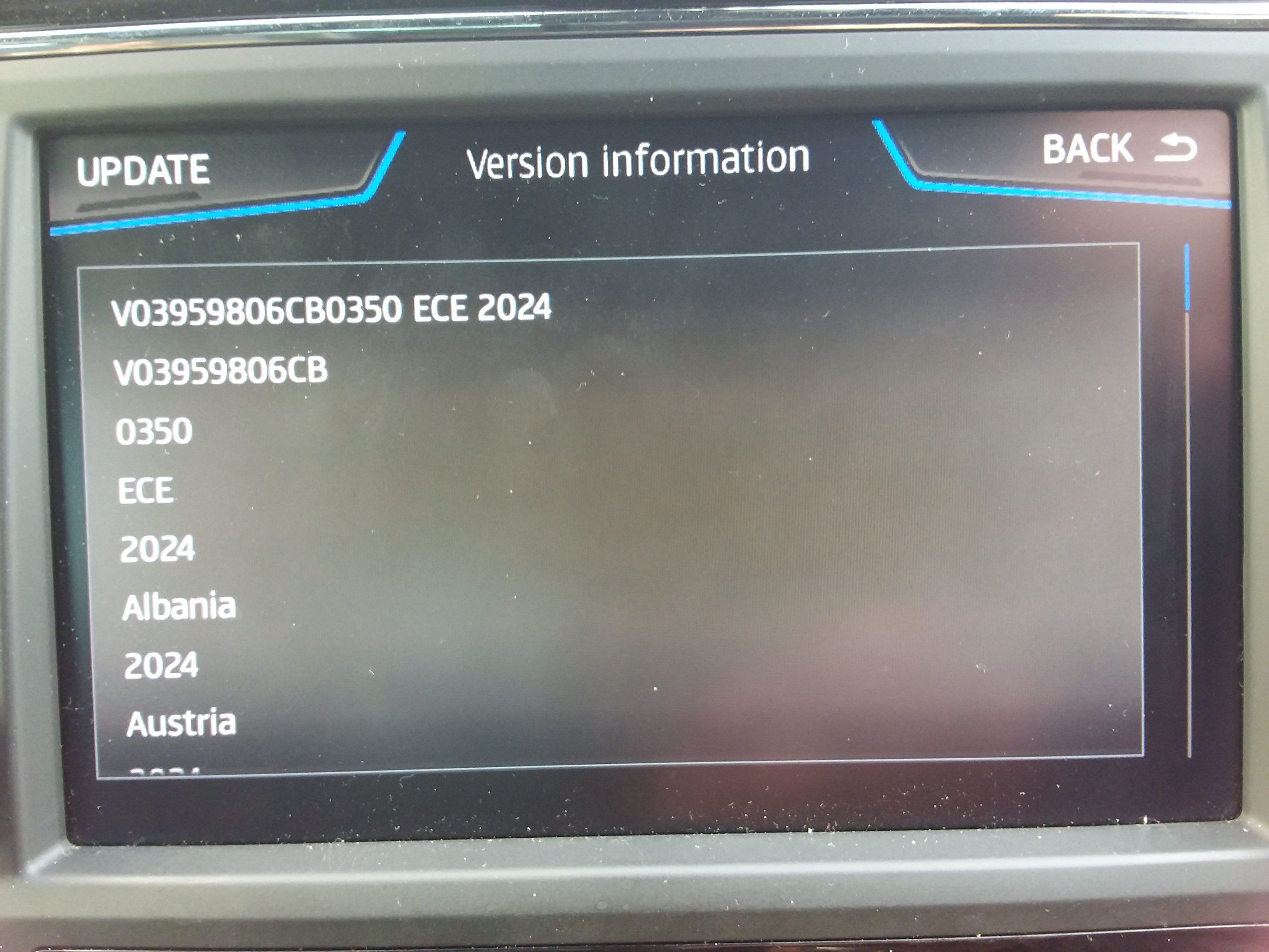

350 via the Mibsolution website loaded fine on a Seat:
The components loaded fine as per the SWDL screen:
Put it on demo and took a run... No problems.
