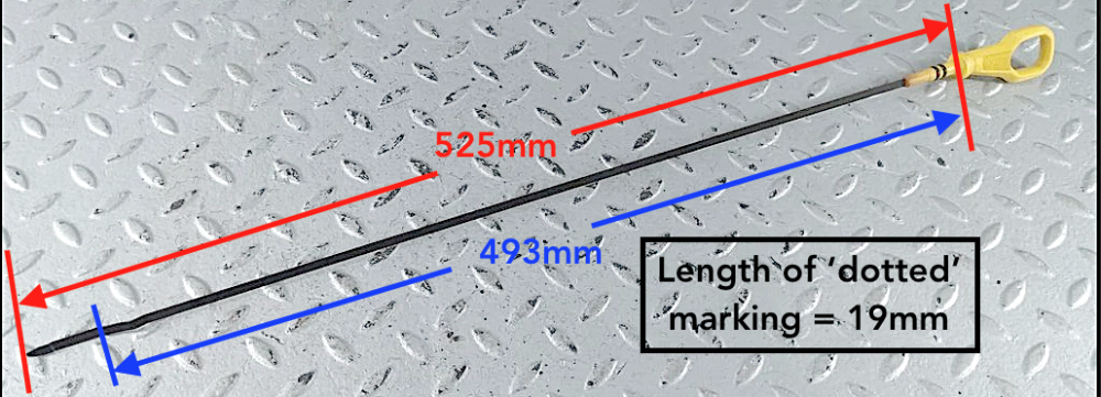

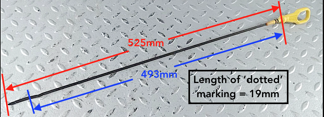

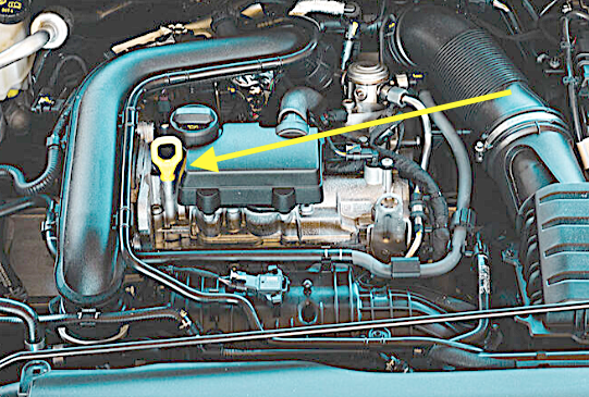

  2. Fabiamk4man (who originated this topic) owns a Fabia Mk4 "Style" model built in December 2022 that he purchased (in Greece) in September 2025 when the vehicle had covered 28,000km. The car has a TSI 1.0litre motor producing 110PS and, although the "Style" trim designator was not used in the UK, the motor's capacity and power-output of his car are the same as those of my own similar-age UK-marketed Fabia Mk4 SE L model. Photos of the engine compartment of Fabia Mk4 cars fitted with that motor show the position (and yellow colour) of the dipstick 'handle' (arrowed on this image). As I said earlier, the angled design of the yellow handle means that the dipstick can only be pushed fully home when the handle is leaning towards the car's front. However, it is possible to establish that the dipstick's tube is straight (rather than curved) as the dipstick can be turned through 90° and still be easily inserted until the angled handle prevents it going any further. Online photos/adverts indicate that the dipstick normally has a 'dotted' oil-level marking section towards its end that matches the drawing in Fabia Mk4 Owner's Manuals. Just for the record (and assuming that my own Fabia's dipstick is the correct one!!!) I've measured my car's dipstick and its critical dimensions are shown on the image below. To make that abundantly clear - the distance from the underside of the yellow handle to the dipstick's end is 525mm - the distance from the underside of the yellow handle to the start of the dotted oil-level marking section is 493mm - the overall length of the dotted oil-level marking is 19mm, meaning that the dotted oil-level marking section stops 13mm from the end of the dipstick.
