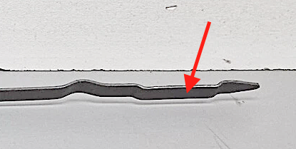

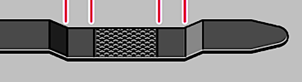

I happened to come across this 2019 BRISKODA Karoq-related topic https://www.briskoda.net/forums/topic/463124-dipstick-question/ I doubt this has any relevance to the dipstick of the Fabia Mk4 car owned by @fabiamk4man but it MIGHT still be worth emphasising which side of the dipstick the 'dotted' oil-level section should be on. These two images should make this clear...
