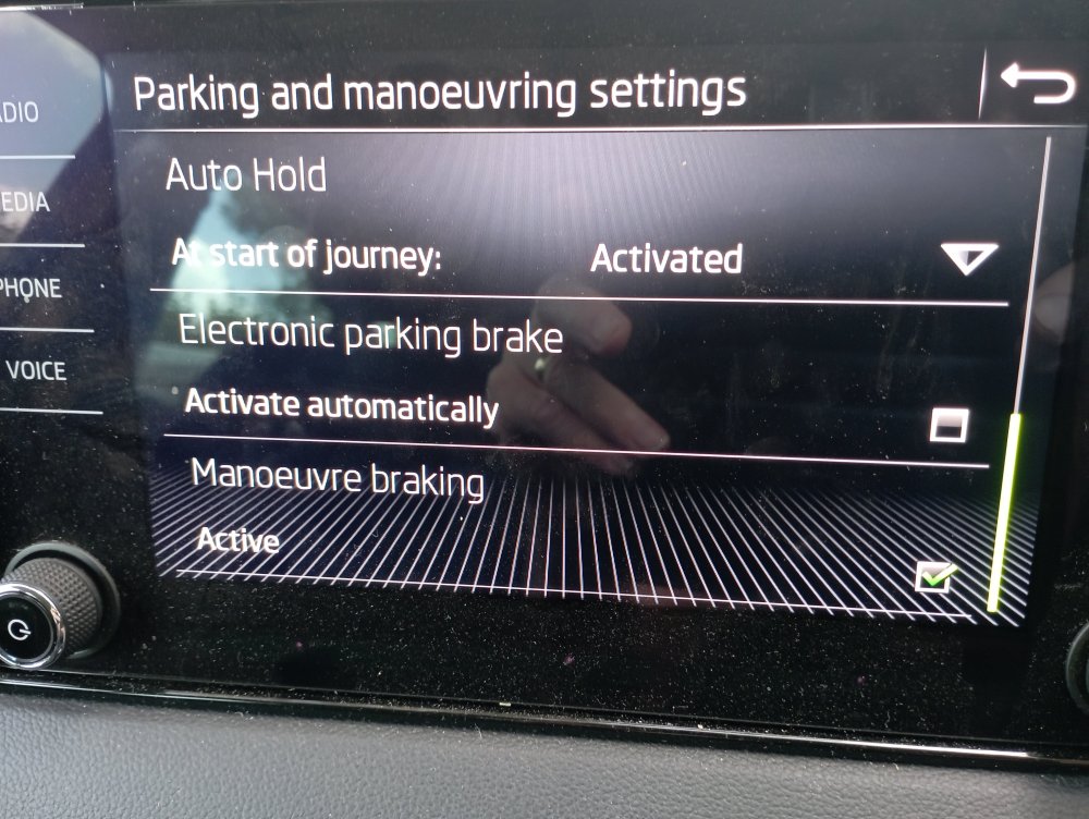

That sounds like there may be a sensor fault preventing the activation. IIRC Seat belt & drivers door switch are involved, are they working ok ?

Thank you for the reply Auto hold is activated. But if I press to try and change it. I get the same message " this function is currently unavailable"- Enyaq clicking noise

Check that Auto hold is still enabled. IIRC The automatic parking brake only engages, on ignition off, if auto-hold is enabledNottsIan started following Automatic electronic handbrakeamine joined the community- Searching for the correct coding for 5F: Information Electronics after changing the sound settings with Car Scanner

automatic electronic parking brake. Parked the car as normal but left it in gear as I always do. Returned to the car pressed the clutch to take the car out of gear and start the car. Car started to roll forwards. Braked to stop the car. Then drove away. Next time I stopped I noticed that the automatic handbrake not working. Went into settings no tick in the box for automatic handbrake so tried to turn on the automatic handbrake but get the message “This function is currently unavailable” Any suggestions please Handbrake working correctly manually.- the truth about electric cars
