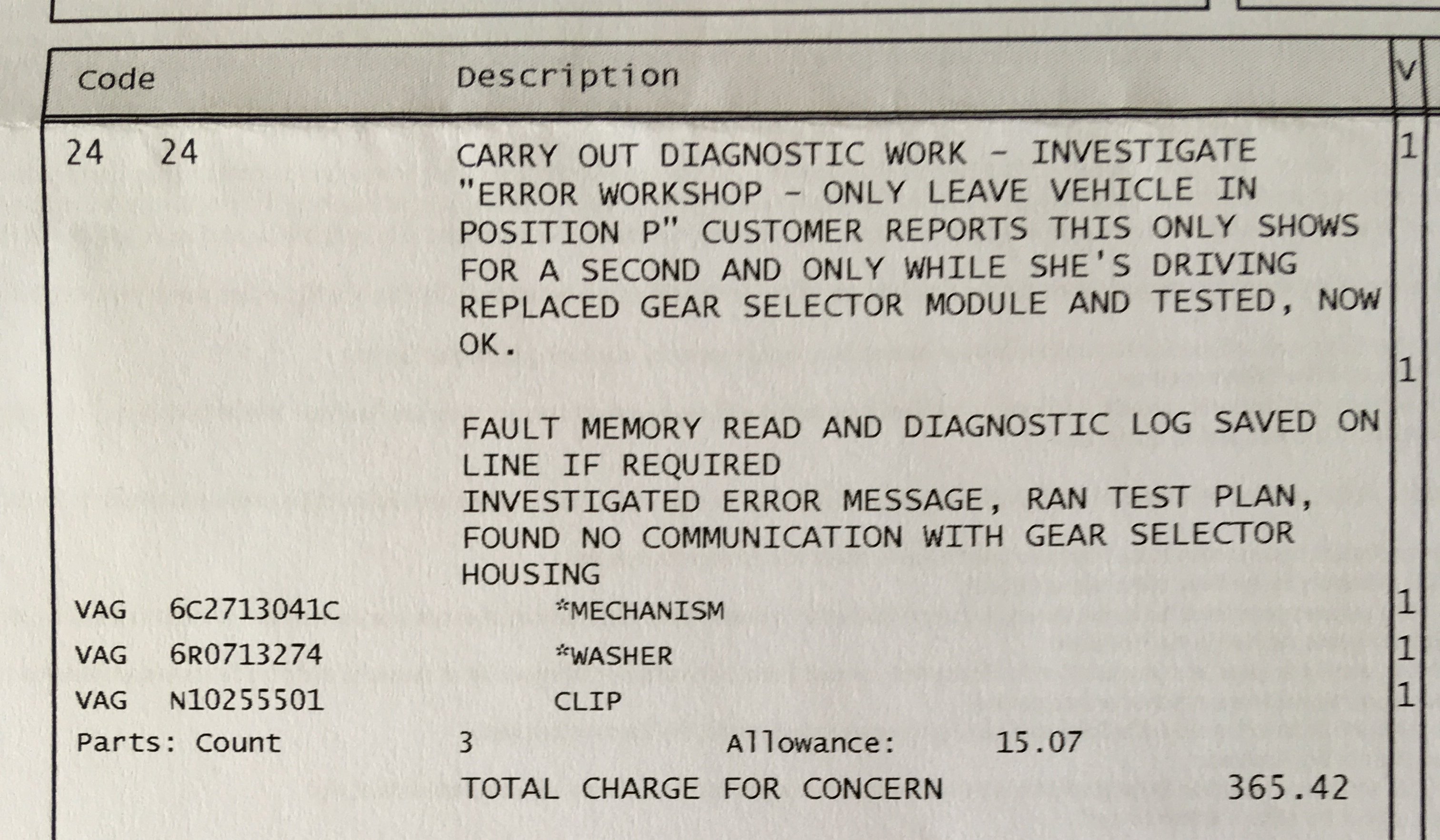

My Wife's 65 plate Polo GTI has just gone in for this today.  Still within warranty thankfully.
Local VW said they've 'never seen this before'. Yeah right :thinking:

Haha lol we have seen more than a few of these at our garage!
