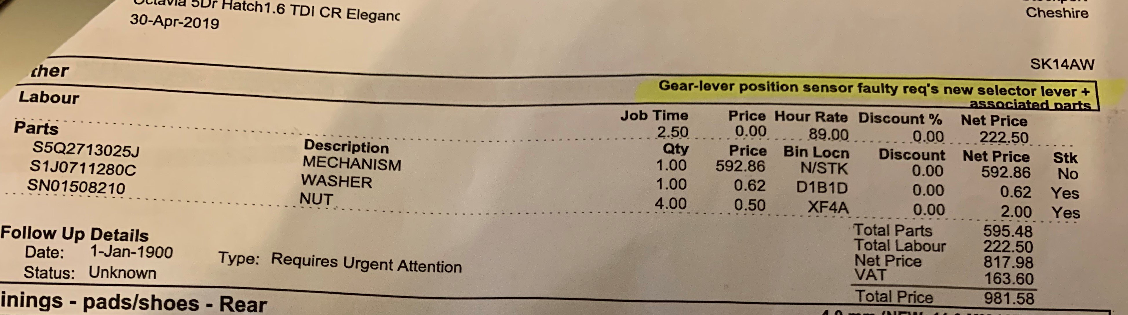

Having the same issue... My octavia has only done 44k mile and out of warranty now 😞
This is what I have been quoted for the repair at Skoda in Stockport...! No way can I afford this. I cant believe its such a common fault and Skoda are not doing a recall.... Ridiculous
What year is your car?
Do you have full dealer service history? Ask for some goodwill contribution. It's a common issue as per this thread and I'd be surprised if you couldn't get some contribution via the dealer or via Skoda UK.
@true247spartan - I presume the nut and washer are made from unobtainium based on these prices? 😕
It looks like it! Talk about dropping your pants and bending over.... pardon the expression...
