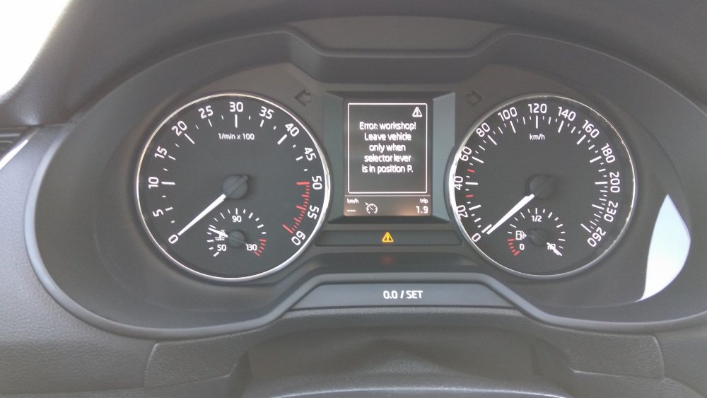

Save the photograph from this thread and print it out.

I have downloaded photograph of the internet and it was sufficient for my garage to replace it under warranty. Tell them that it also pop up while you are driving on the motorway and it is a health and safety isssue. It worked for me :)

My dashboard is different then that one in the photo!!!
