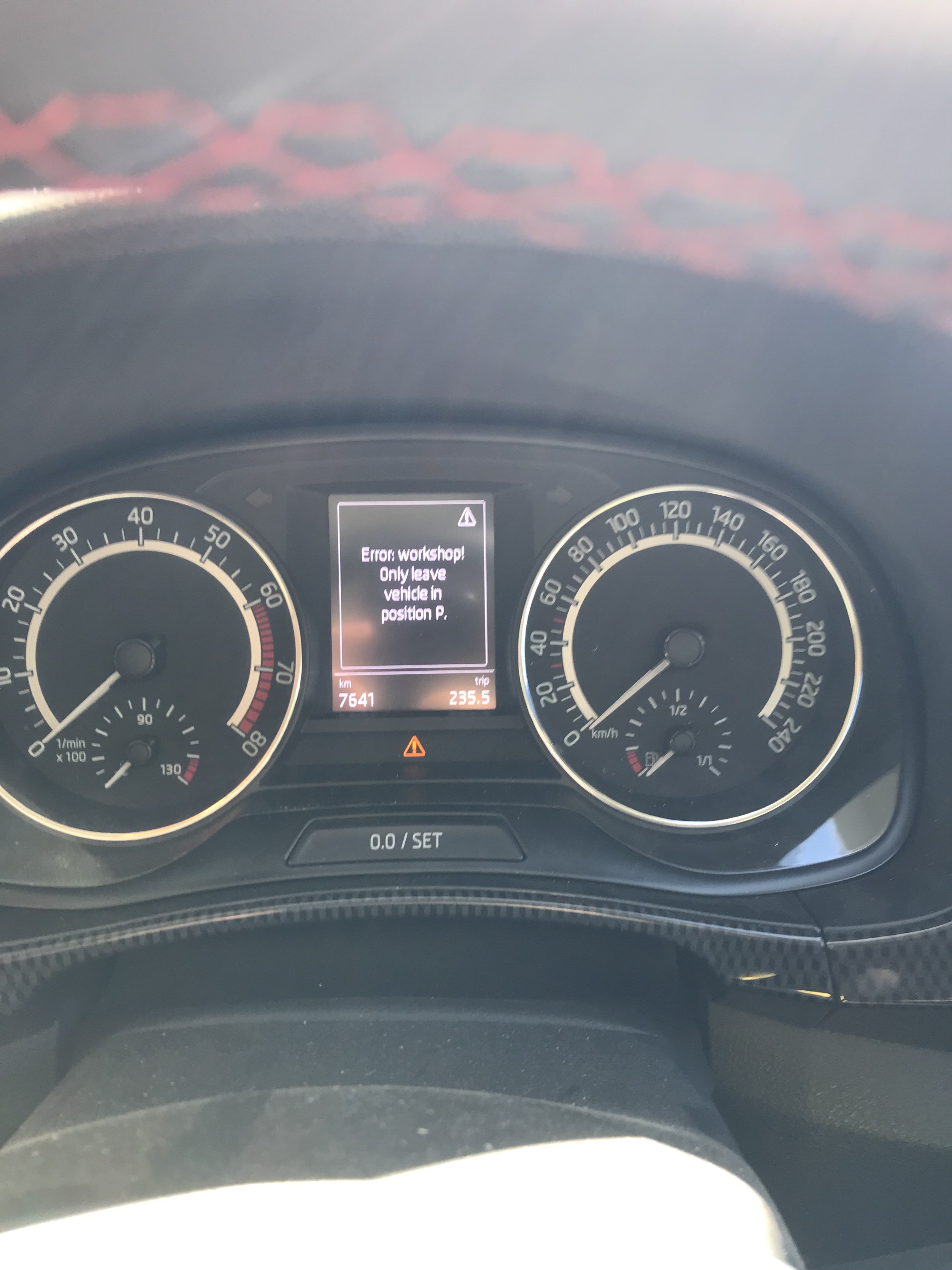

Something tells me I won’t be the first person to ask this question, but...hasn’t Skoda sorted a fix for this old chestnut yet?!
I had this error pop up today for the first time on my now 4 month old Fabia. So it’s clearly not sorted by the vw group yet.
For me though the problem was even worse. As while this error was being displayed, I could not lock the car.
The remote, the button on the door (keyless entry) and the physical key slot in the door all refused to allow me
to lock the car.
For now the message has gone and the car is behaving as if nothing happened.
When it it happens again as I’m sure it will, I’ll try to get a pic of the display and go to my dealer.
Will be a a warranty issue no doubt. But still a hassle on a brand new car with less than 5000km on it.
I will I’ll keep this updated.
Jason.

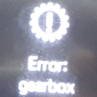

Hello
I just joined the forum to comment on this thread. ALL Seat Toledo's including mine plus Leon's, Octavia's, and Rapid's WILL get this error at some point. All these cars have the 1.6 MPI 6 speed tiptronic power and drive train. I think even the new Tiguan probably have it too, although different drive train.
Here in Egypt we have the worst customer service in the world so that's that. Regarding VW group from what I have seen they don't give a **** about customers, you send them complaining from the local dealership they reply go solve it with them.
Yes the error appears in many forms. "Gearbox error", "Error service: leave vehicle only when selector in position p", and "gearbox in emergency mode you can drive on" all appear randomly with the yellow warning.
The most common is the second message appearing for a second at first then reaching the point it will stay until you turn off the car and turn on again a couple of times to clear.
That said the car drives completely normally no effect on performance whatsoever. That's why a lot of people don't take it seriously. Until there is an actual problem with the gearbox and you disregard it and you get screwed.
My car changed the whole selector mechanism TWICE under warranty (cost of piece only from VW to dealer is nearly 2000 $) with a lot of hassle and recently it started to show the message again, once till now so I guess it will need to get changed a third time !!!
