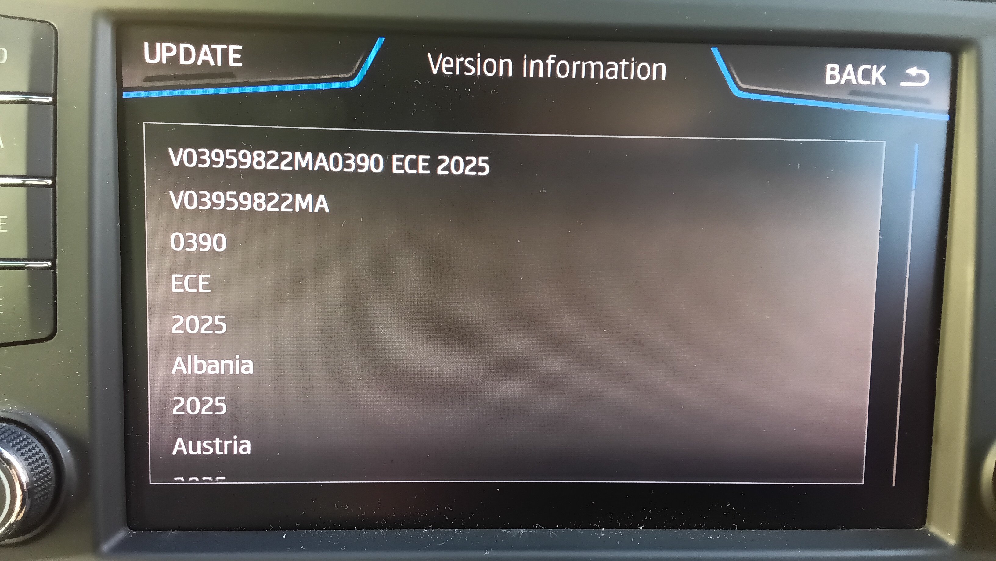

Customary success screen on a Seat mib2 high. Thanks @MartiniB. This thread seems to hide itself... oh well.
