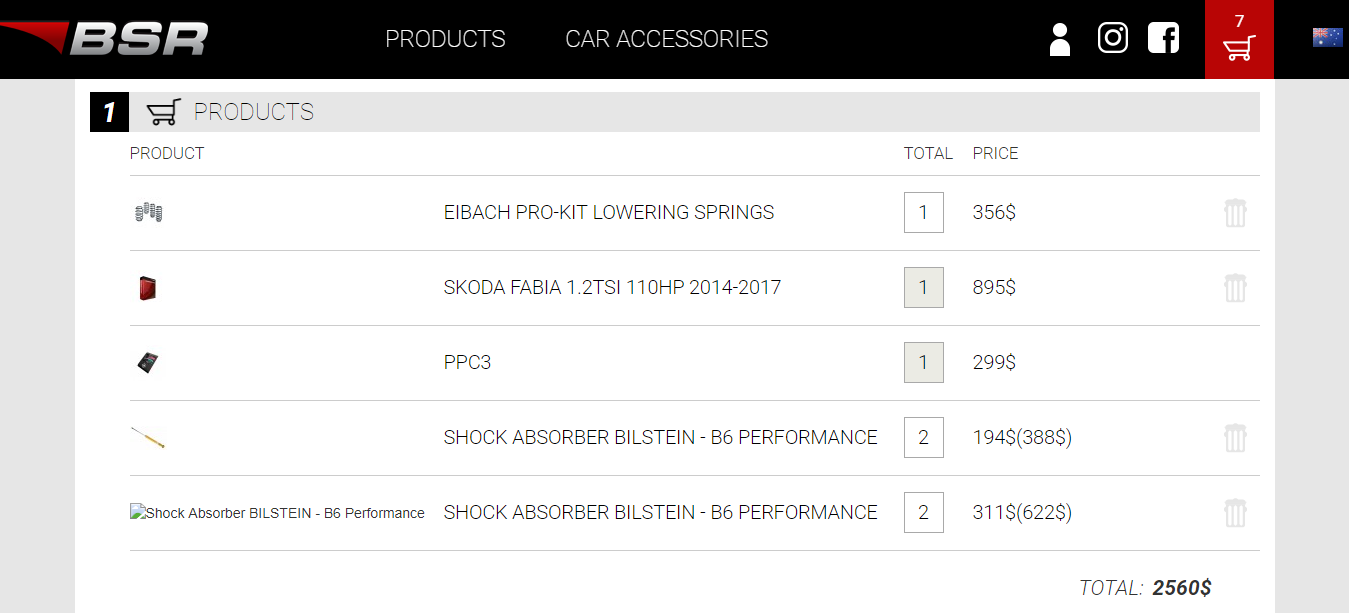

Apologies for the delay in response - just got back home from work, and having dinner with family.
Oh that makes sense! My odometer is currently reading 24,876km so it isn't exactly in 'new' condition...
Though, if the shocks were to fail later on upon installation of the Eibachs, which would be a better investment?
  • Eibach Lowering Springs with Bilstein shocks, or just upgrade to Coilovers overall? [both would be ~$1300 for me]
  • Purpose is purely aesthetics, and I don't really frequent track days at all [yet] - Also this is my daily driver haha..
Oh and good pickup! I realised I made an error - I'm actually running the following specs:
  • Engine: 1.2L DSG making 110hp/ps
  • Tyres: 215/40 R17s [my bad]
Thanks for the heads up regarding the LED's! I guess my main worry now is longevity - They SHOULD last longer than current halogens right?
After much consideration, I've decided against an engine swap, and at most, get an ECU tune from APR.
  • Plan after that, is to just save up for a Golf R and go crazy on mods for it haha.

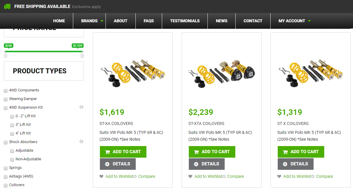

Would actually be better to just go for the Coilovers at that point.
Personally i would go Eibach, but that's my preference with previous experience and a few friends have their coilovers too.
Eibach: (£830)
https://www.dpmperformance.co.uk/car-parts/skoda/fabia/eibach-pro-street-s-coilover-suspension-kitfabia-nj-10-12t-si-14tdi-0814
ST by KW: (£585)
https://www.dpmperformance.co.uk/car-parts/skoda/fabia/st-x-by-kw-coilover-suspension-kitfabia-nj-20152019-10-12tsi-14tdi

Which ones did you get?
I went with the ST ones so no adjustments but tbf they are perfect. I thought about upgrading the shocks/struts but your on at least £500 for that and your stuck with one ride hight.
Defiantly wouldn’t recommend springs only as overall motorway driving is awful as well as I had a few very slight scrapes over speed humps because without stiffer dampers the car would compress the springs too much. As now it’s not scraped at all and our roads have some quite seizable speed humps.  This is my daily so I was after a mix of comfort and handling ultimately I think it’s more comfortable on rough or speed humps and transforms the handling in corners especially in the estate.

However, as I live all the way in Australia, shipping costs are absolute death, and there doesn't seem to be any Australian companies that stock the ST-X's for my Fabia.
  • The closest option that i could find, are for the MK5 Polo - sold for $1,319 AU + free delivery (Can it fit?)
  • Currently considering the following, Eibach Springs, with B6 Bilsteins for $1,366 AUD + free delivery.
  • Thus, Strut-Spring upgrade vs coilover upgrade HAHA OTL [I can't decide]image.thumb.png.f380ef96c69915fe3b1aeef44a0cd2f7.png

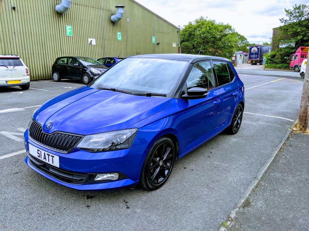

Coloured badges on, looks so much better!
I think that's it for me now. I'd like some bigger wheels but I just can't justify spending the money when the standard wheels aren't bad really. I was gonna have a remap done at some point but after learning the gearbox is only rated to 200Nm I think I'll leave it.
