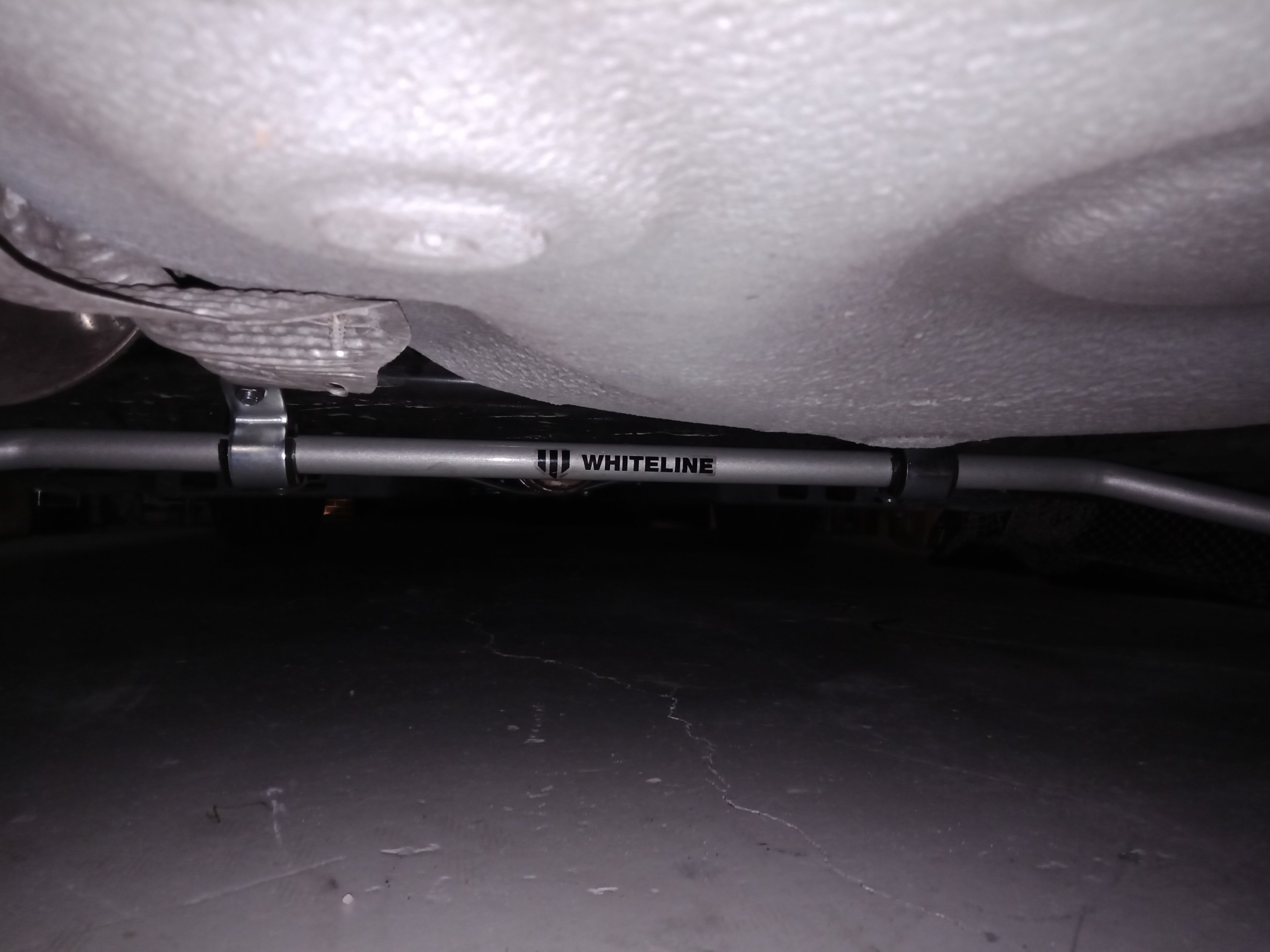

It also has Eibach lowering springs (absolutely brilliant and really happy I didn't go for coilovers), Forge intake, catback custom exhaust, stage 1 remap and 17 inch Team Dynamics with offset of 38 which pushes the wheels out just enough to give it a wider stance. Now considering a full downpipe with decat and then either stage 2 tune (circa 150 bhp) or a hybrid turbo which should get to about 180bhp
Sorry for the late response - life has been pretty hectic lately so haven't had the time to respond haha

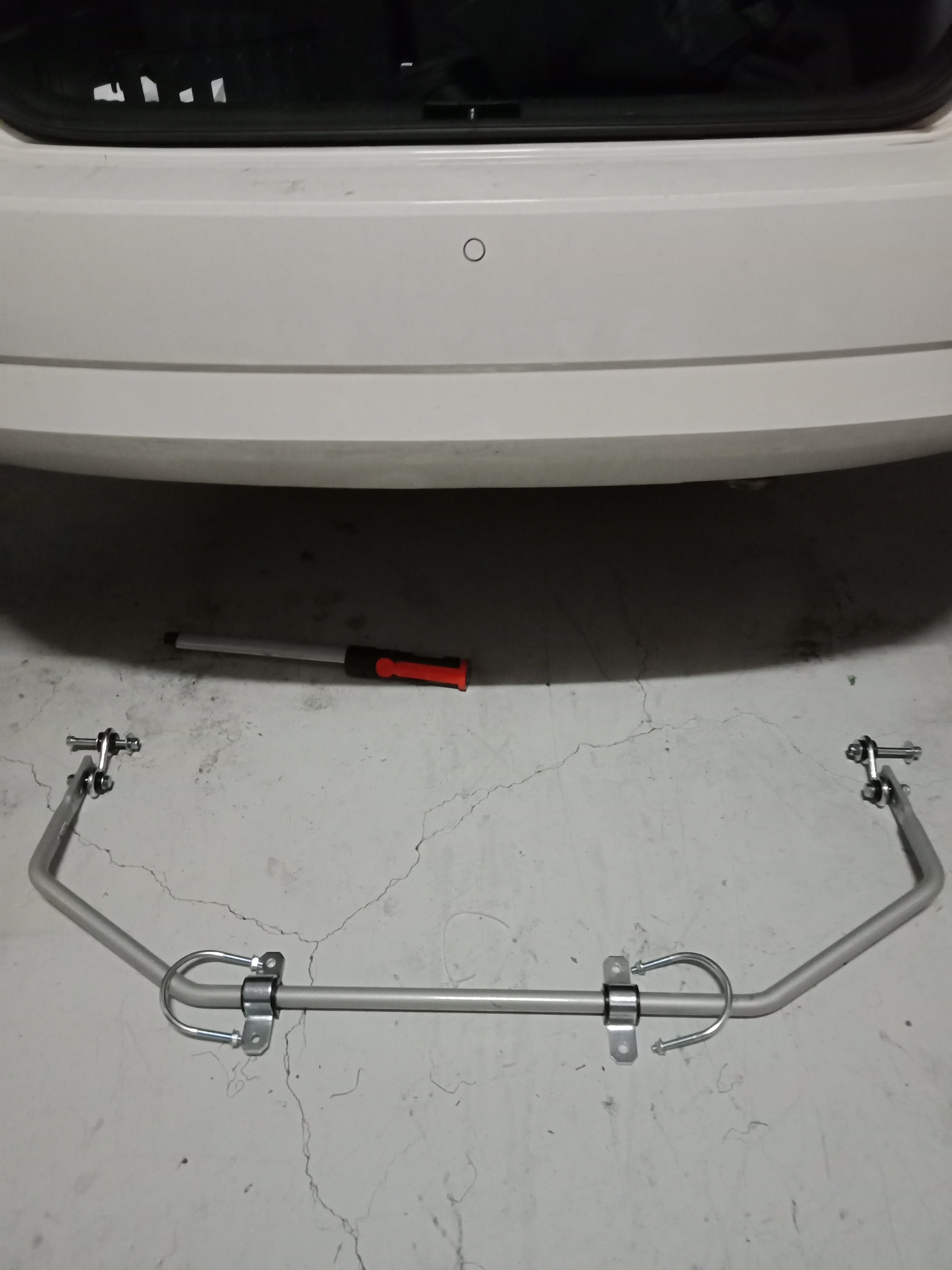

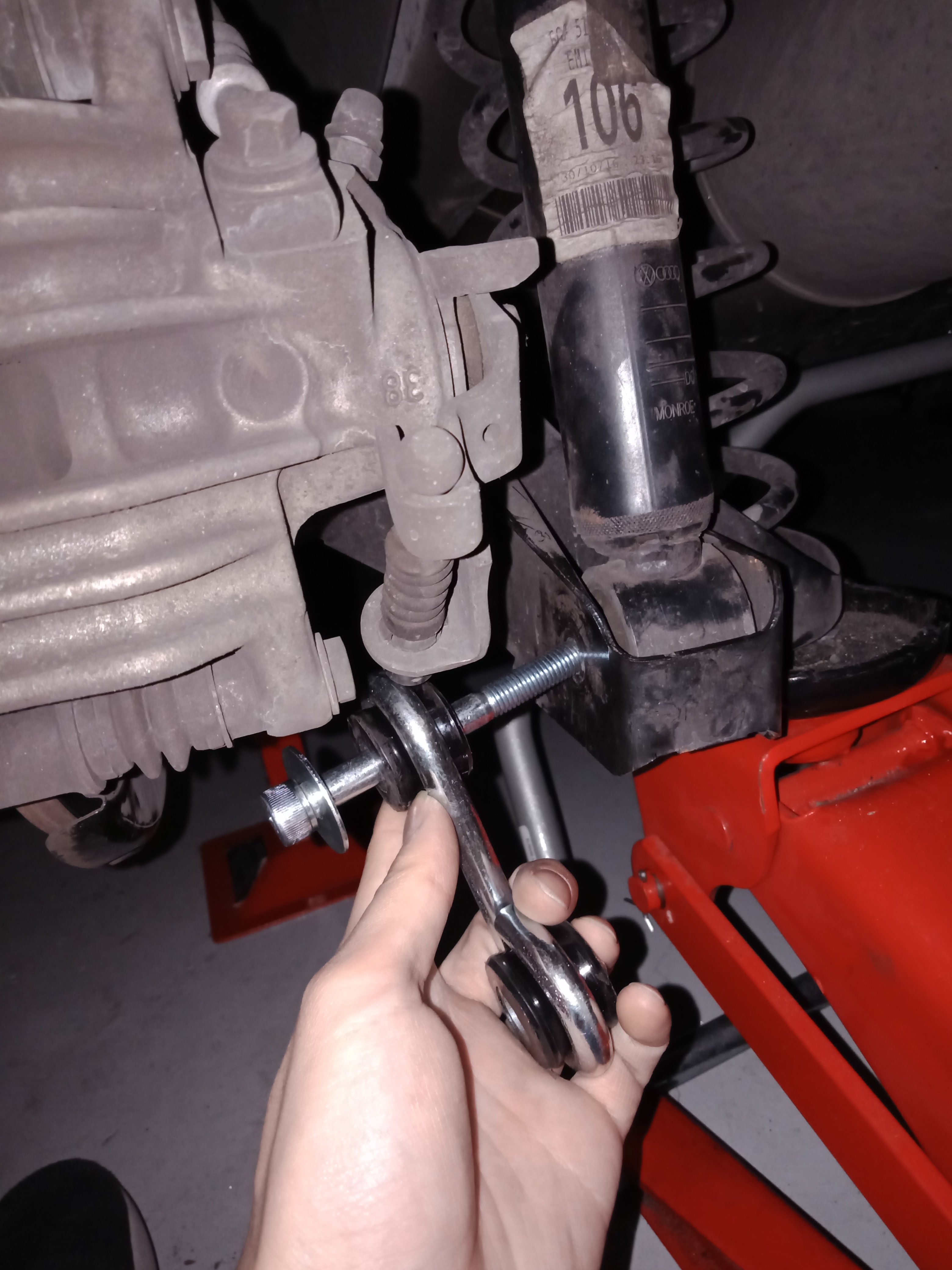

Regarding the sway bar, got it done with my friend and it took us 4-6 hours because we needed a Torx kit, to move away the handbrake line (see attached photos).
I completely agree! Sway bars make the car feel so much more stable, and even during daily driving, I get so much more feedback from the rear than stock! Feels stiffer over speed bumps but it is 👌👌👌

@FabiaGonzales rear sway bar I found reduces understeer (now only understeers when the road is wet) and increases oversteer. You can even get the rear end to pop out of line when pushing
