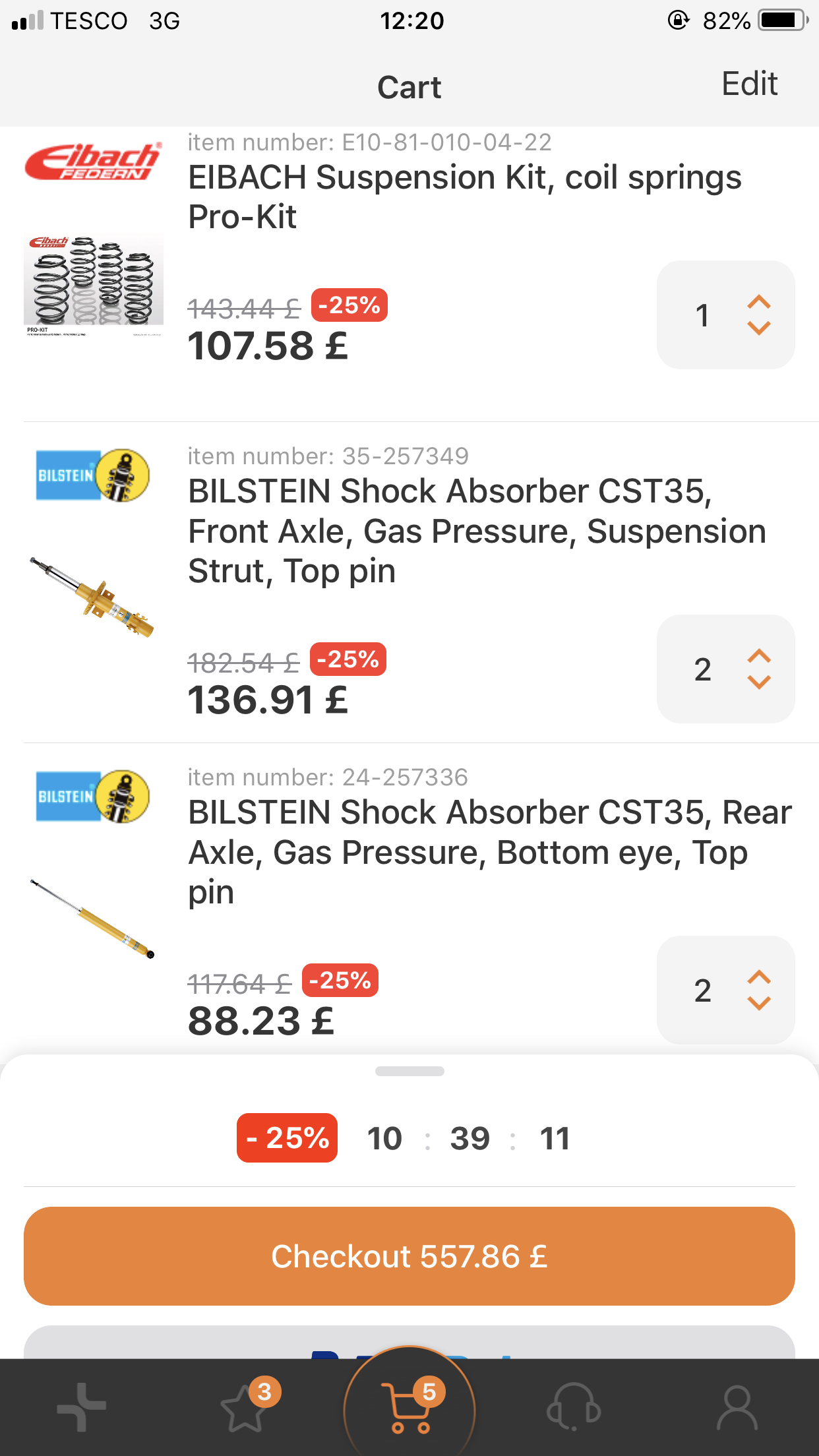

Seems as though Bilstein Shocks + Eibach Springs is almost the same price as the ST X by KW coilovers (£585),
which could be the better choice? (I need new shocks anyway mine are shot)
Based on things I've read I would say coilovers are better because the shocks and springs are matched perfectly. I read something about a Focus RS I think it was and the guy got lowering springs and Bilstein shocks and not only did the car sit higher with the Bilstein shocks, it also handled like a pig! My takeaway from that was do not try to match shocks with springs, just get coilovers!
Mind you, I haven't had the experience myself... At the time of fitting the springs on mine, one of the shocks had to be replaced too, and ultimately I went with standard shock because I did not want to gamble having Bilstein shocks put on and mess it all up.
Just got mine from ProSport for 67 reg Fabia 1.0tsi coil over kit £219 got a pair of better anti roll bars too for about 30 quid  https://prosportperformance.co.uk/shop-filters/coilovers/?custom_f_6[0]=536b6f6461&custom_f_7[0]=4661626961204d6b33204e4a&custom_f_3[0]=323031352d
Are you still able to adjust the ride height with the Bilstein + Eibach combo? I'm getting my ST X coilovers installed on Tuesday, trying to get as low as possible. Seem like a decently priced set, reputable brand etc.
Stick with the stx as you have adjustable ride hight and trust me they are quality not crashy at all! Your taking a big risk on hight and ride quality with an unmatched setup.

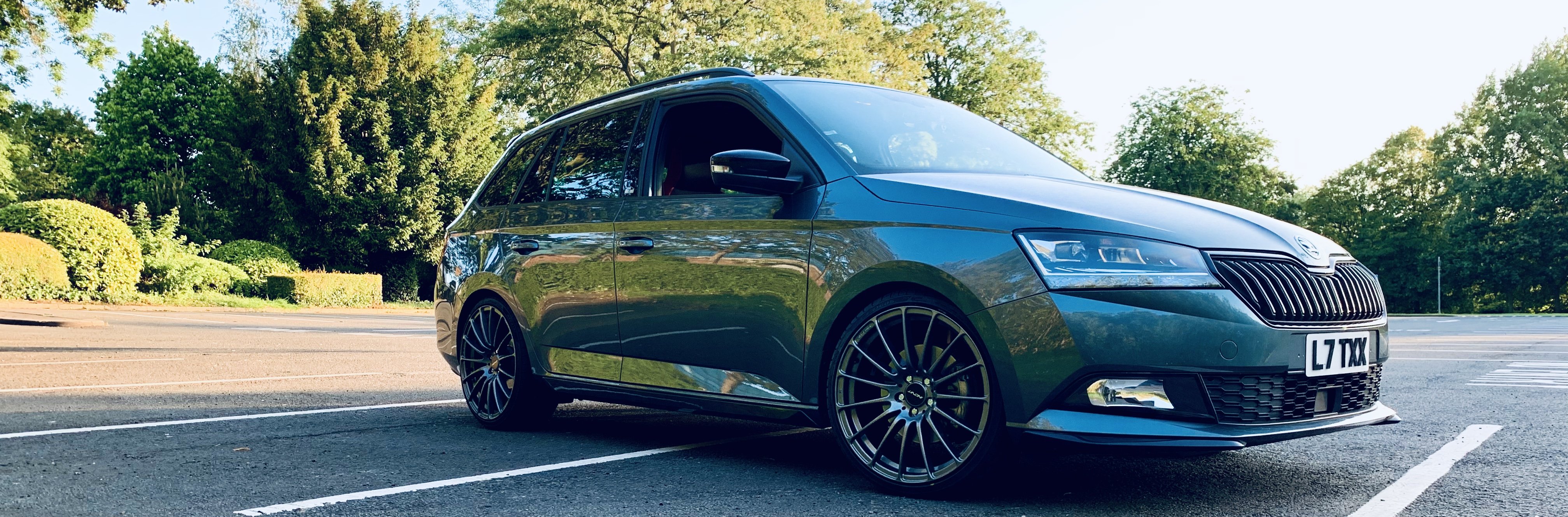

Agreed Danny! Looks great by the way.
Thanks! Taken a bit but loving the look! Drives like it’s on rails lol love the BMs surprised look when it rockets around corners haha
