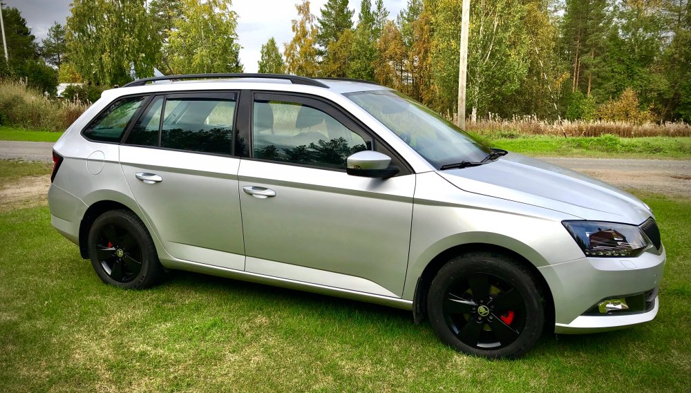

Hi from Sweden, not had the time yet with so many mods on my 2016 estate. Wind deflectors, plastidipped semi gloss oem 15” rims, 12” subwoofer, painted brake calipers, changed interior lights to Led, but more to come. Looking for a Thule Canyon cargo rack, change oem low & high beams to HID, leds i the fog lights, tinted windows and some monte carlo styling :)

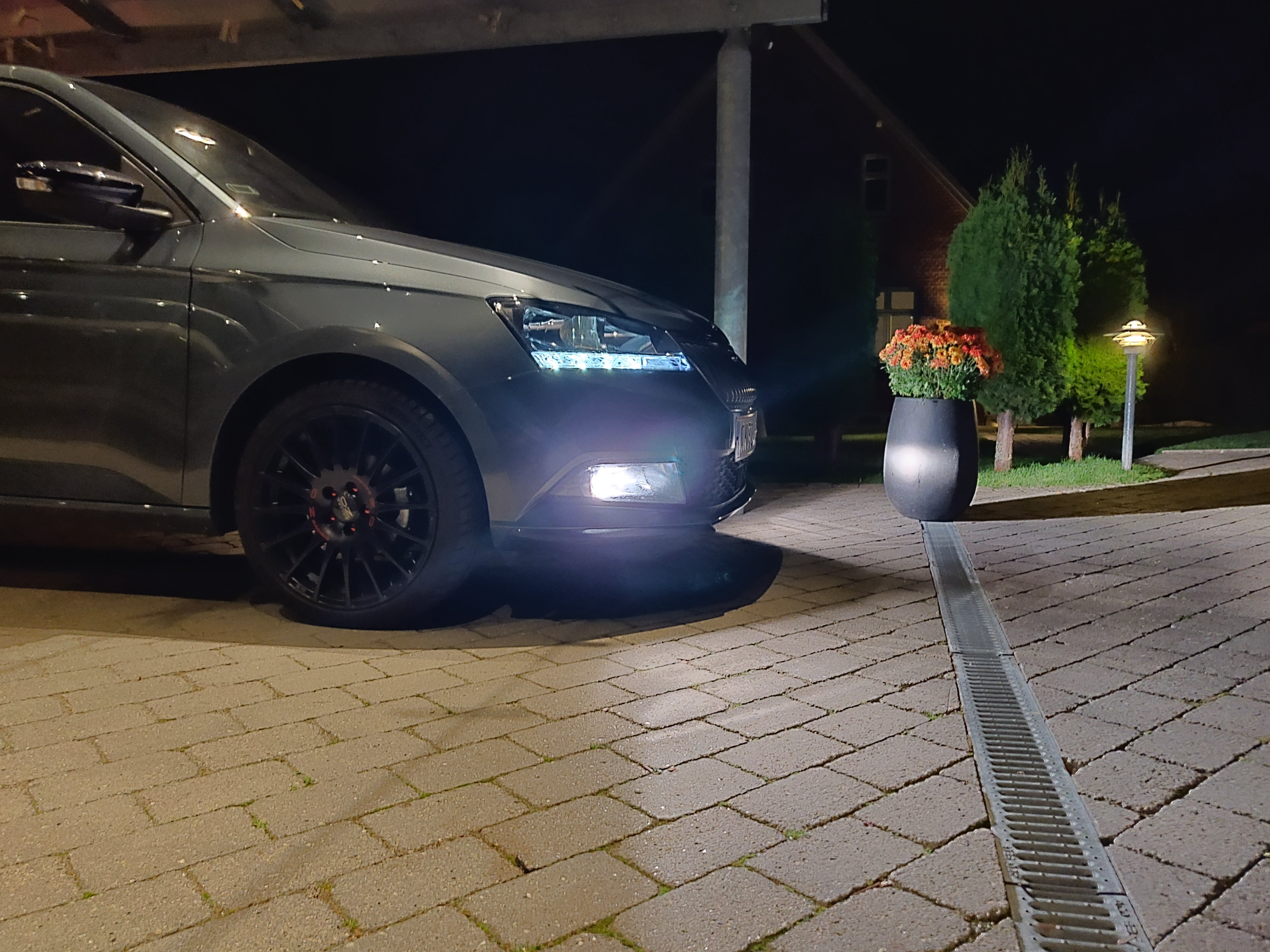

Just got the monte carlo grill, black lettering and front lips installed on my 2019 facelift.

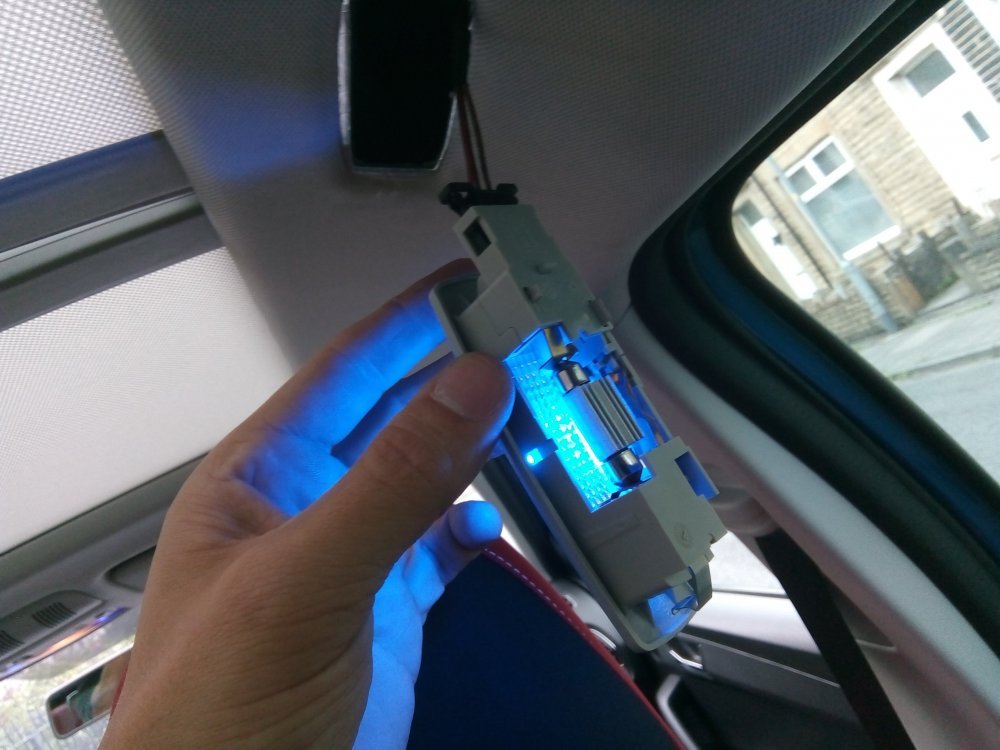

You need to remove the fuse when doing the interiors or you will blow the electrics,
Glove box, Map Readers and Boot is these T10 W5W (50/50 chance when you fit (+/-) so remember which way you tried
https://www.ebay.co.uk/itm/222203533684
The centre is one of those 39mm-42mm festoons, which is also used on the rear ceiling lights, this was hardest of all because the whole unit falls to bits. There is metal contact
inside which controls OFF,ON, and ON when door opens, It was really fiddly.
