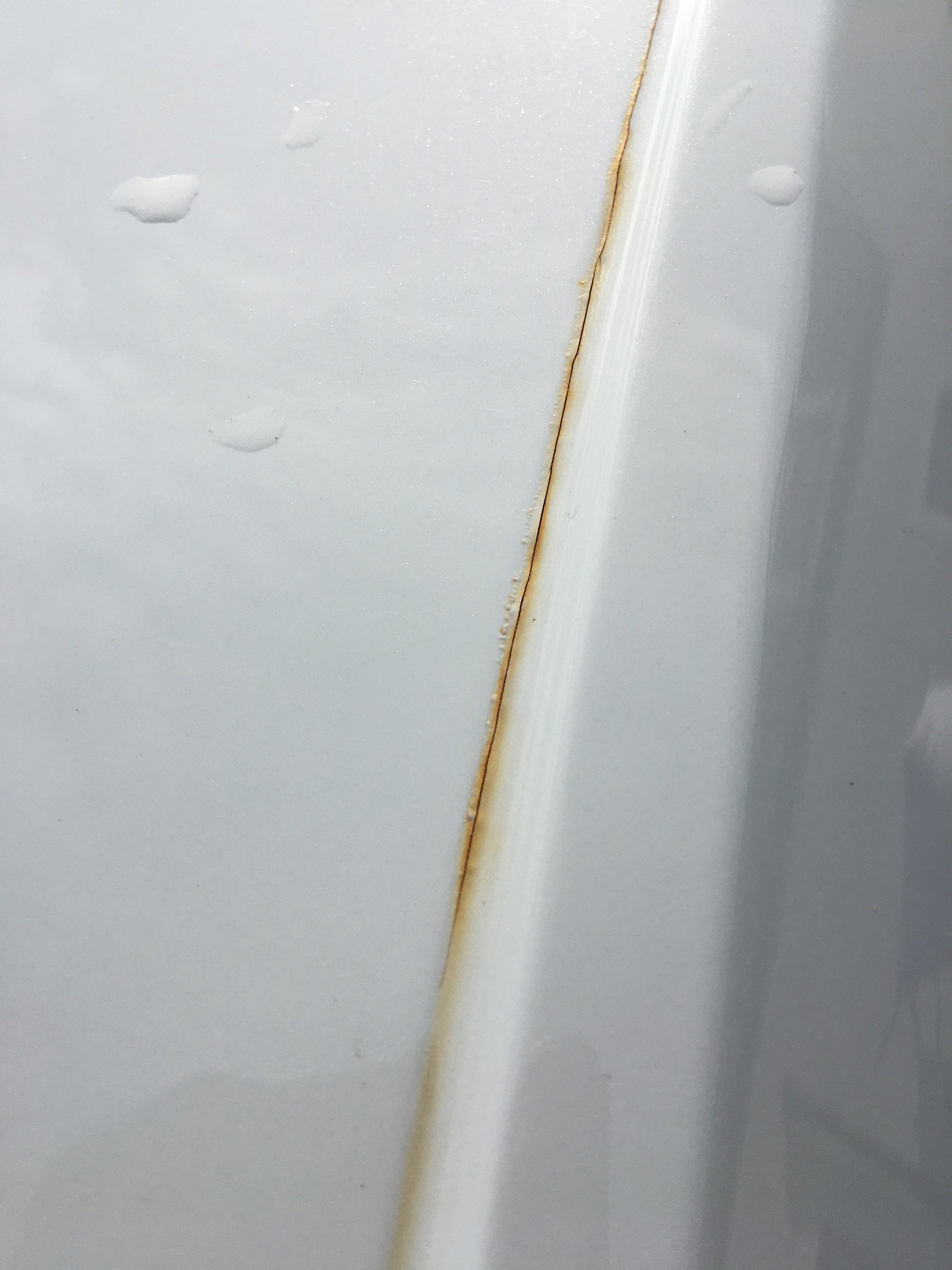

My woes continue. I went out to wash my car and on the roof the paint has split with loads of rust. Not happy.
I will need to get it booked in for a respray. Thoughts
Yikes! How long is the split? Which side of the roof is it on?
Never ever seen anything like that...
I would want to reject a car like that, but has it past 6 months?
I suspect it may be connected to your rattling door problem, looking at the body parts diagrams on 7zap.com there are several "roof reinforcements" that tie the side panels to the roof and side to side. My suspicion is one or more of these are not properly welded allowing roof to side movement.
Simply respraying may not fix the underlying problem and it could come back later, out of warranty.....
So I bought the car from Skoda in January. It was the managers cat I believe. I wonder if I can reject it?
its quite a long split easy 7 inches. It’s on the drivers side. It was pure luck that I seen it.
See my previous edited post re roof reinforcements. They need to remove the roof lining, a and b pillar trim  and check everything is welded as it should be before any remedial work is undertaken.
