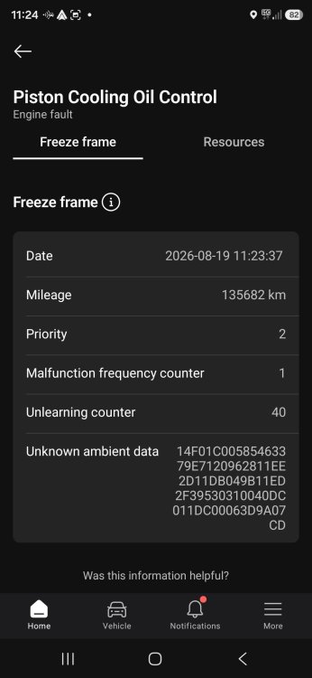

P25AB00 Piston Cooling Oil Control Circuit High - Superb
I just upgraded to the OBDeleven PRO subscription to get full access to Freeze Frame data, and I stumbled upon a very interesting discovery regarding the fault's behavior: The code returns instantly on ignition alone (before even cranking the engine)! Here is exact sequence I tested: Cleared the fault code (P25AB00). Turned the ignition off. Turned the ignition back ON (engine OFF / no cranking). Ran a full diagnostic scan. The fault immediately reappears as soon as the ECU powers up, even without the starter motor engaged or the engine running. The PRO version extracted the raw Freeze Frame values. While I can't interpret these raw numbers (HEX) myself, I have forwarded the PrtSc directly to the dealership service team so their technicians can analyze the exact ECU parameters at the moment of failure. Will keep you updated once I hear back from them!
Maybe check engine bay fuse box for loose contacts/corosion/relays and all earth points you can find. as the wiring is new and so is valve. Alasdair
