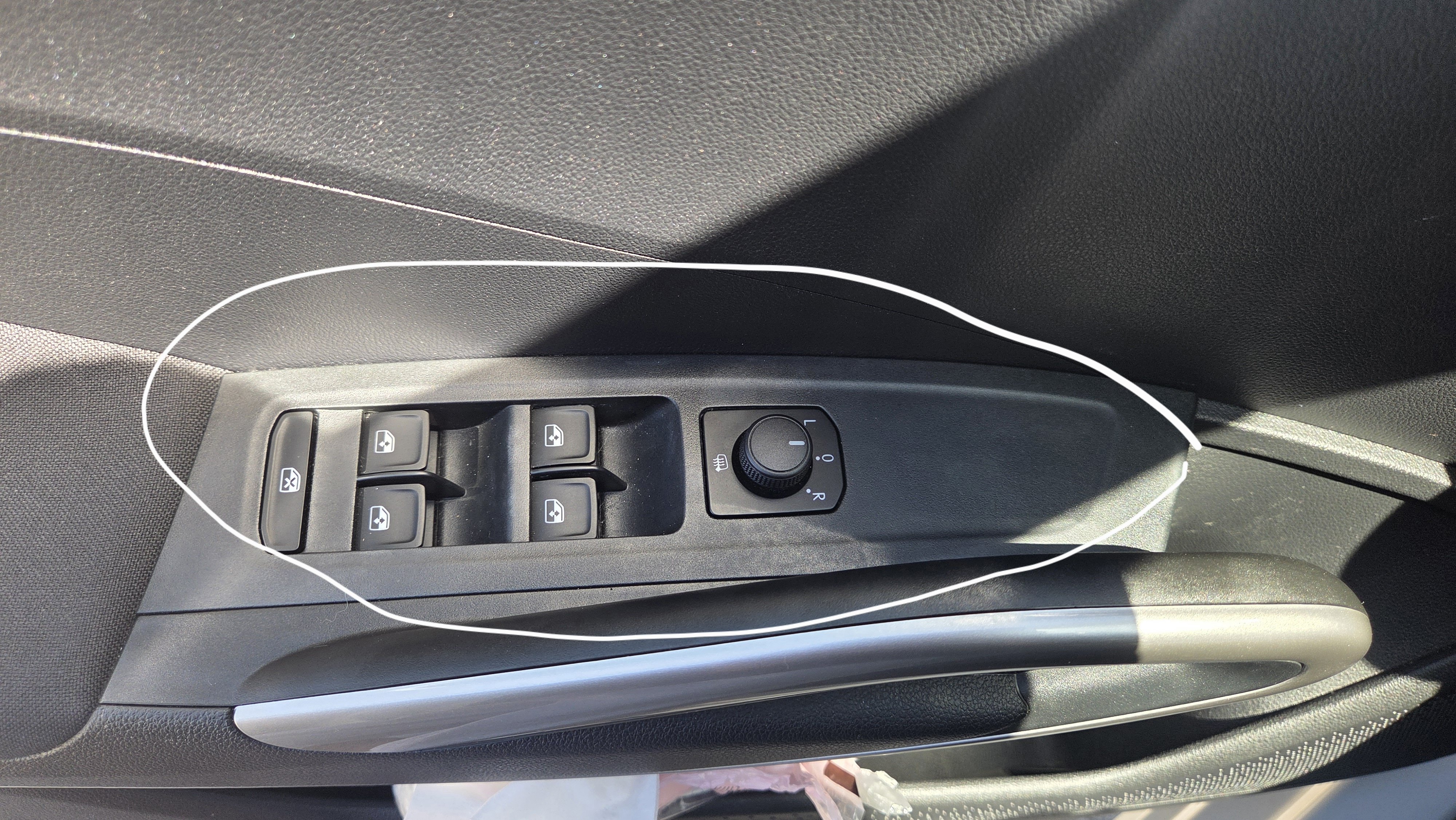

Fabia 2024 door plastic
Hey my door handle plastic is fading on both sides, any one has any idea if its replaceable and where to buy new? Fabia mk4 2024
