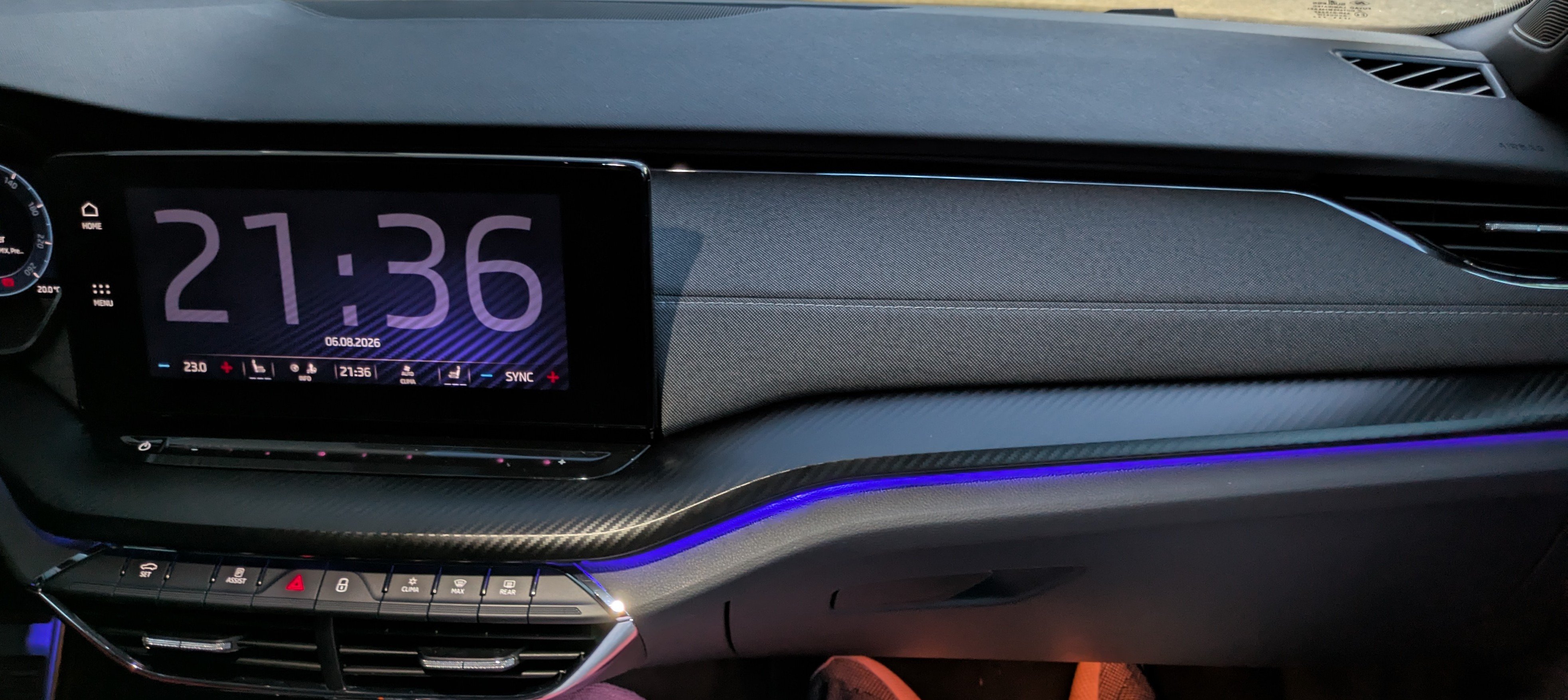

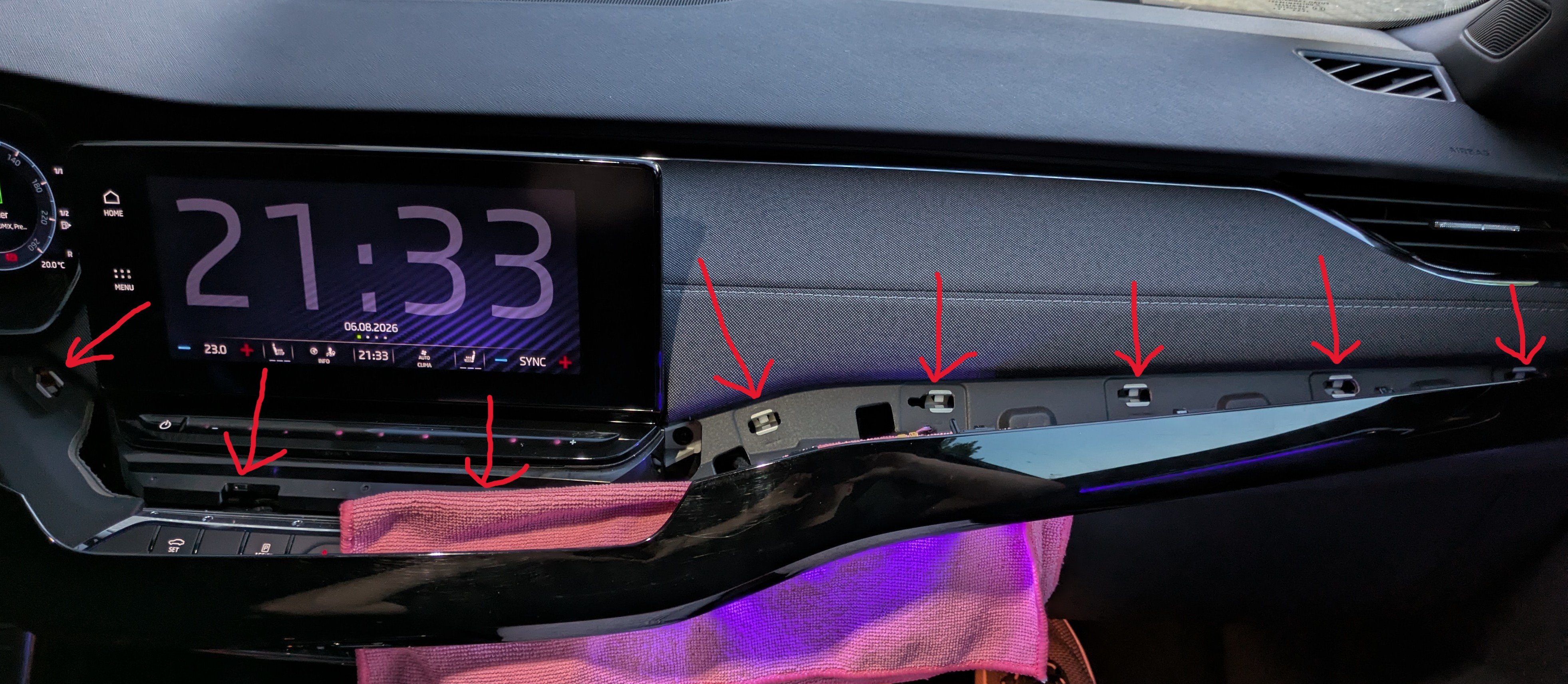

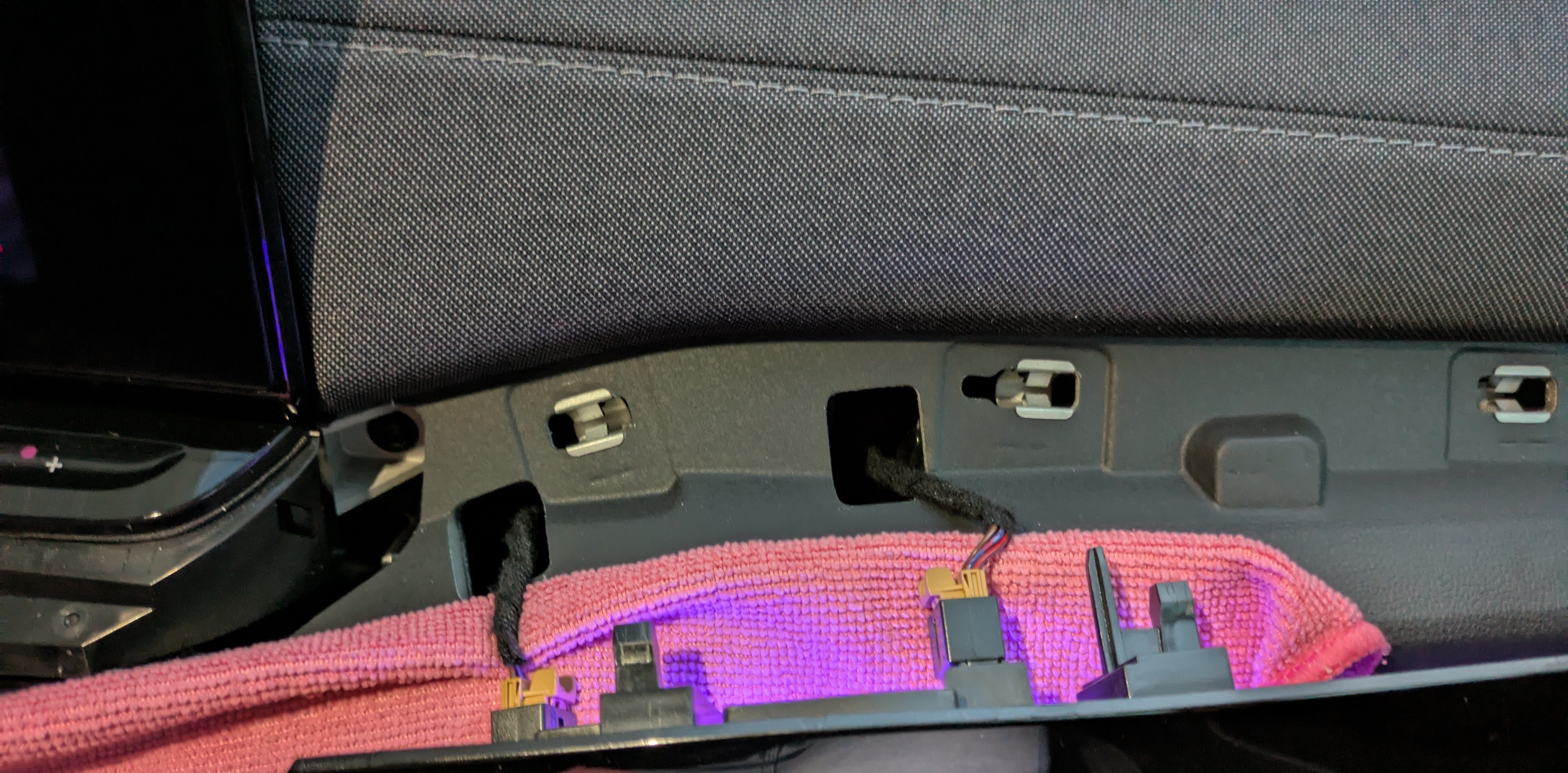

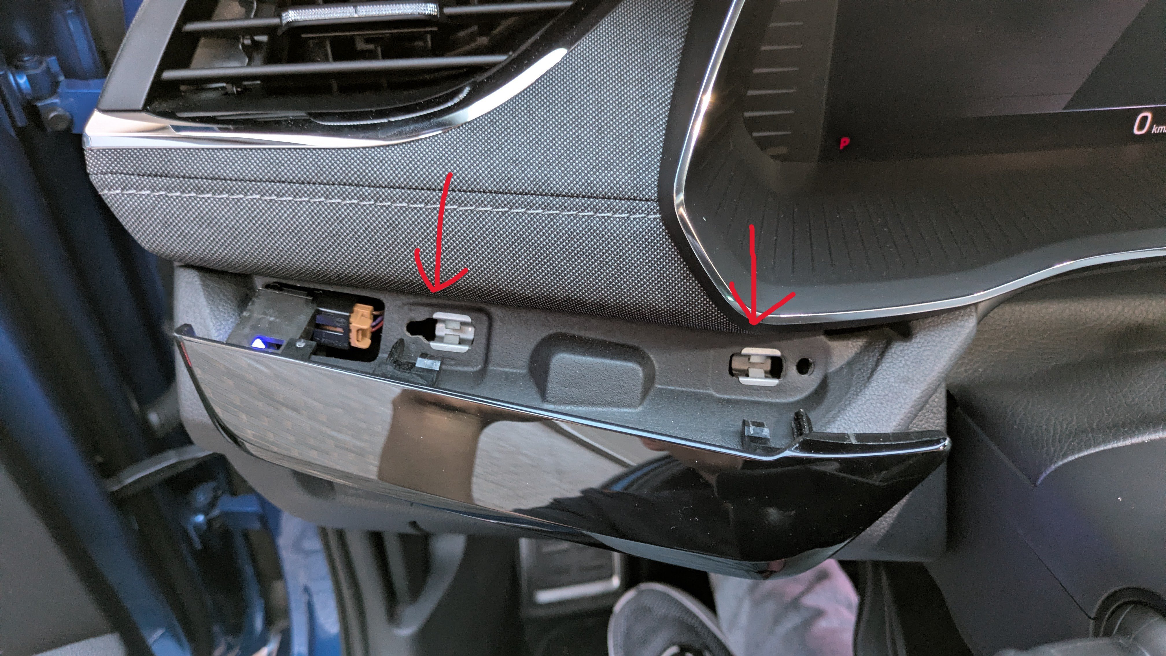

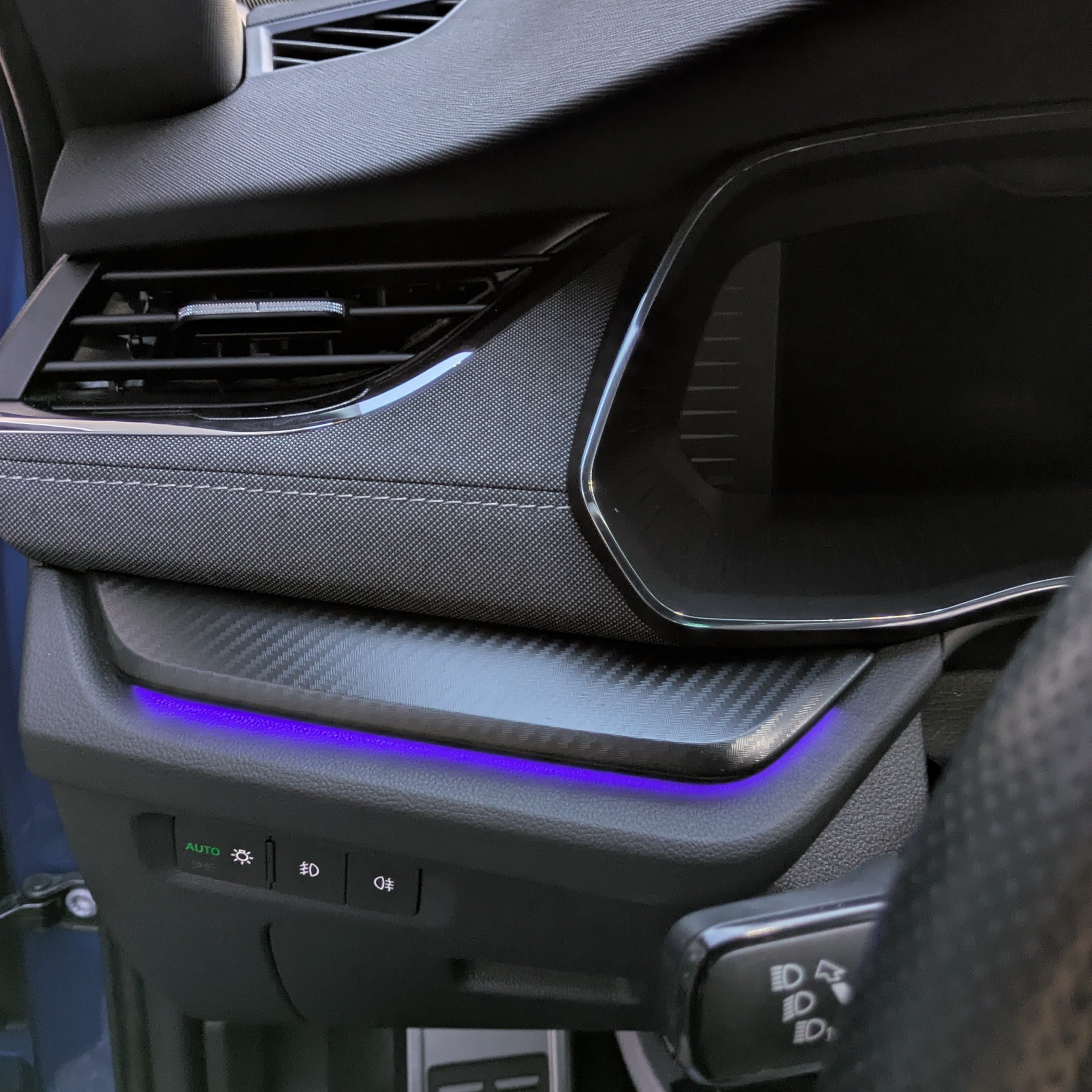

It has taken some time to get around to actually swapping the parts however I have just successfully replaced the once gloss black (but when I got the car already quite scratched) trim pieces to the "carbon" ones. 5E4 853 190 A YI2 -> 5E4 853 190 A 9NL (small piece) 5E4 853 192 C YI2 -> 5E4 853 192 C 9NL (big piece) (old part number -> new part number) As you can see from the above, the A & C are indeed revision numbers, the YI2 and 9NL are represent the finish. YI2 being gloss black, 9NL being the carbon-look finish and there's also JO8 which is the haptic squares grey one. In one of my previous screenshots you will find more options, however I have not seen any of them for sale (I bought the only 9NL I could find in my country at parts traders, and have not seen the gloss black for sale once). They could be available through a Skoda dealer. Removal was quite stressful however also quite doable in the end, I would really recommend being thorough and taking your time if you'd like to do the same. The small strip has two clips while the bigger one had 8 (I think). See the pictures to get an idea, the arrows point to the clips. I used plastic trim removal tools and a cloth to not damage the quite soft plastic below the strips and worked on the bottom along their length to loosen the clips. (DO NOT try to insert the trim piece from the direction of the arrows!!!). Once they go, they'll either click out, at which point I am always scared they'd break, or be half loose. Once the whole piece is loosened, go around and again and try to pull of the piece. Be careful to not bend it too much and be cautious of where you put the trim removal tools to aim besides the tabs. The connectors for the leds are pretty self explanatory. Installation is even more simple, plug in the led connectors and align the trim piece. Push in, check it's attached fully everywhere, job done. I am not a professional, this information can be used as reference however as always at your own risk.
