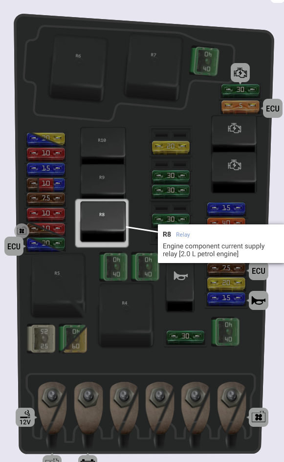

Meant base of actual engine bay fuse box as in picture above. Think there are connectors underneath to ecu etc. Not unknown for a pin to be coroded or socket opened up enough to make bad connection especially if moisture is present. Alasdair

@Morph I dont have 458. I have 646 and 645 if I am not mistaken. (3x 646 and 1x 645) It is a Skoda octavia mk3. On the fuse box on the inside of the car there is 1 x 645 and 1 x 646.

Relay 458 in the engine bay could be the cause.

Could be corrosion or bad connector, where is this fuse box in the bottom of engine bay? I do have aditional fault's that are allways present and i never cleare those. Air Conditioning: Air quality sensor faulty (B10AF04 active). Dashboard: Function restriction due to communication interruption (U111000 static). Multifunction Module: Data bus error value recived (U112300 static). Multifunction Module: Fog mode active (C118E00 static)

A random thought and could be wrong but wonder if its corrosion or bad connector pin/socket in bottom of engine bay fuse box? Might be making good contact when warm but poor when cold thats not enough to trigger other fault codes but the N522 valve system may be more sensitive. Alasdair

anybody found the solution? I read in another thread that the issue @SkodaLada had, was solved with a relay change. However I dont know which relay to change. I am having exactly the same issue. Already changed battery, checked all the ground cables, fuses and all seems ok. It is an intermittent issue, is happens when driving, sometimes when starting the car. The errors goes away by itself. I have an OBDeleven, I cleared the codes and it comes back.
