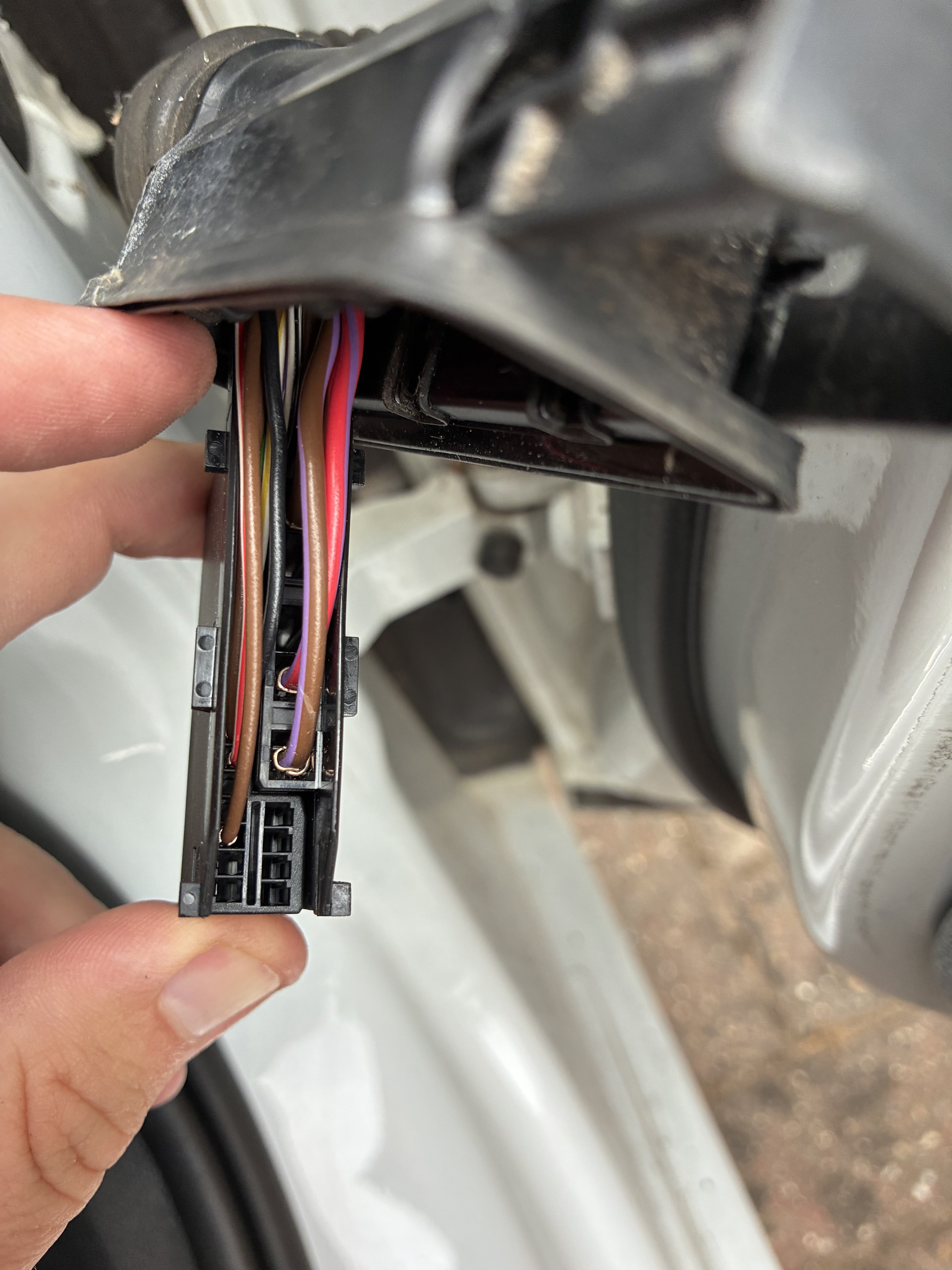

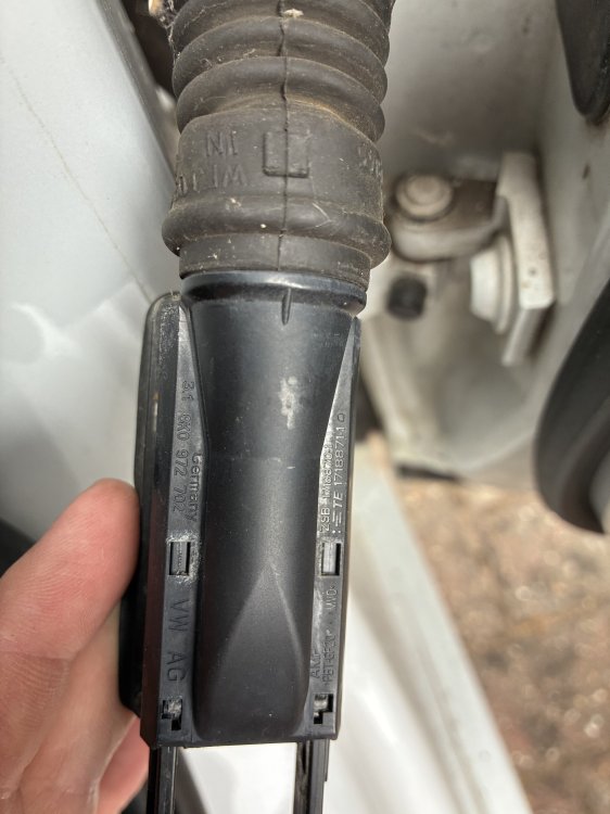

Door loom T27a plug pinning on car side
Had a look this evening and that’s the wrong plug type. It’s 8K0972702 which you can also get repair pin out kits for. car side looks to be 8K0 972 701 which I can’t find pins for as yet. Any guidance gratefully received!
