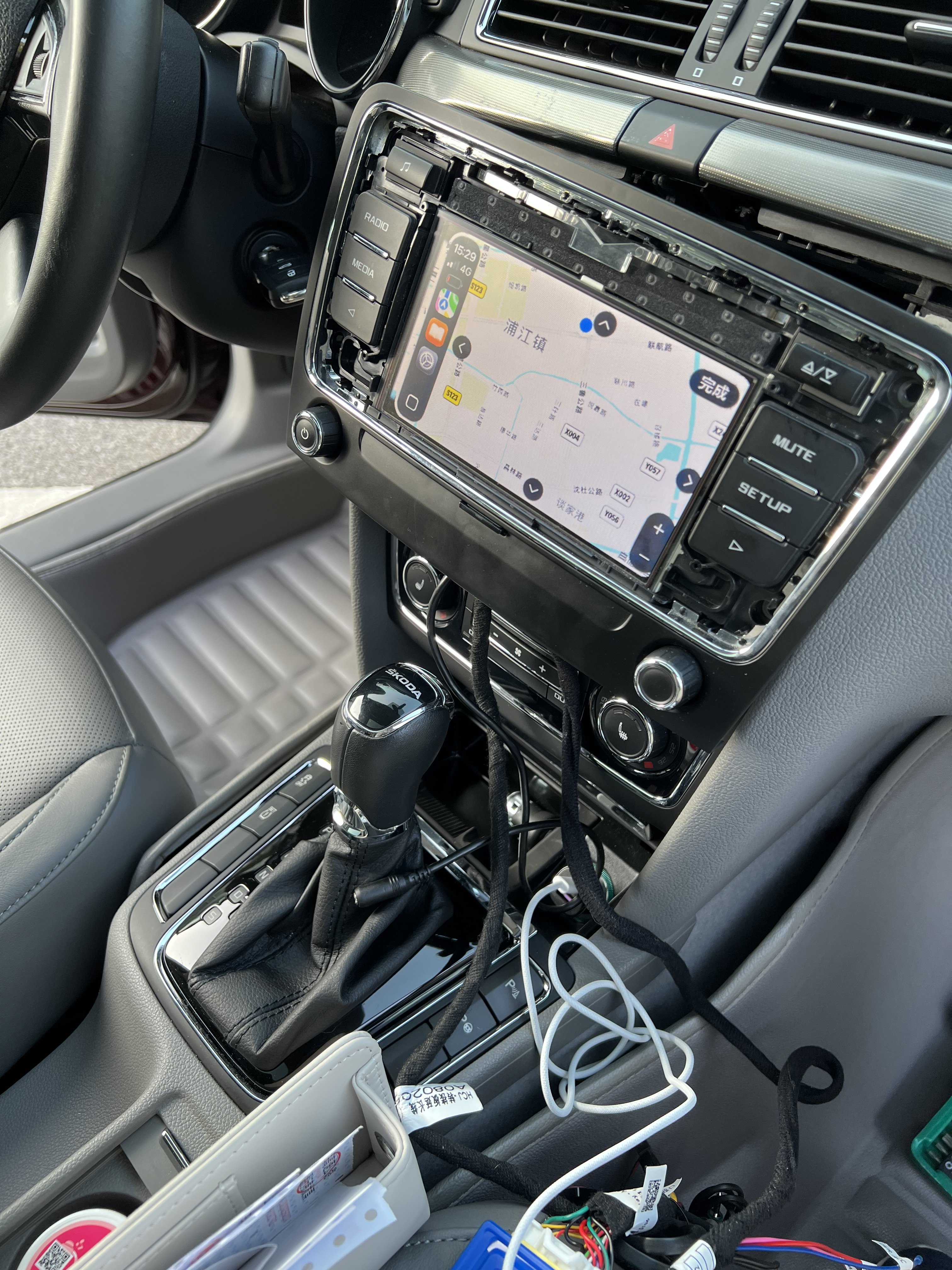

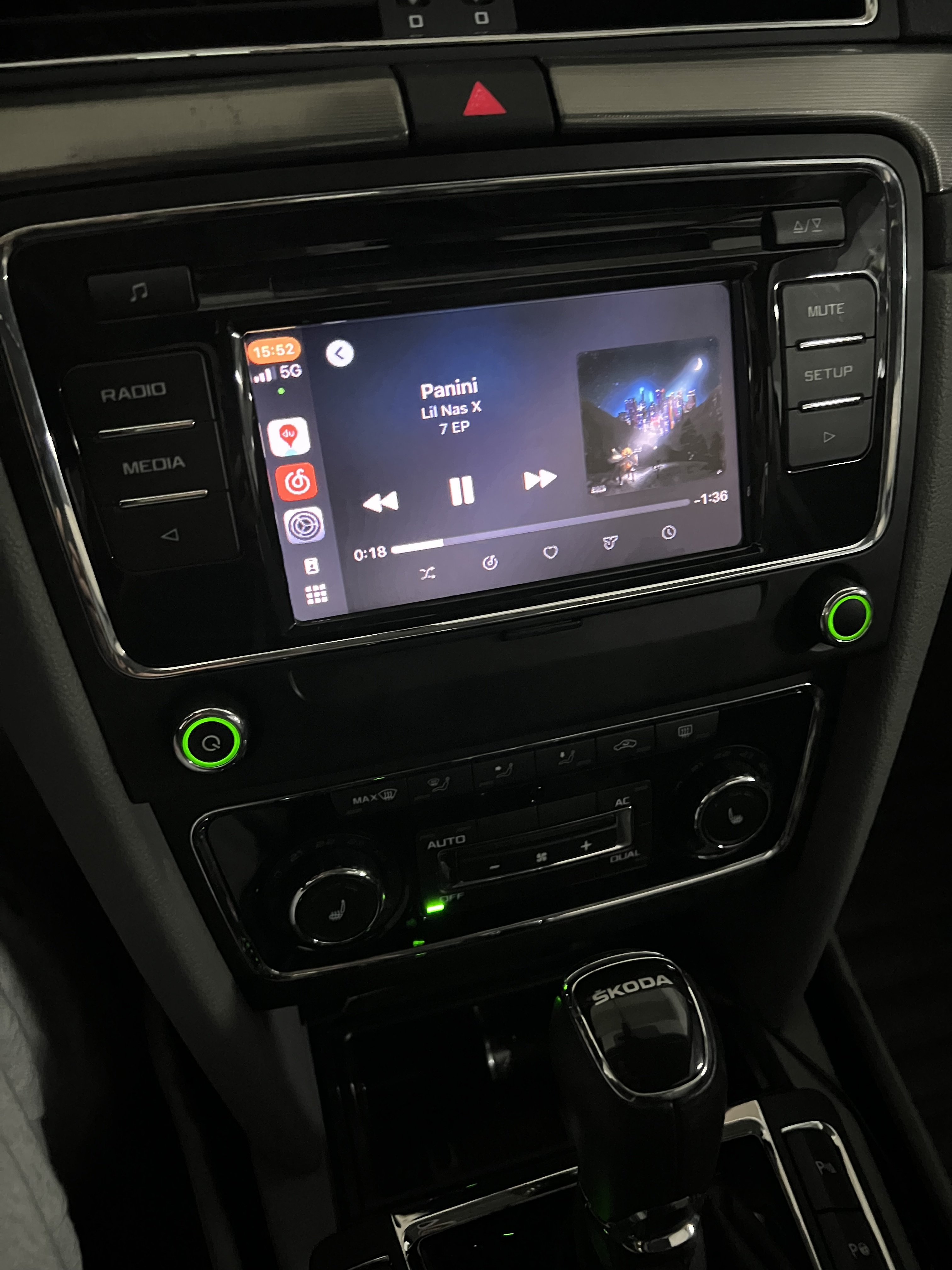

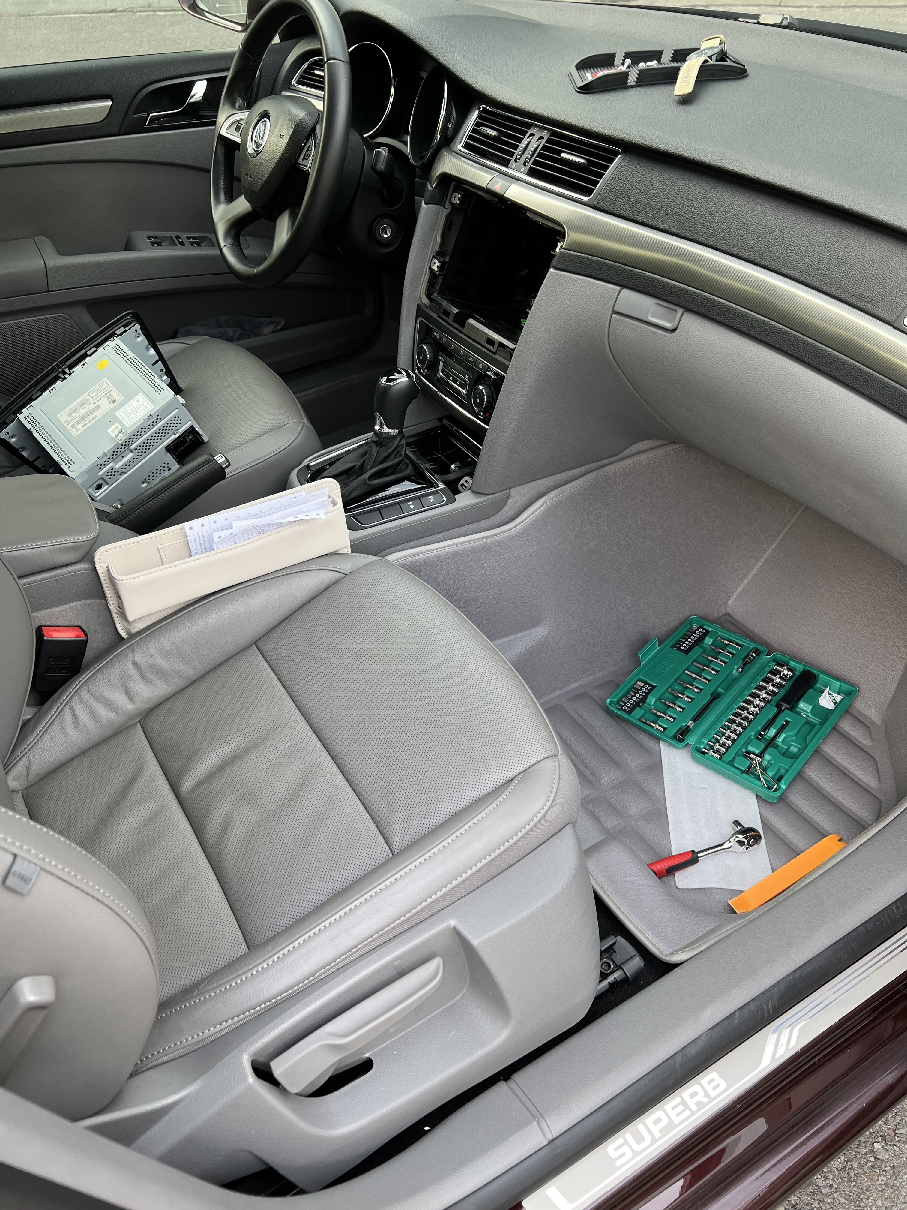

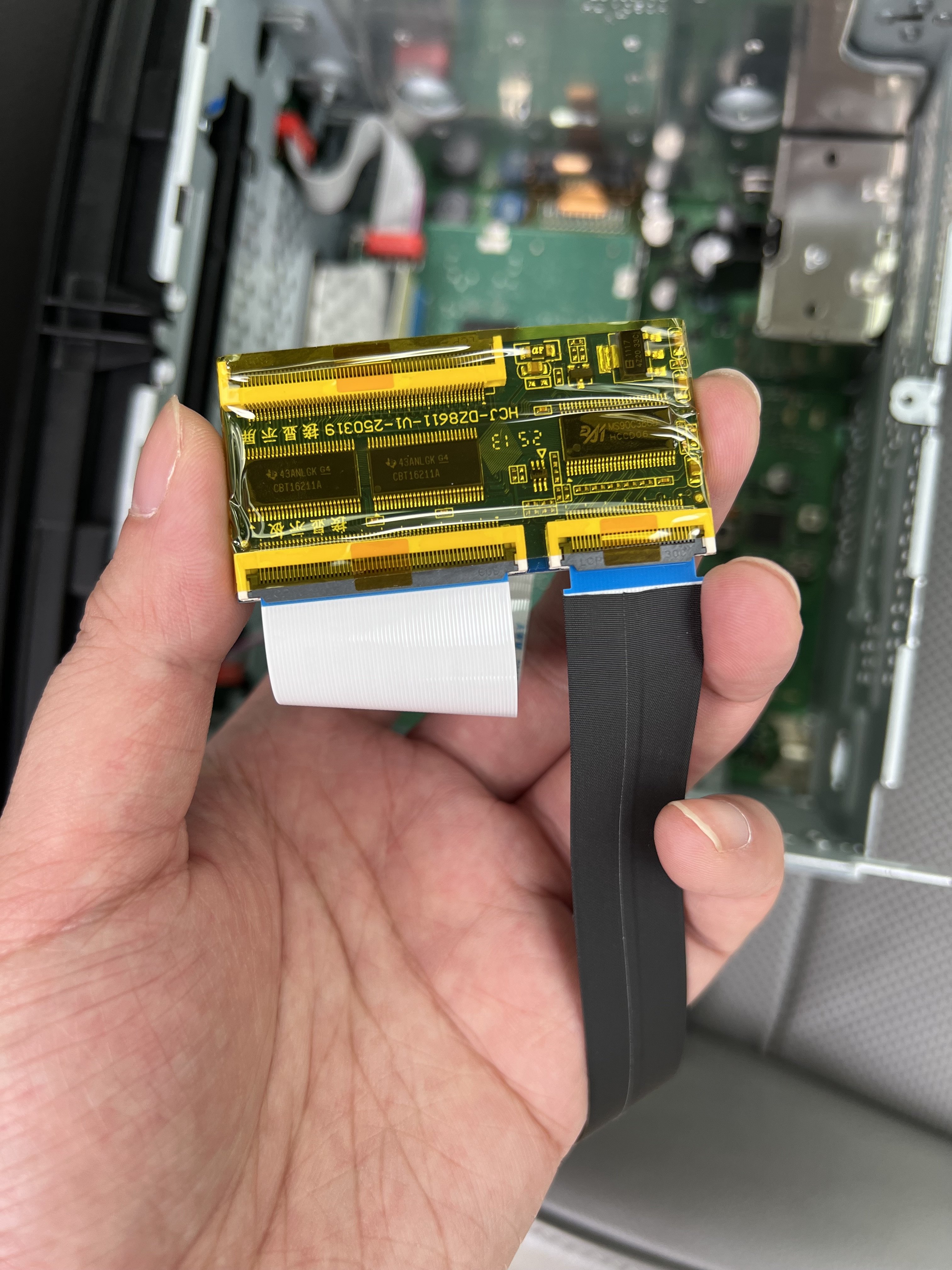

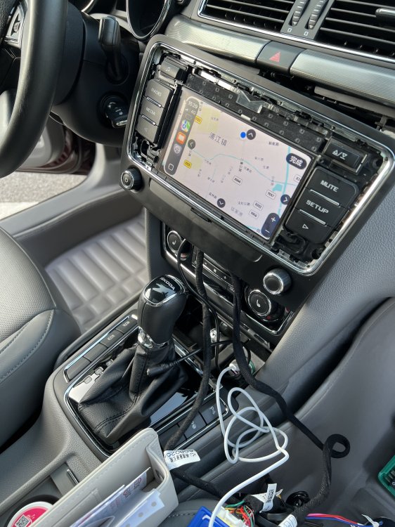

Upgrade Carplay on my Superb 3T
I spent about 100 bucks buying a carplay module, and put it into the RCD510. So the RCD510 is the screen used to display while the carplay module working inside. There's a button to switch model between original display and carplay display, which means the car has two central controls. The hardest part is finding the space to hide the carplay module and the harness LOL.
