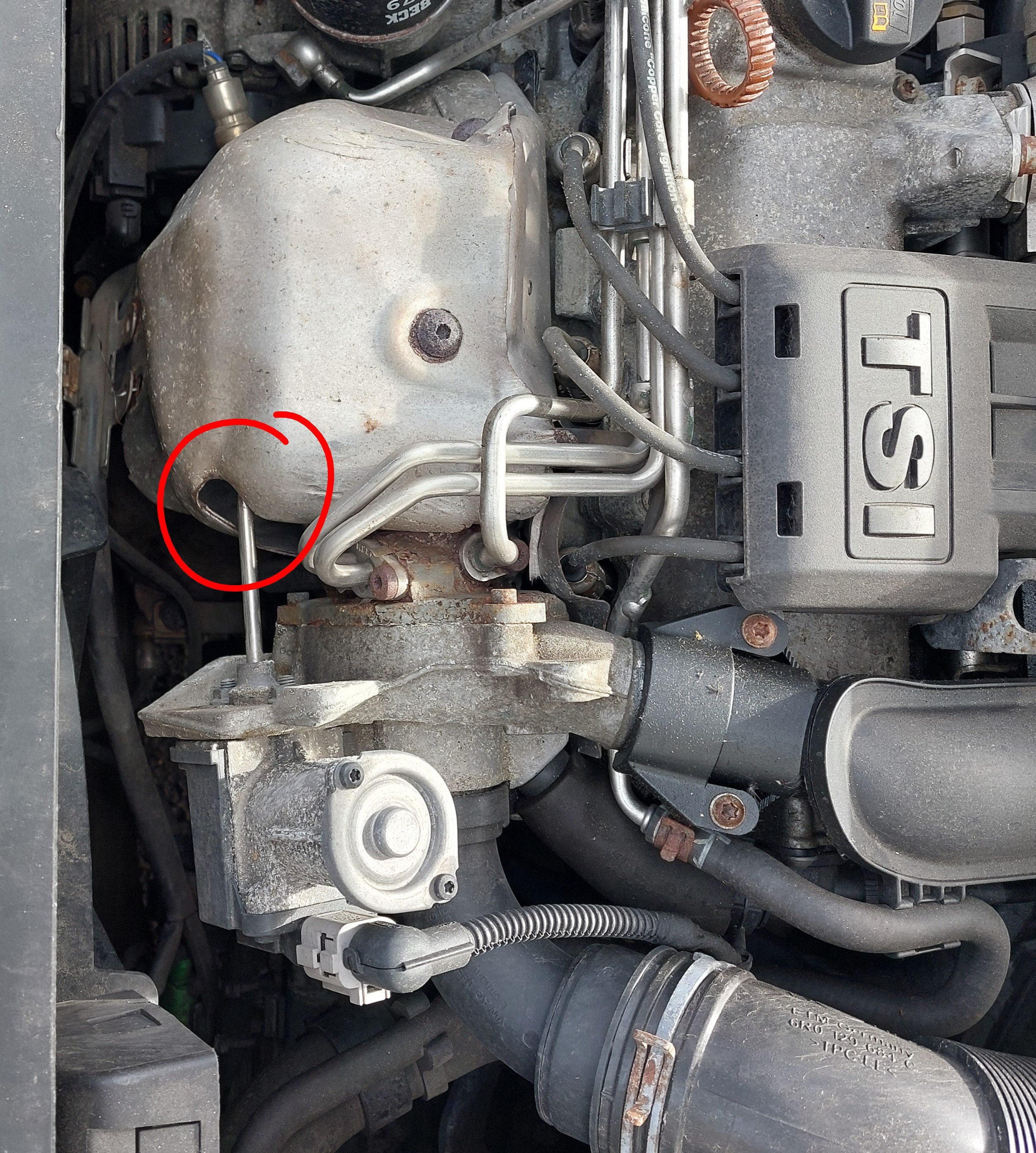

EPC warning light and limp mode
Well that was quick and painless, thankfully! 👍 It turned out that, when the Turbo Actuator arm was replaced a couple of years ago (before I got the car) the housing hadn't been put back quite right, so it was rubbing on the arm and it had caused enough friction to register as a fault. A couple of minutes with a screwdriver and pliers and it was moving freely again Whilst having my own OBD reader might have told me the problem, I wouldn't have known where to look, so that's £60 well spent.
