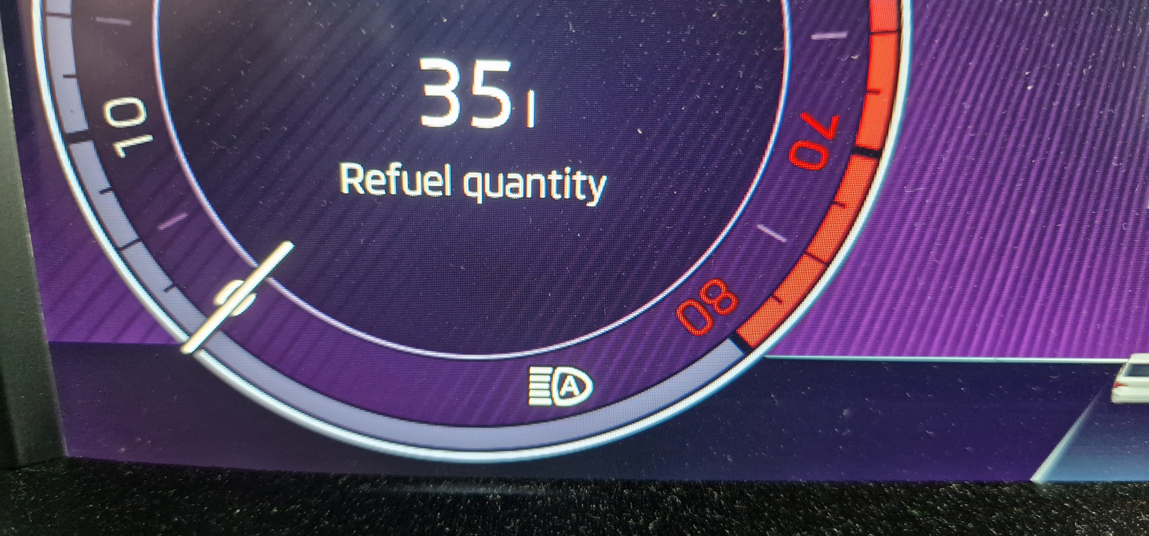

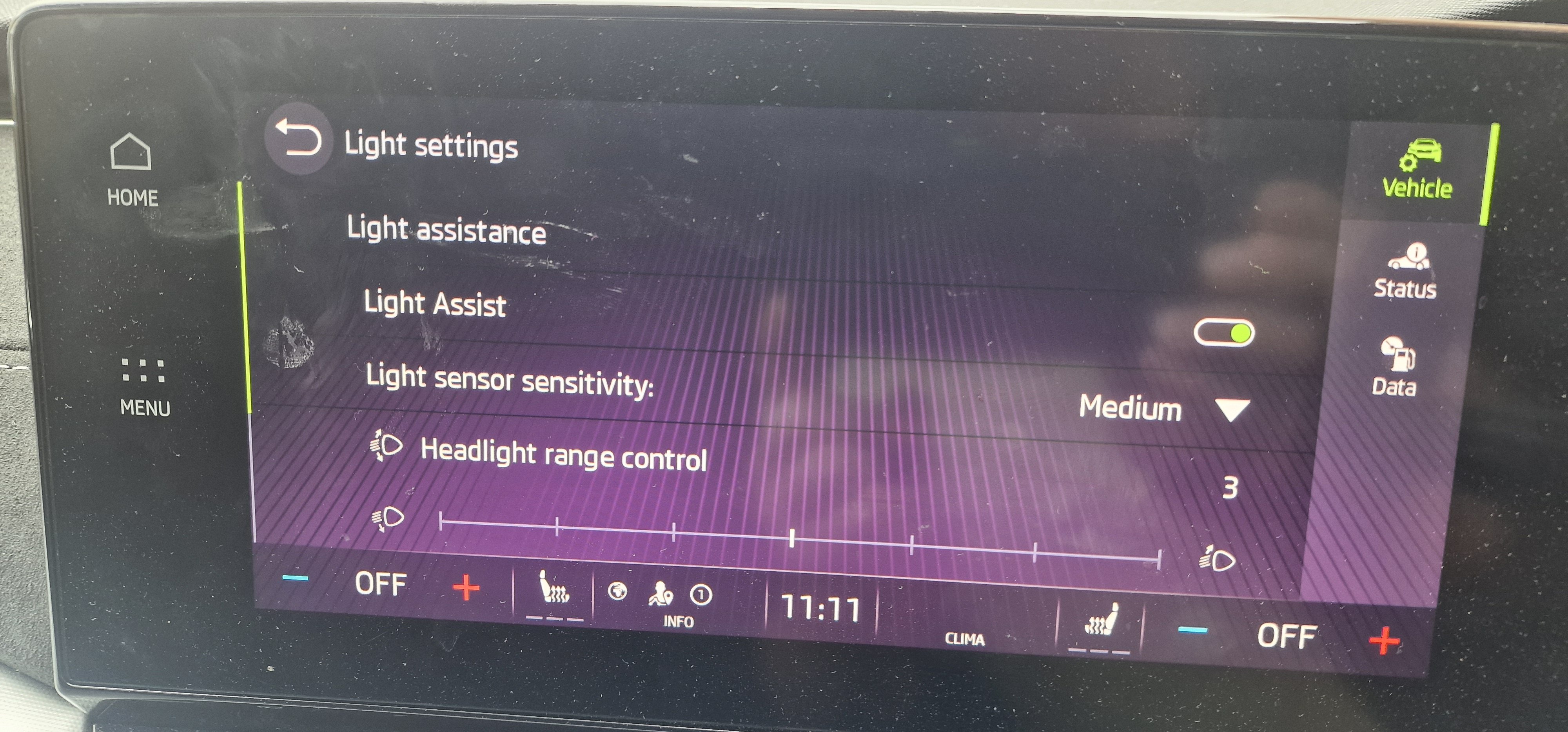

hi i been facing same problem after purchase my mobile app show activated ,shop app in car show activated but no Light assist button in menu skoda support keep sending me to dealer i contacted 3 around me but no response. i got HW : 5WA937086K 016 SW : 5WA937086R 0136 DATASET : V03935324EA 0001 I compared my backup in VCTool what i found was in central electric09/adaptations/LCM/Expanded High beam control/ i got basic configuration where other backups with basic LED they had high beam lights assistant and when i tried to change it i couldn't because function not available that backups has V03935356TC/V03935356TX datasets and SW 0136/0137 so i bought VNCI6154B + VCTool (needed for reverse camera retrofit anyway) requested stock data and dataset was V03935356TX with all calibration etc. 2min flash and central electric09/adaptations/LCM/Expanded High beam control/high beam lights assistant was there light assist button appear in menu

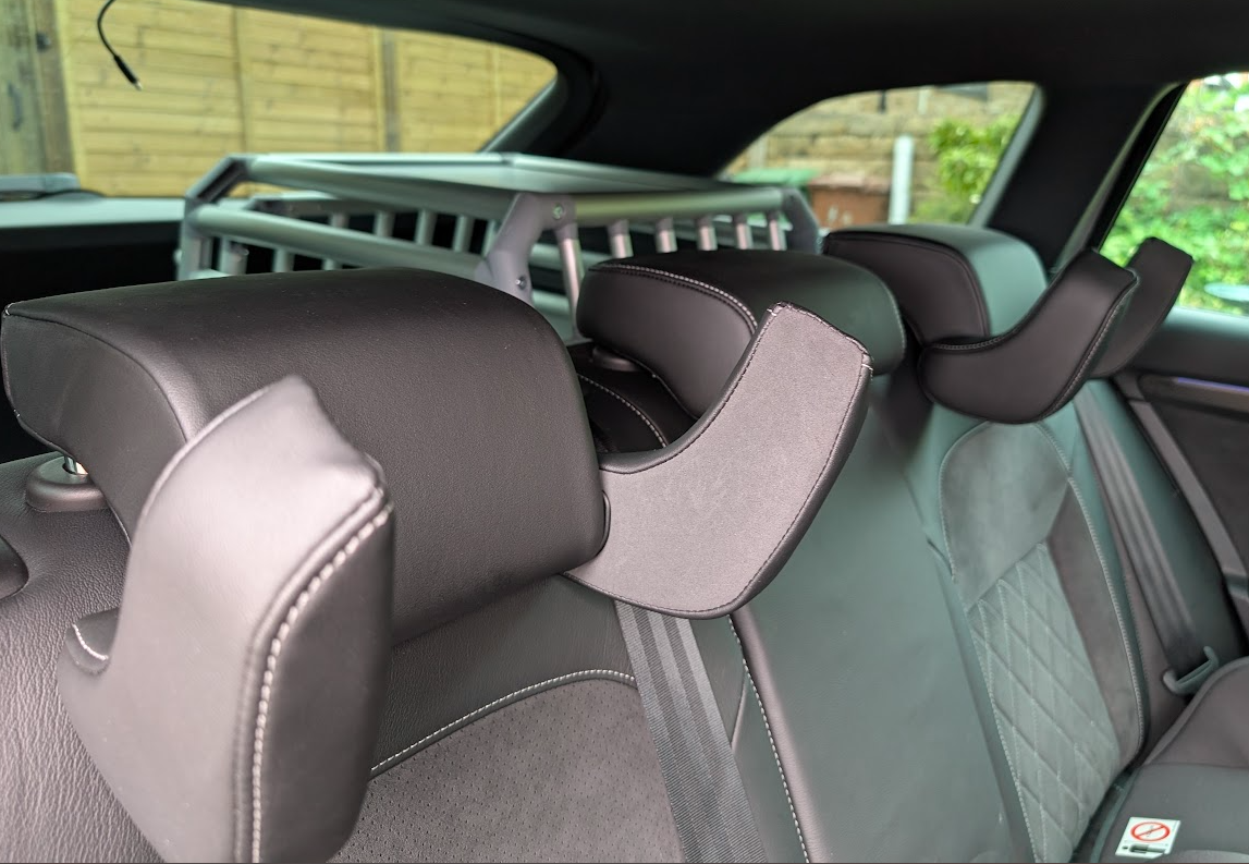

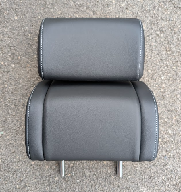

I bought a pair from Skoda Parts as I've used them before, took less than a week to arrive. They're slightly wider than the normal ones......
