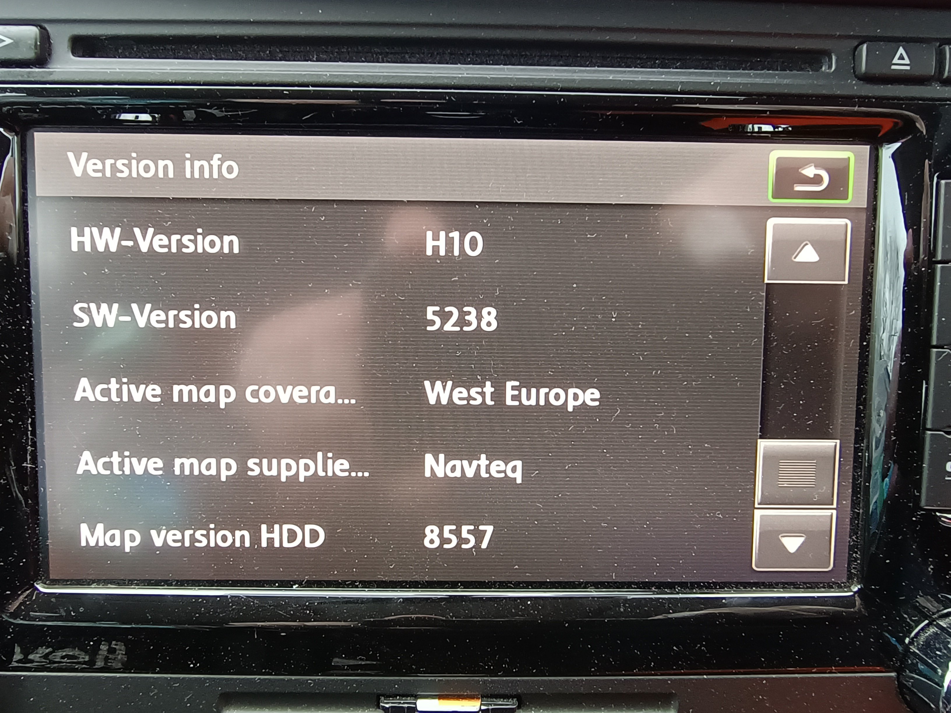

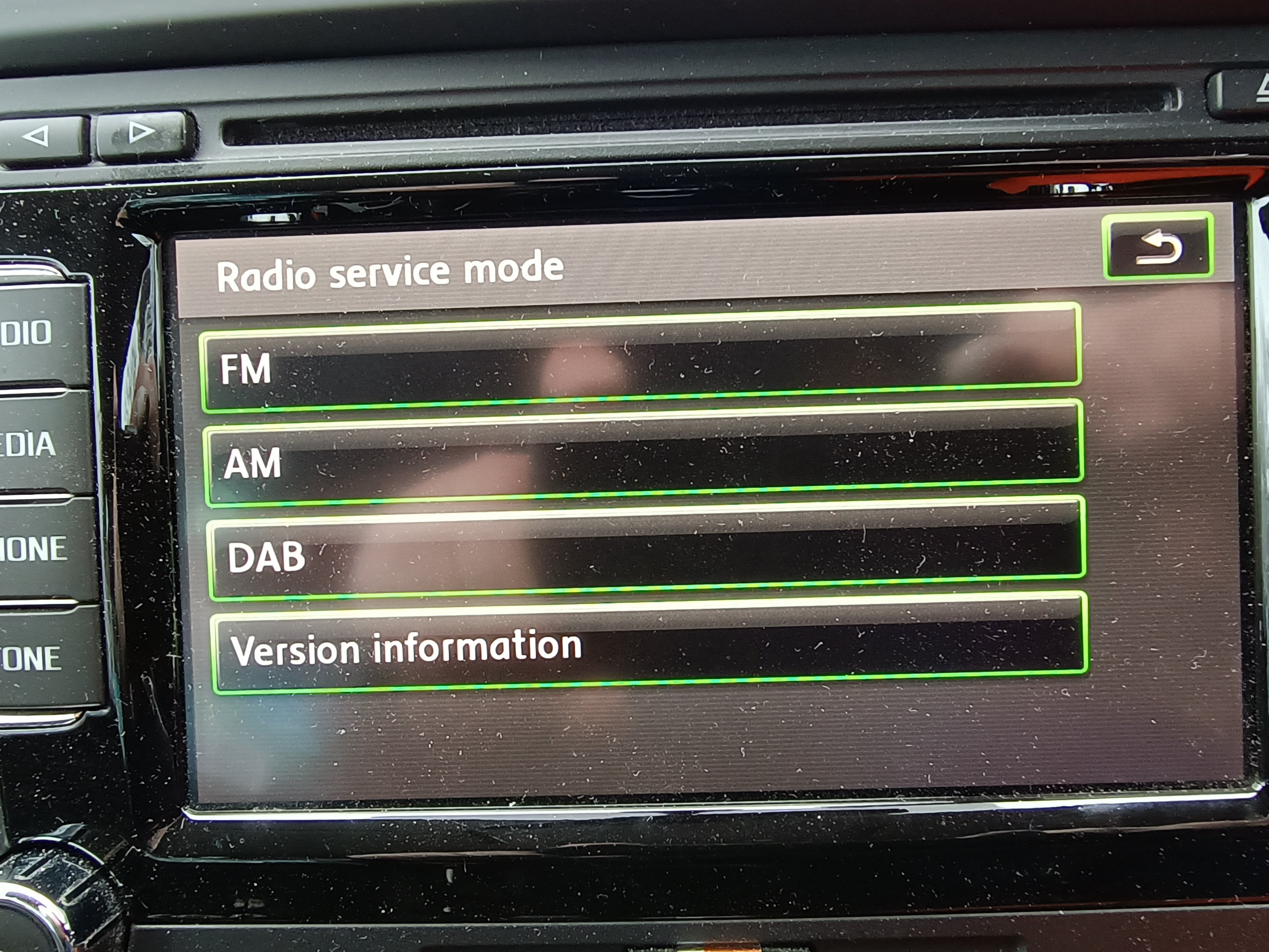

  36. A 5 second hold of setup button gets you into "Radio service mode" menu and in there is a versions information button: At the bottom of the versions info screen is the map version

  40. There is a hidden menu with all the version information. From recollection, you need to press and hold the SETUP button (lowest of 4 buttons on right) until the hidden menu appears. Will double check when go out to car in morning. To decode the map version try https://wiki.ross-tech.com/wiki/index.php/VW_Navigation_System_Maps Superb 2 Columbus is an RNS510 in disguise and so uses CY maps. The last end of life map release was V17 which for west europe maps shows as version 8557 in the columbus hidden menu. Think this was first available at end of 2019, certainly upgraded my maps for the last time with this version just before COVID kicked off
