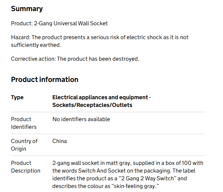

That's hilarious clickbait. What's being ordered for destruction is a certain brand and specific type and colour of 2 gang sockets with switches that were made in China. It's one of DOZENS of product safety recalls that happens regularly. That eFixx fella certainly knows how to draw people in You have to scroll some way down before finding it and blink and you'll miss it. https://www.gov.uk/product-safety-alerts-reports-recalls It's this one ICYMI https://www.gov.uk/product-safety-alerts-reports-recalls/product-safety-report-2-gang-universal-wall-socket-2604-0061
