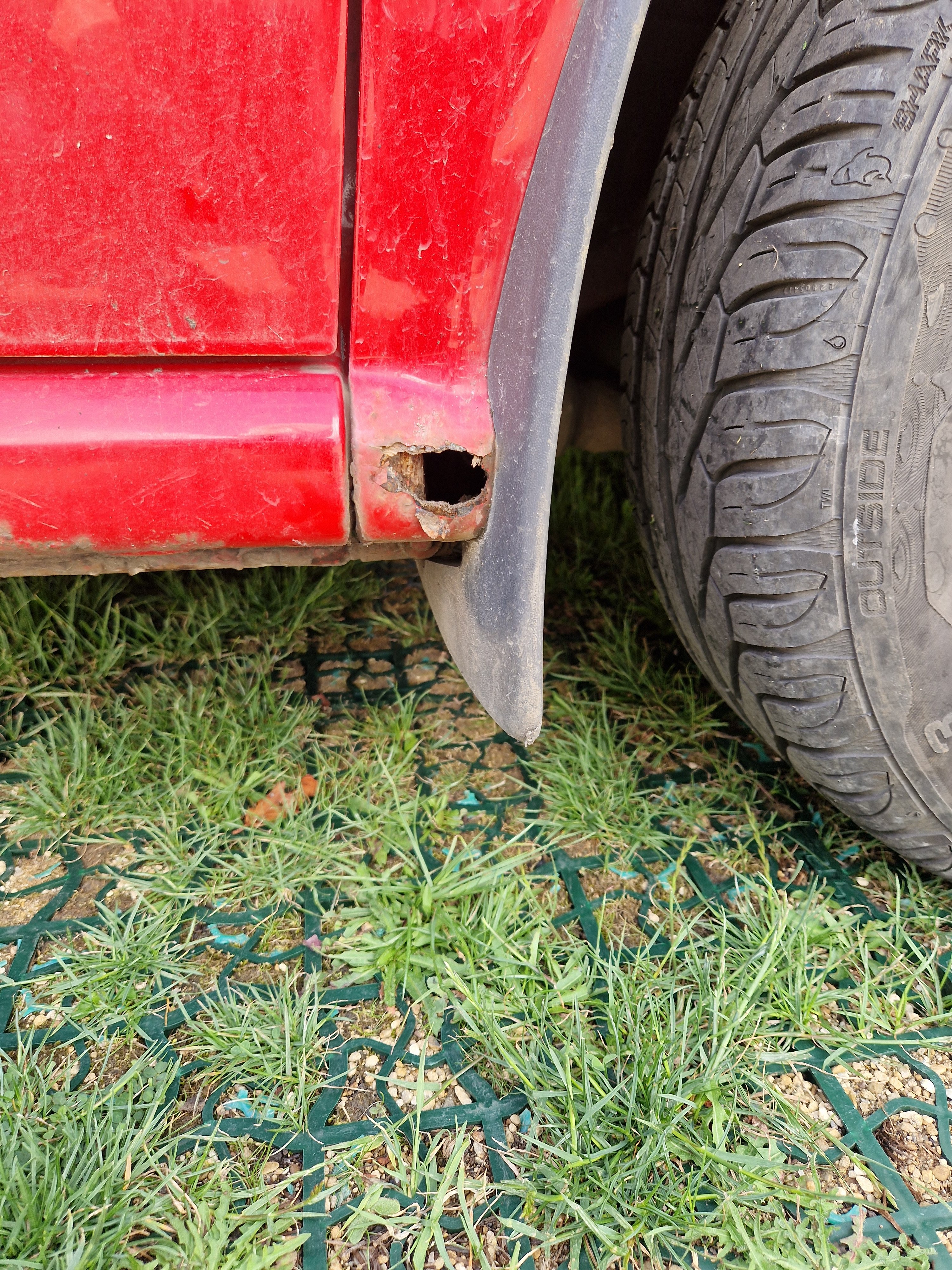

I had to have a hole welded a couple of years back. Rear of sill is close to mounting of rear beam. This (actually part of front wing) has been slowly worsening for a while. Went through MOT a few weeks back without mention. š

When I did this on my old Nova I just used silver Hammerite... It lasted well

Yeah it was just to seal it more than anything else. It seems to have done alright, I do it every 2 years or so in various places. It's still very solid though - and ready for me to get it sold now. The red one has been in Scotland since new, and that's not a good climate.

Problem with the stone chip guard it gets brittle and cracks with age then moisture gets trapped underneath. If the rest is solid I would leave it alone. Alasdair
