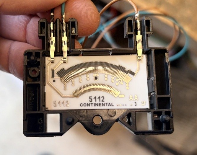

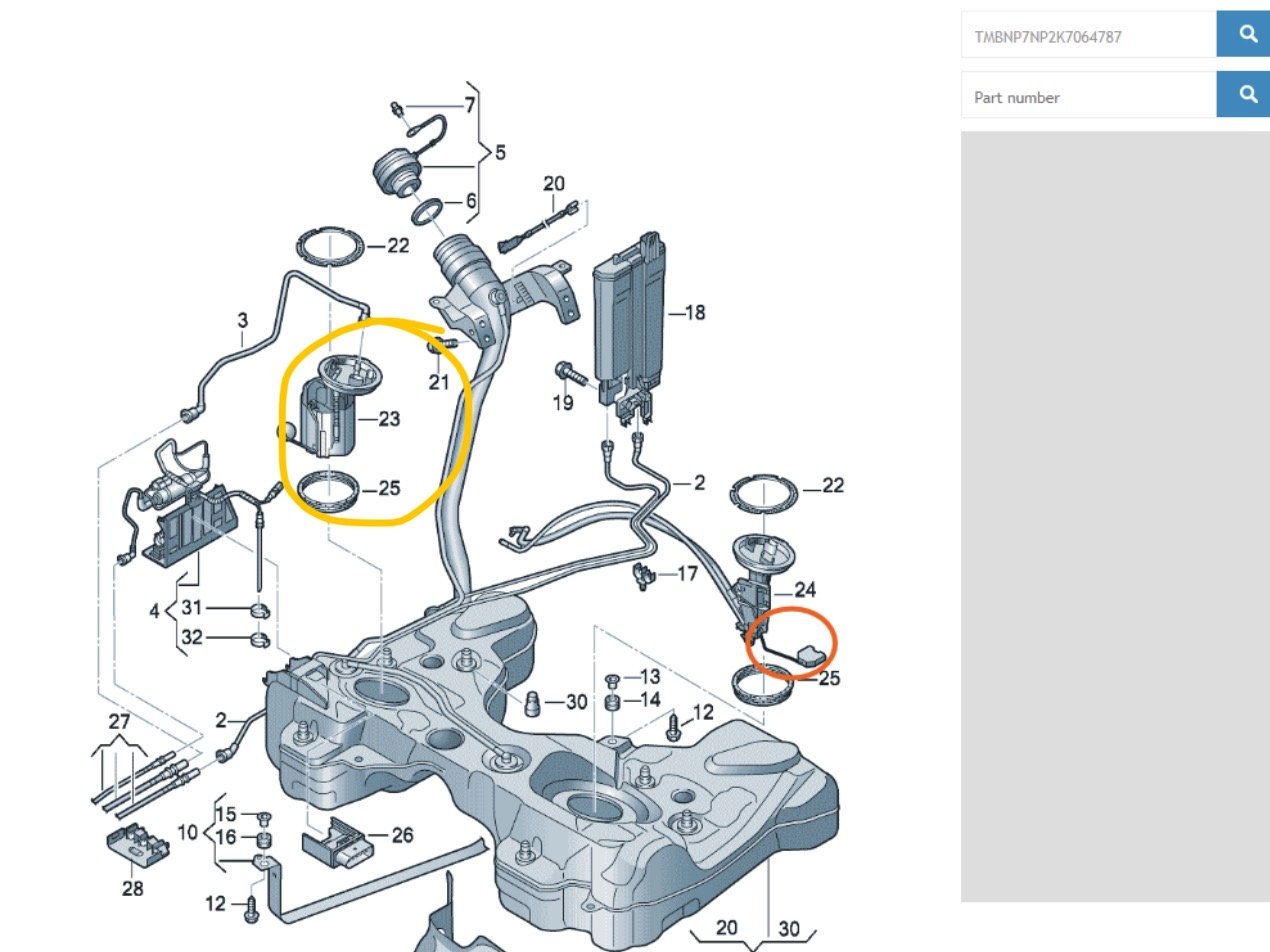

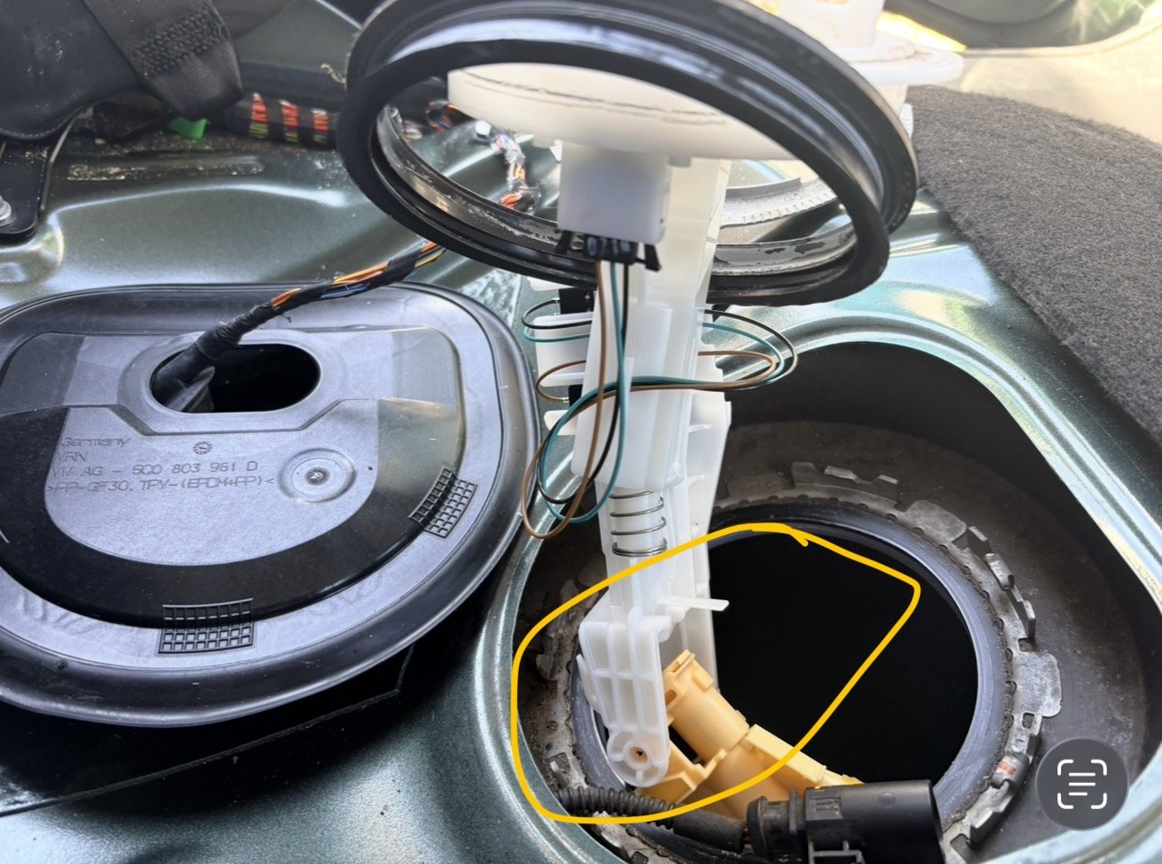

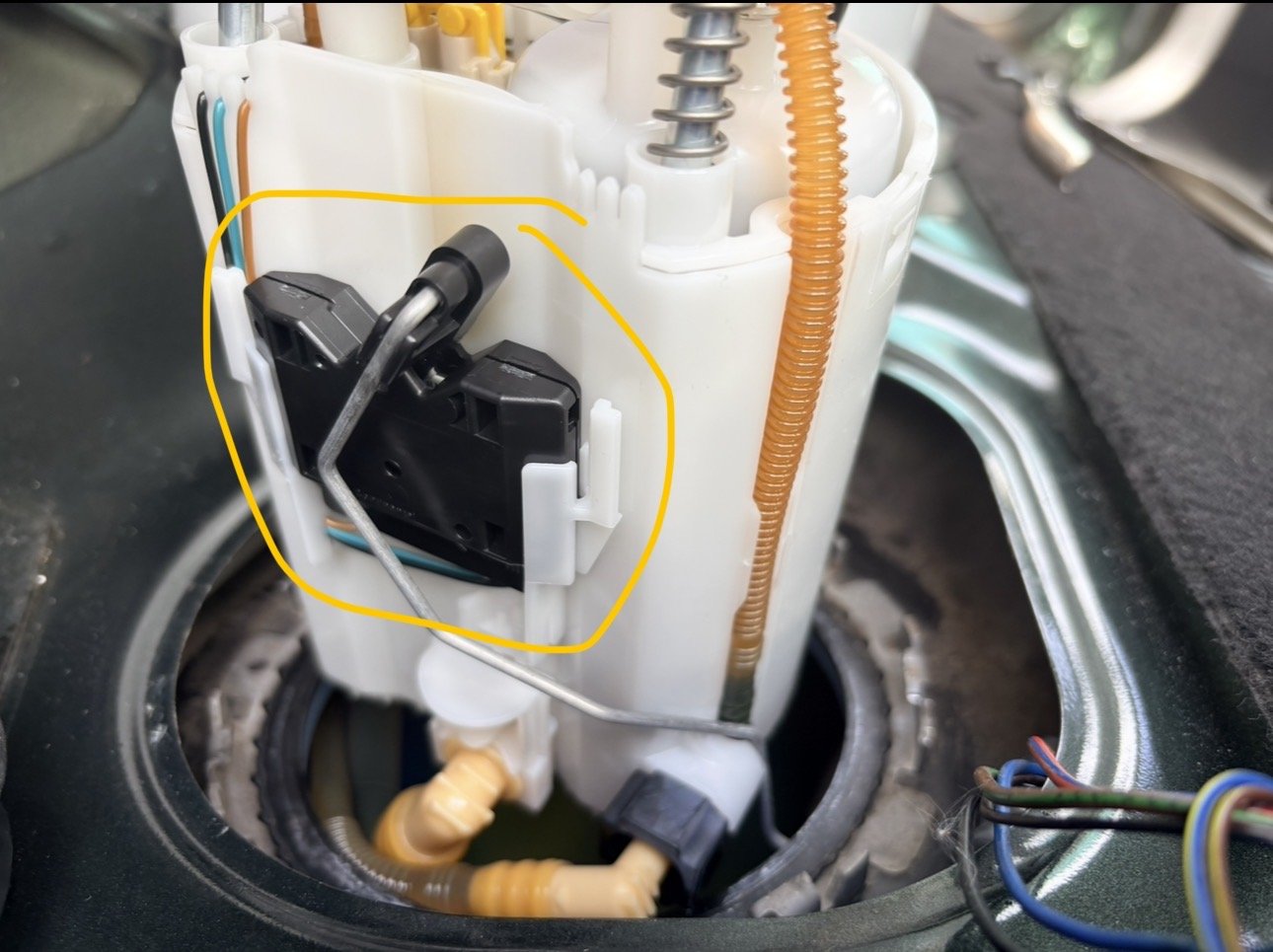

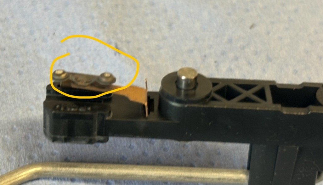

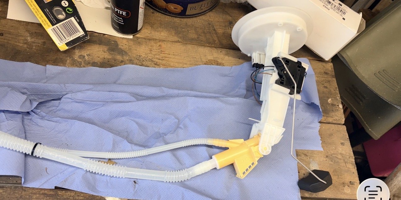

In case anyone is interested in how this was resolved. I read that on the 4x4 saddle tank the secondary pickup on the LHS drains the left side of the fuel tank first, once that’s empty it drains the RHS. LHS is just a pickup & a float sensor while the RHS has a pump and another float sensor. The tank was only registering a drop in level after about 200 miles indicating it was the LHS that was at fault. So after a couple of false starts I sourced the correct parts. I got the RHS float sensor from Skoda for about £110, part number 3Q0-919-673-K, I figured I may as well change it at the same time. I could only get the whole LHS assembly, I picked one up on eBay for £100, part number 3Q0-919-098-B I also invested in a fuel pump ring removal tool which made life a lot easier than using a chisel to get the pumps out. LHS side first, I popped the pickup unit out and just unclipped the whole thing from the hose and replaced it with the new one. On the other side I just unclipped the float sensor, popped it out and replaced it making sure the wires were rerouted the same way. On opening up the suspect float sensor the pickups were very worn and was showing intermittent resistance so definitely where the fault was coming from. On the plus side the fuel gauge appears to be working properly again.
