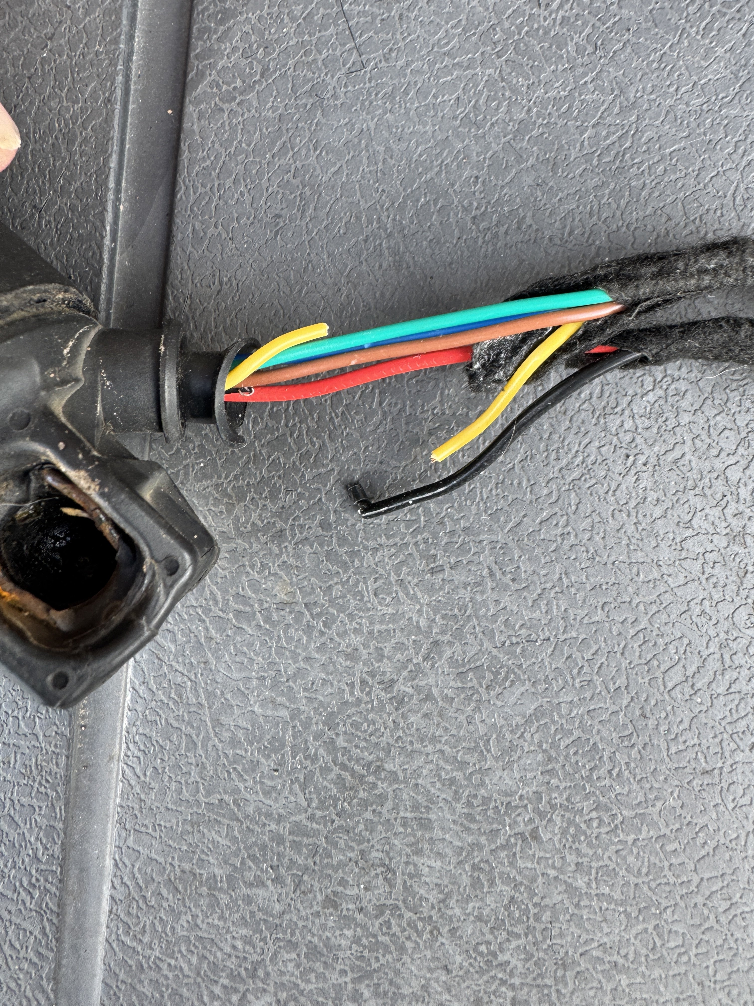

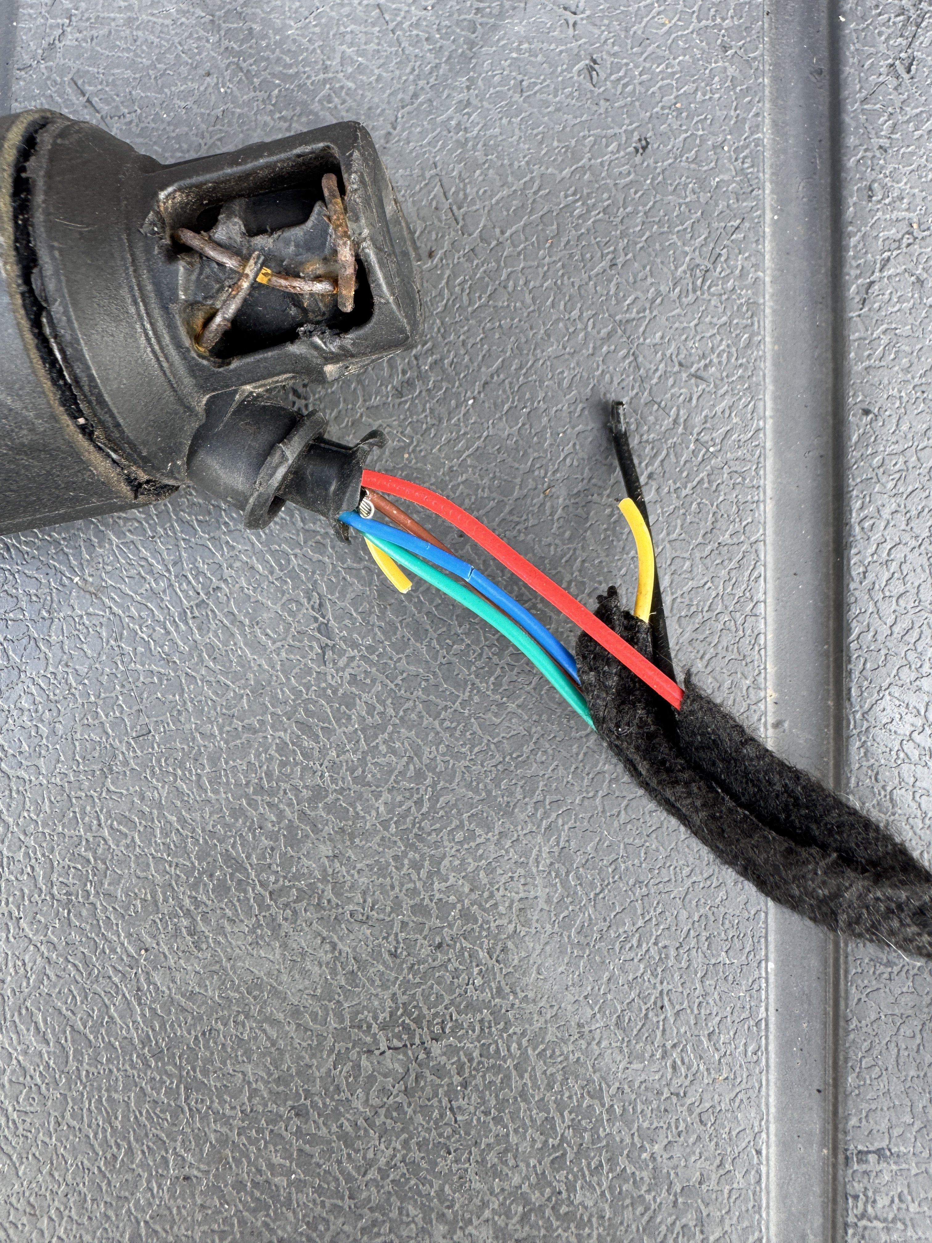

  3. Bought the ones on the link below. Was a voucher off them last week. Att photo of the damaged wires below. Probably an easy fix but don’t have any soldering equipment, or skill! https://ebay.io/m/mo0nOh
  4. So the OEM ones I ordered never came through off eBay so just bought some generic ones from There. About £45 for one. Very easy job to swap old one out and this one in. Did panic that I hadn’t disconnected the battery first in case it messed with the programming but think as one still connected it was fine. Now works like a charm. Inspecting the old one you can see at least 2 of the wires had snapped due to the play in that junction. In hindsight probably could have connected them again but felt they would be weak still. If you pull back the rubber grommet attaching ti the metal Body you should see if any issues on these wires
