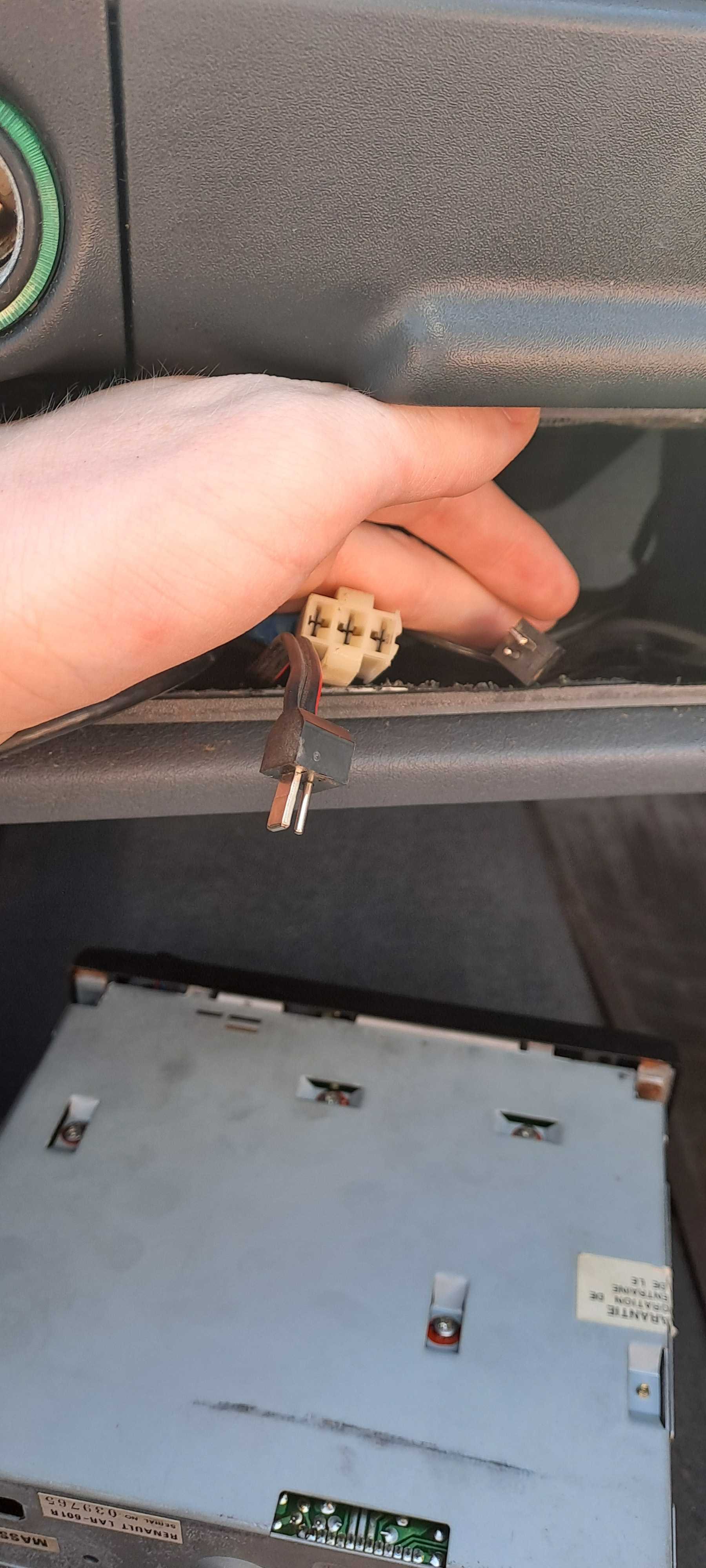

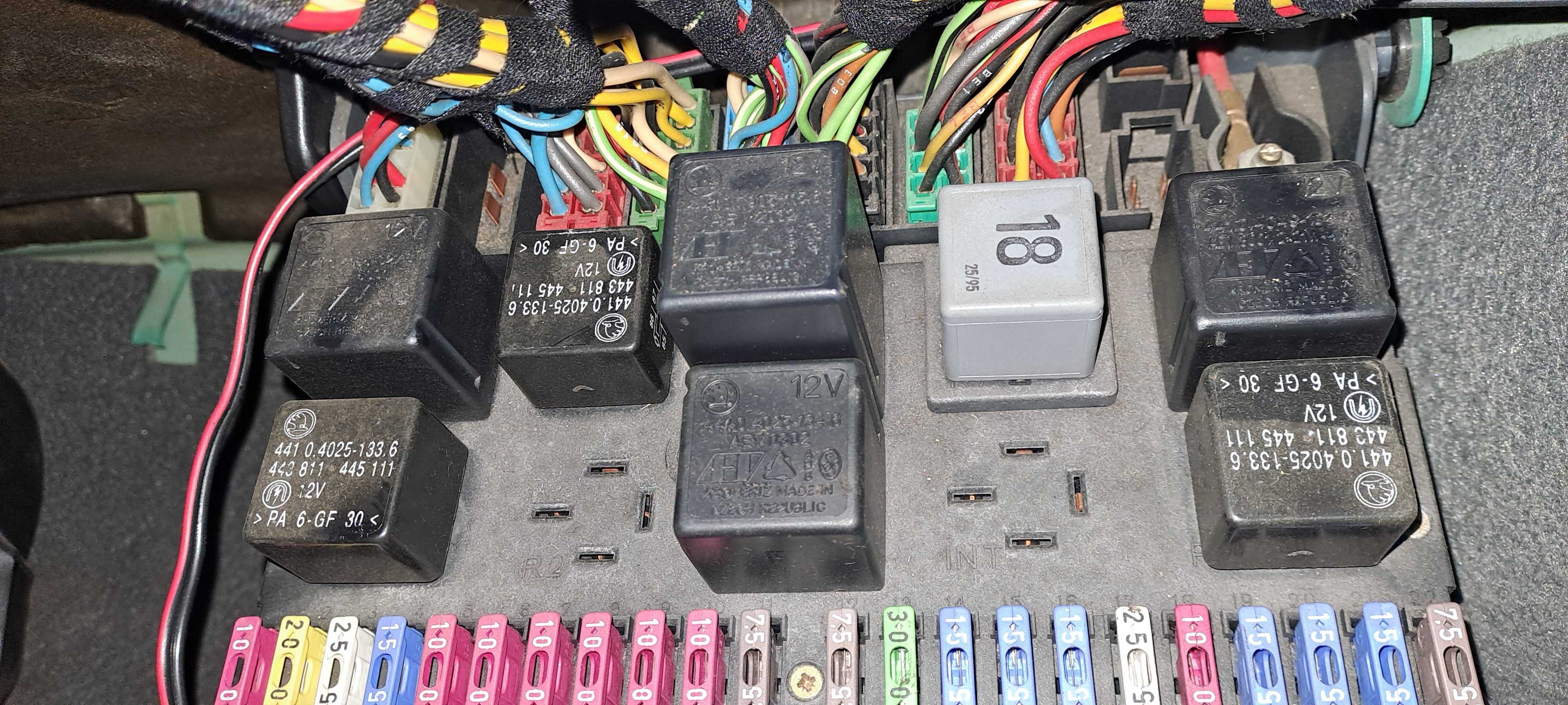

Hey, recently i bought a skoda felicia I break Super I, i have a 68 horsepower engine and i was trying to find how to connect a new radio on the car but i ran into a big problem firstly i how prevously a skoda felicia II but i don't think that the same interior harnesses for most part, but i remeber it was not like ont mine, i cannot connect a new radio on the plug i have on the car, i try to find an adaptator but no chance all of them are not compatible with my plug, so i need a little help, i know on some car the radio harnesses is connected on the cigars lighter on the fusebox but for me i don't find any form of document explaining all the connection of the fusebox, and i don't want to break my car on the fisrt month of ownership, So if you know how i can connect a knew type of radio harnesses i would realy value the help. oh and BTW the car is from 1995, and hasn't change radio i also send a picture of the fuse box if needed. Edit. the radio can be turn on even if the key is not on the ignition, so i know for sure i have a direct connection between radio and battery
